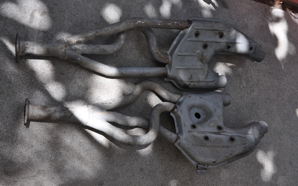

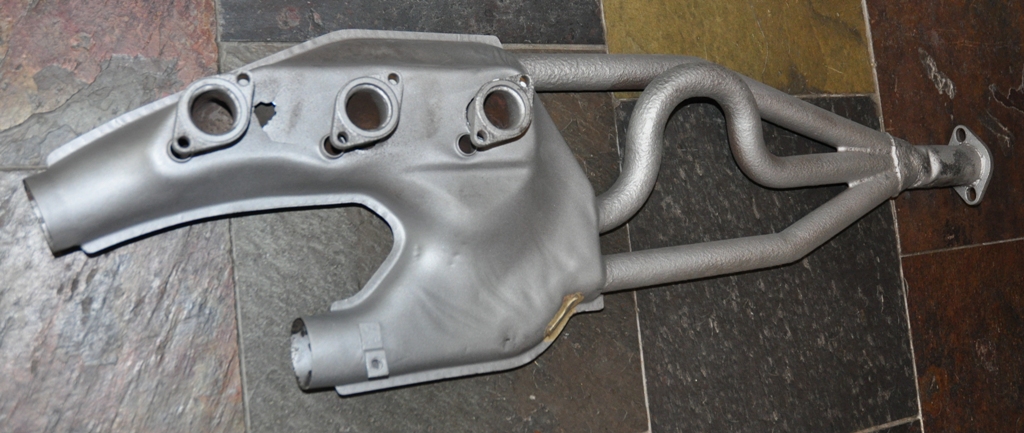

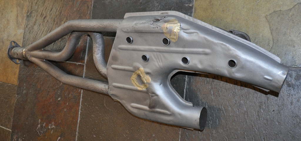

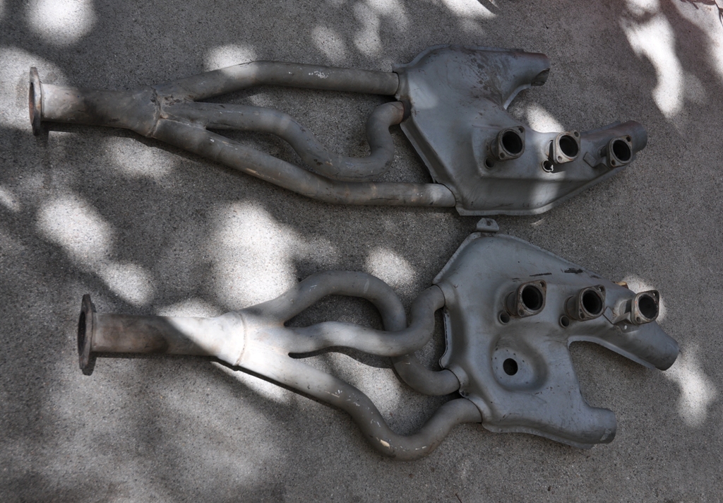

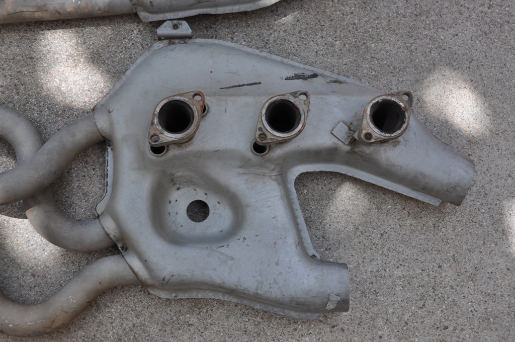

Well I found an amazing set of heat exchangers after buying a few plus the set that came with the car. First pics is what came with the car and will be selling off. Repairable but rough with prior patch work

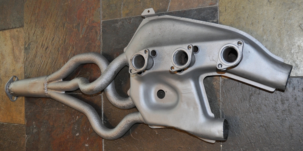

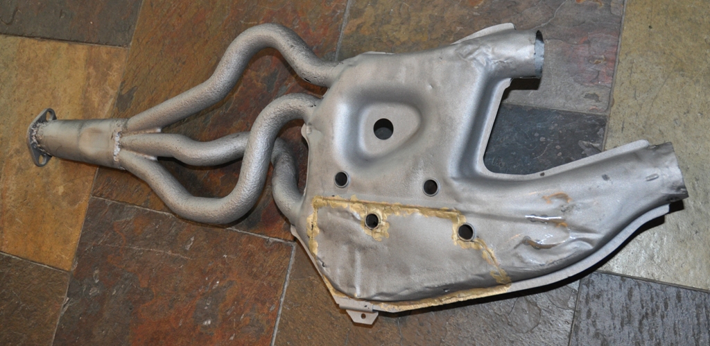

Now for the new err set. I'm thinking of having them ceramic coated to protect them (IMG:style_emoticons/default/idea.gif) anyone done it or have a better option? Thks

... Do they have to split the clam shells to blast prior to ceramic coat?

Might check with Marty at MSDS about who he uses for coating.
Good score on the exchangers, wish I knew of a good set, so I just went with headers

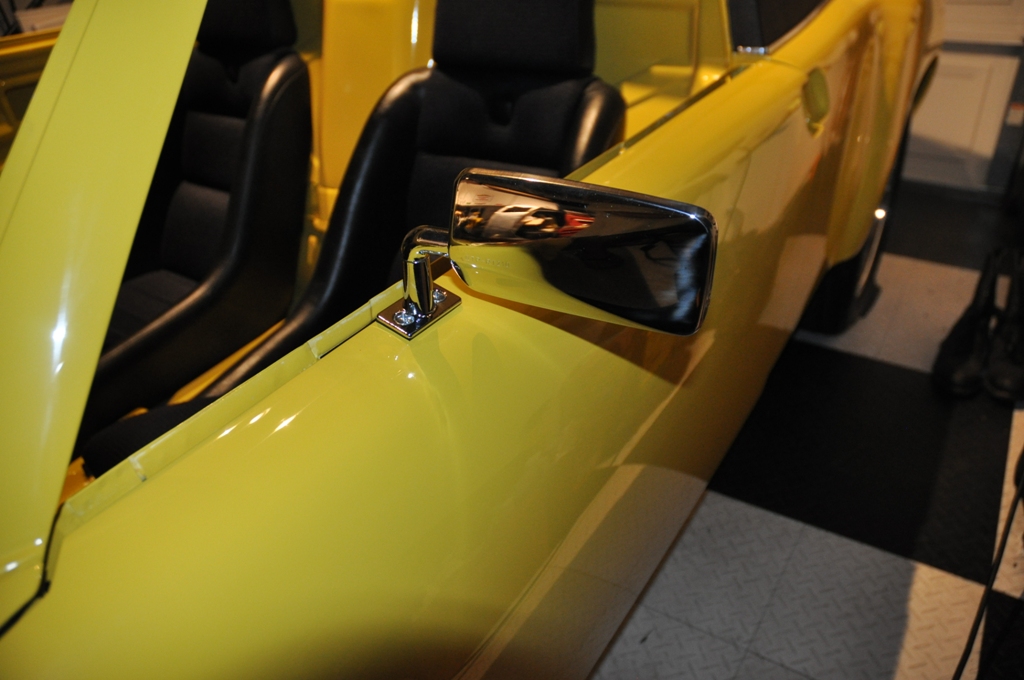

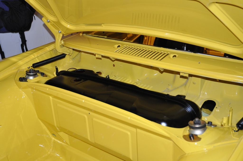

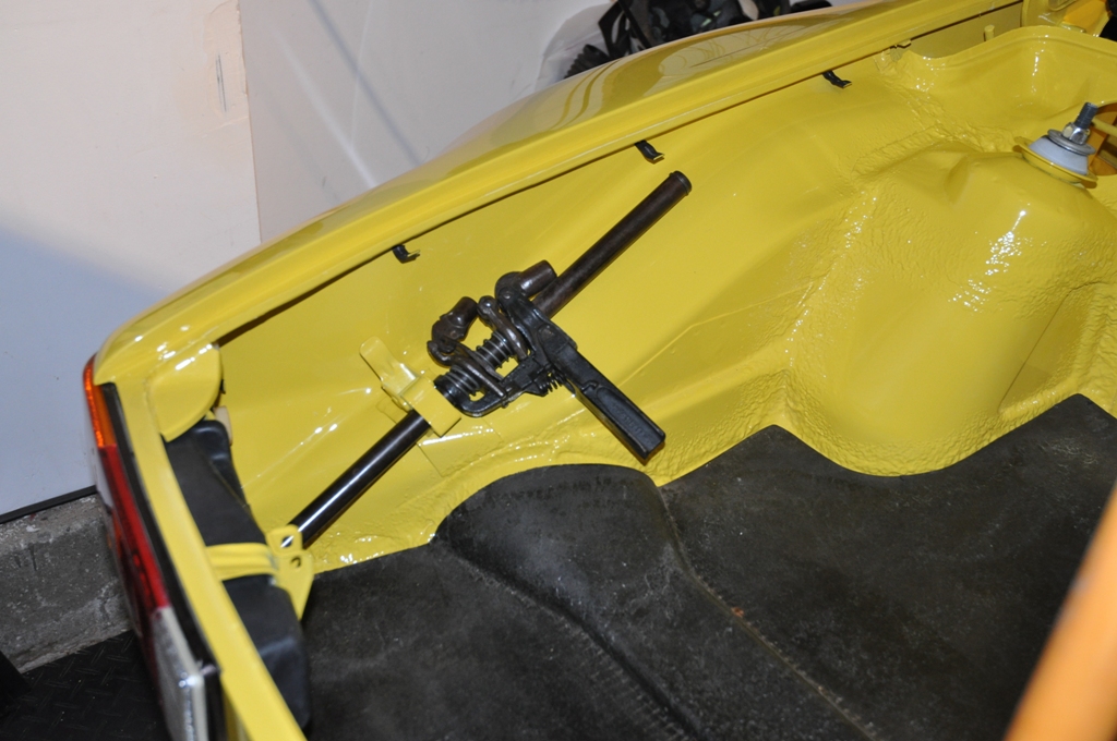

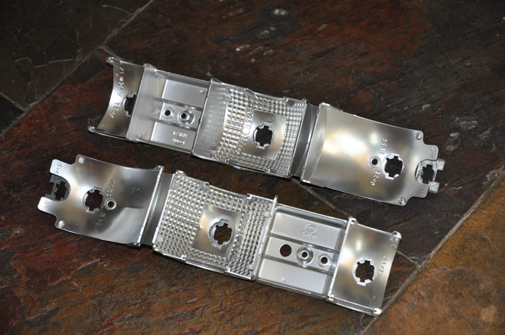

Took a break from the harness repair and worked on the light buckets. I'm going to try and wrap up the harness tomorrow and start feeding it in.

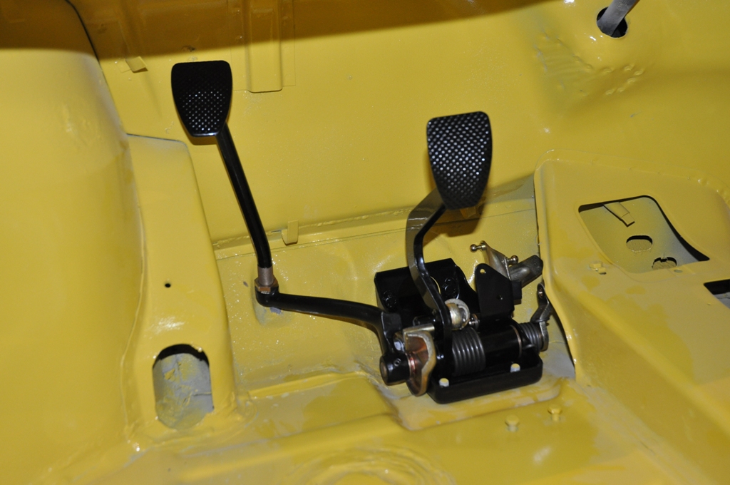

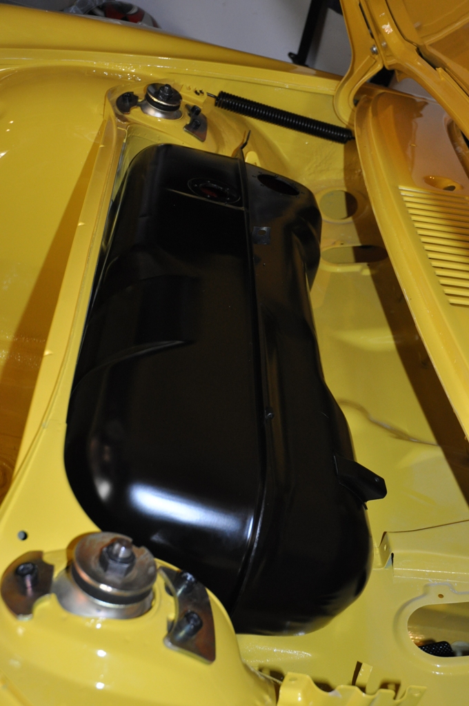

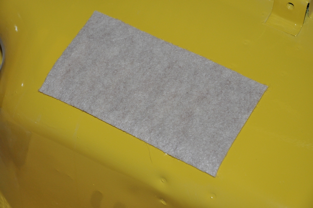

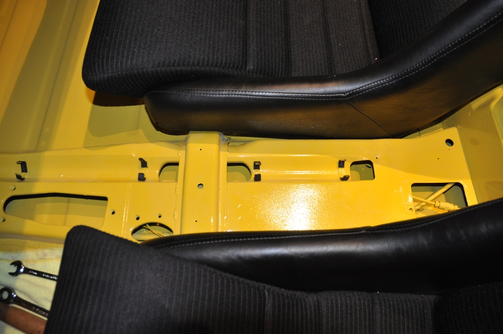

Also Got the gas tank painted today and made some felt pads. Fitted pedals (IMG:style_emoticons/default/biggrin.gif) Thanks Bruce!!!

When I found some used heat exchangers that looked about like yours, I did have Jet-Hot coat them, and it has head up quite well. They did sandblast them, and found another few little spots where the outer envelopes were getting thin, but were able to get them patched before coating them. Didn't have to split the outer envelopes to get the coating done.
However, given their age, even though they look great, I do carry a CO detector in the storage bin under the dash just in case.

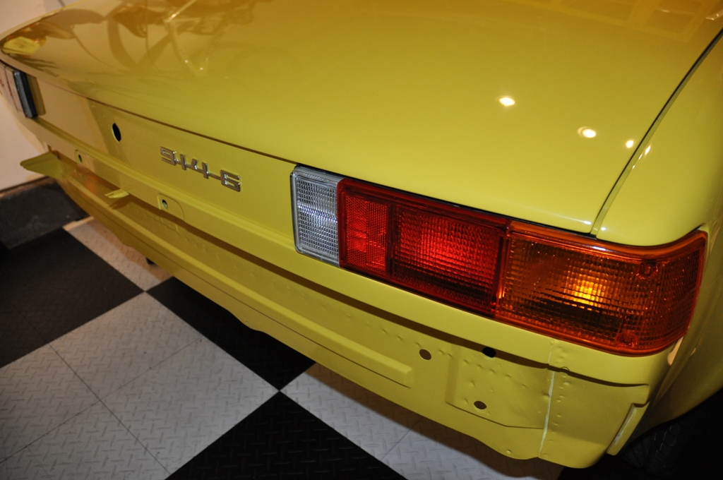

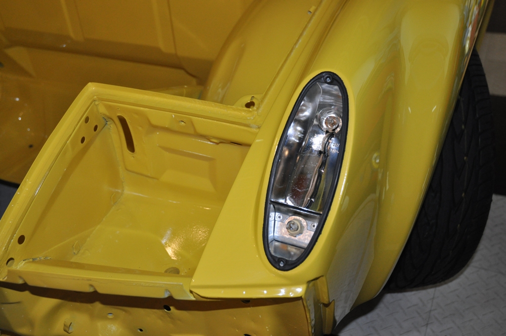

Got a few more things done today. Disassembled rear turn signal buckets, cleaned and on, installed mirrors and shrink rapped all the wire harness support tabs.
