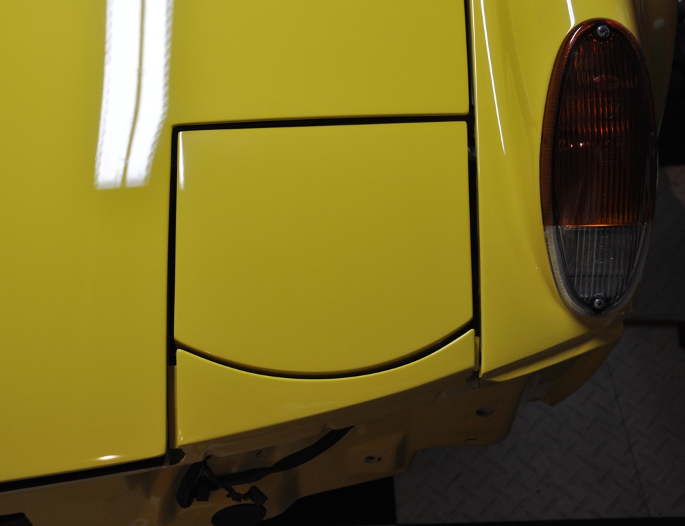

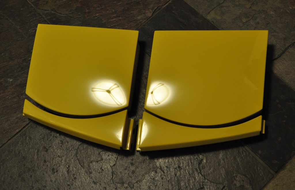

Freshly color sanded and polished. These take lots of fiddling to get adjusted. need to lower the front latch a bit and done on the drivers side.

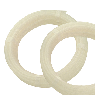

The tubing is Nylon 6 and a milky white, not clear. It jus looks somewhat clear with fluid in it. Look for it at places like McMaster Carr.

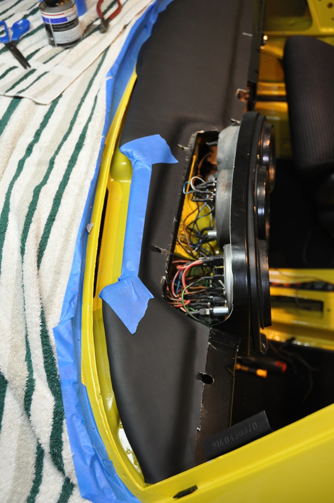

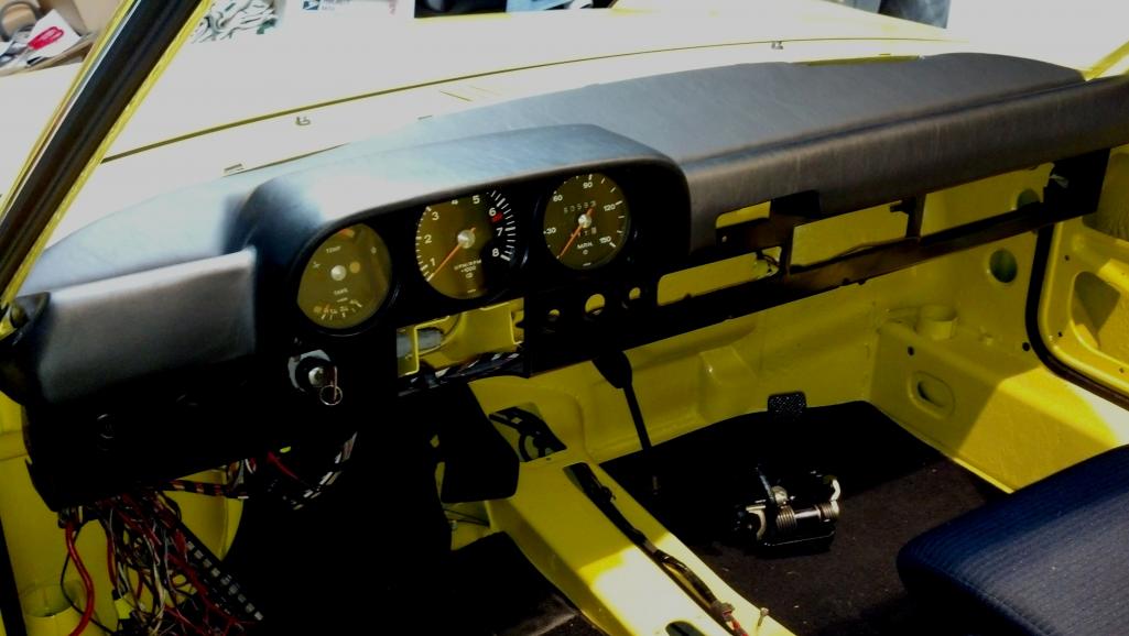

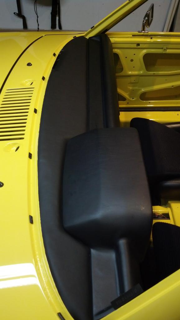

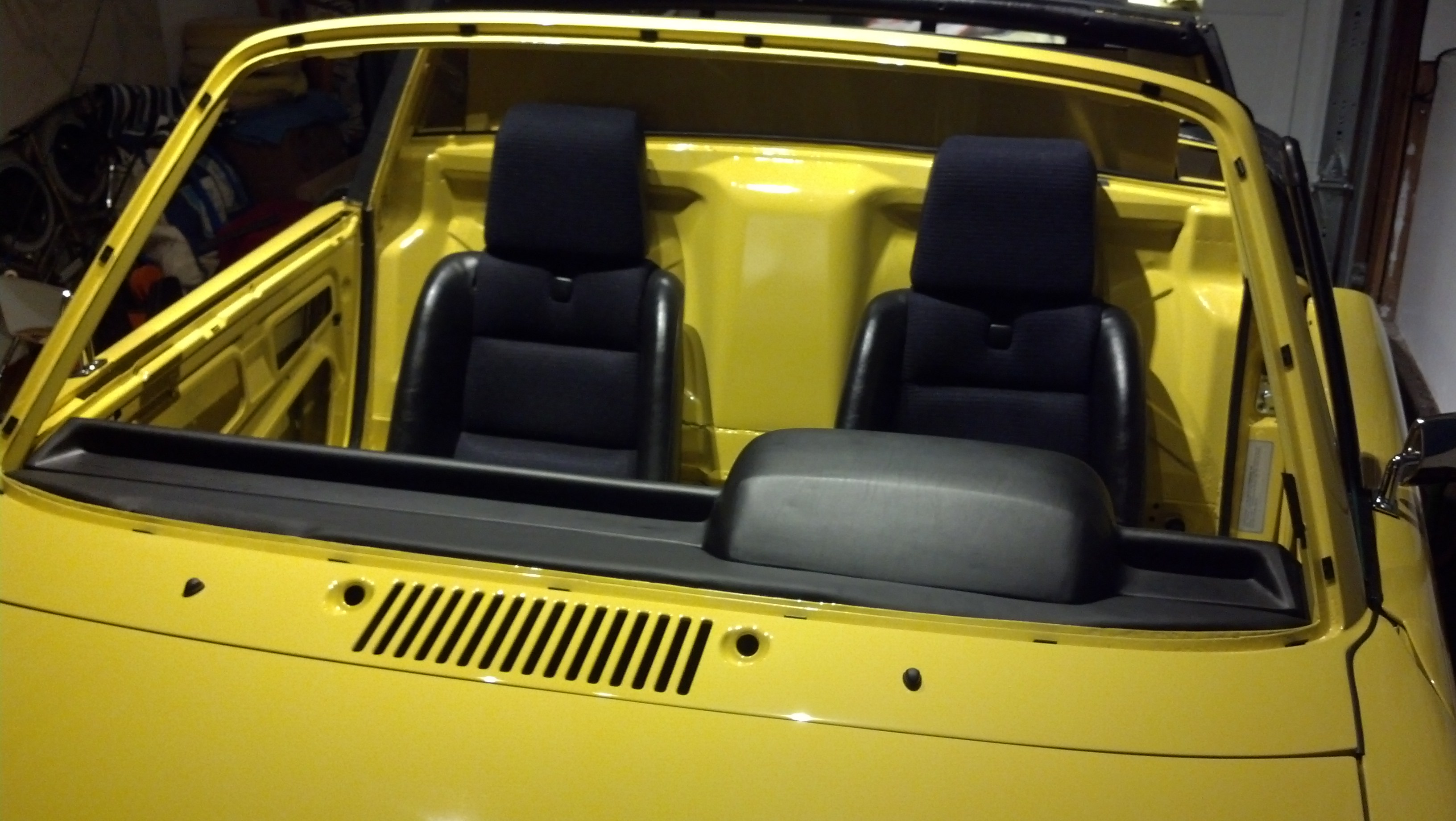

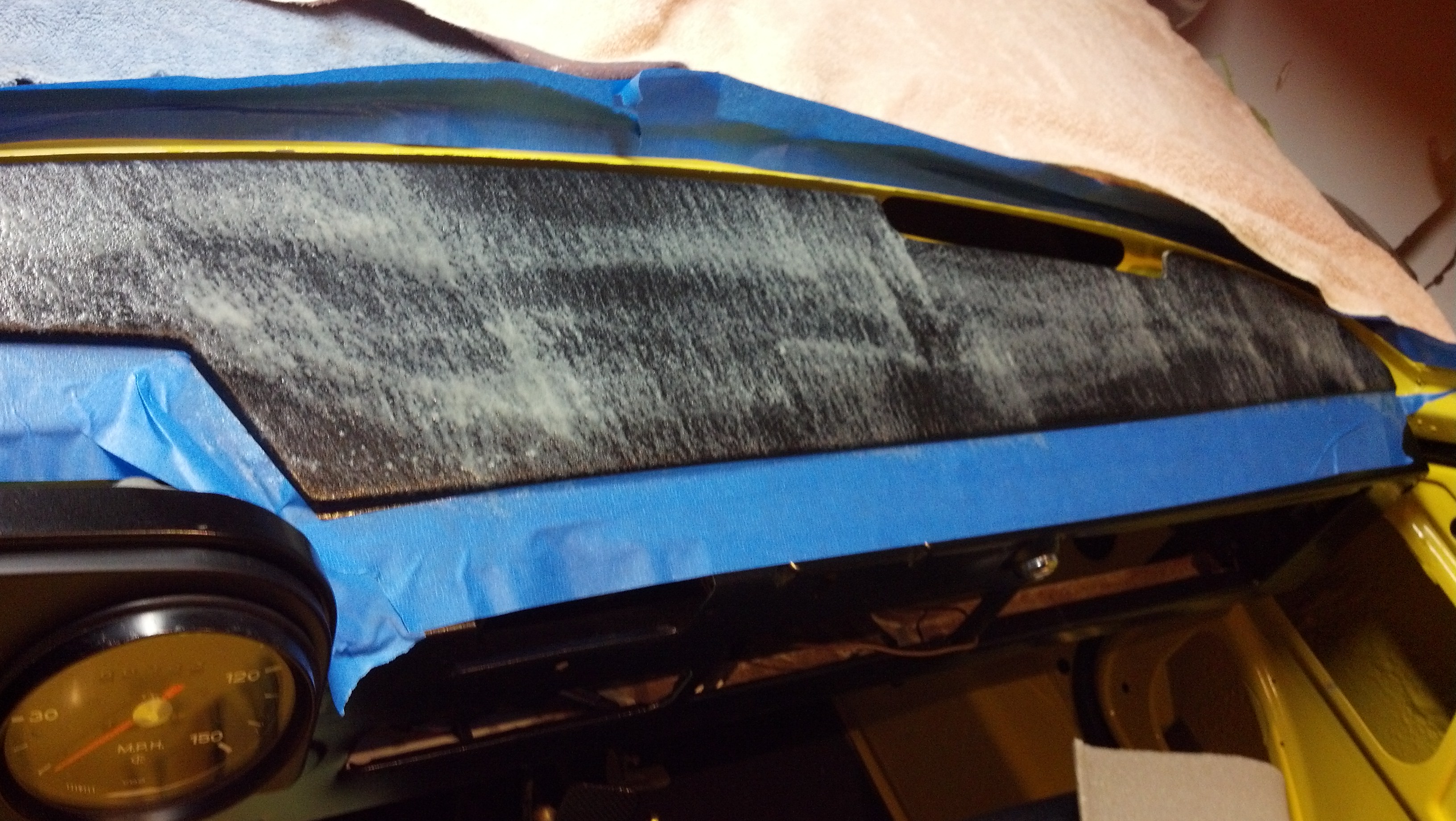

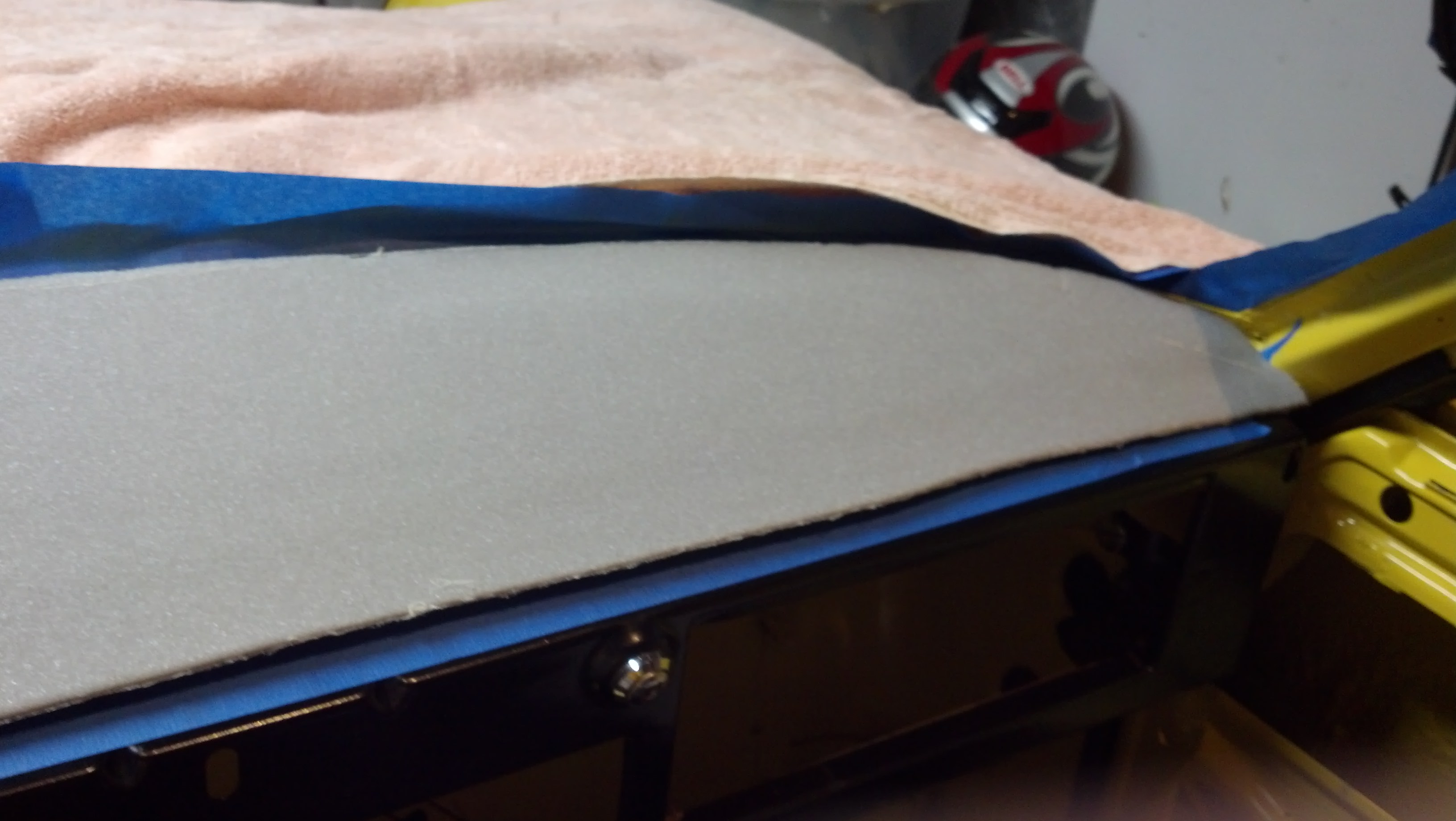

Another week toast with being on call (IMG:style_emoticons/default/mad.gif) and RRC is looking grim at this point but I'm still trying. Got the upper dash vinyl done and the dash out of the box and on the car. Still need to stretch and glue the leading edge and around the defrost vents.

I found the Nylon6 tubing for the brake fluid res. and had to buy a 100' roll so I will puts some kits together with the blue hose and start a WTB thread when it gets here for those interested (IMG:style_emoticons/default/biggrin.gif)

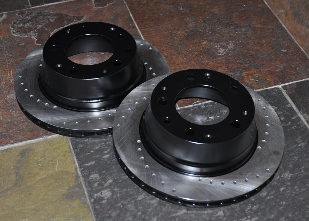

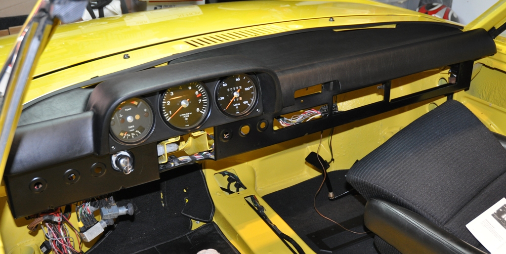

So not a lot of progress pics but huge progress under the dash and lights/guages Thanks to some much needed help Ron "SLITS " and Glenn From Pelican!!! we wrapped up the electrical checking every wire and testing continuity on Sat. Thanks Guys (IMG:style_emoticons/default/pray.gif)

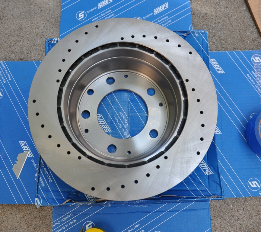

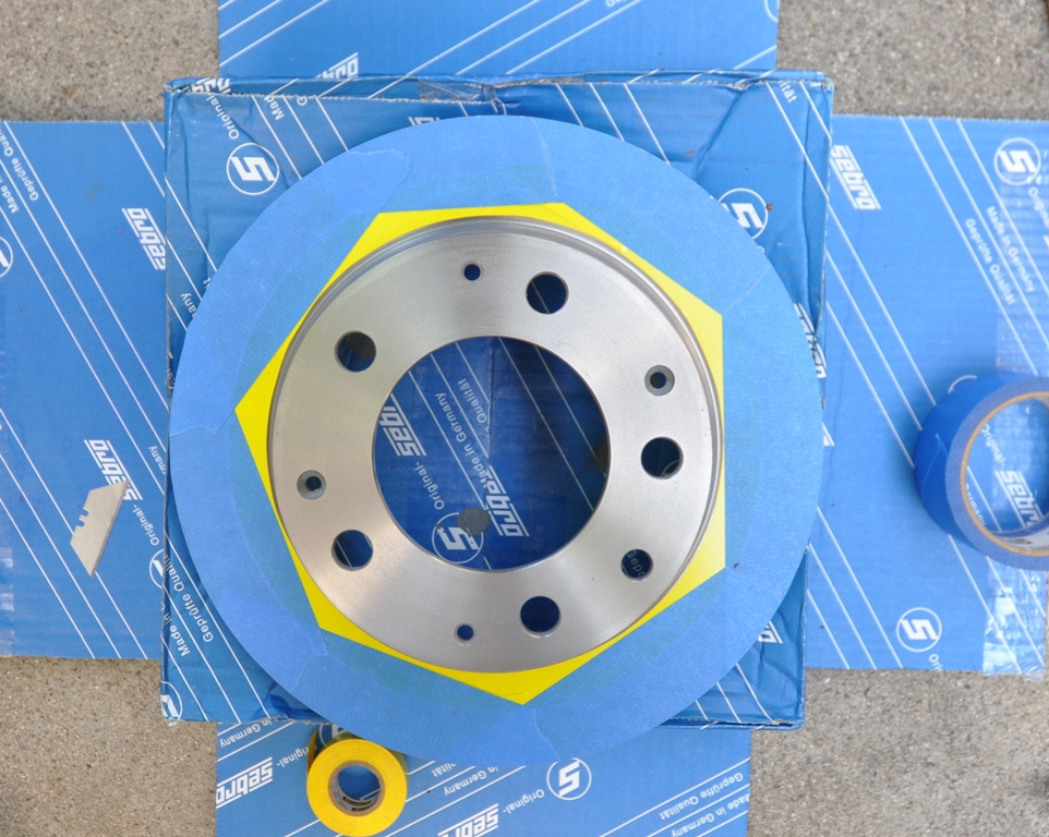

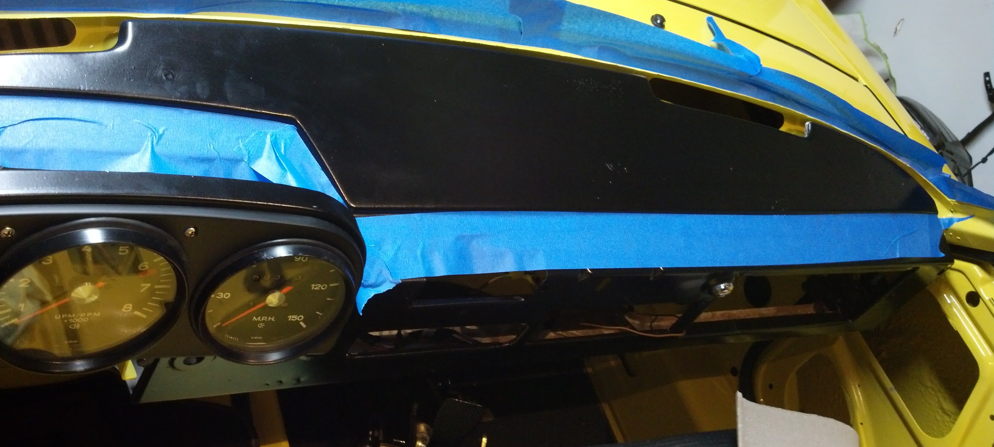

Today I finish the leading edge tuck on the dash vinyl and bolted it in. A little brake rotor painting , hung the oil lines. wiper assembly and Yes Erc... Started blocking out my fiberglass bumpers from Getty Design so they can be painted along with the rockers next week. Thanks for the rotors PMB
Still a lot to do (IMG:style_emoticons/default/smash.gif)

Andy, what paint did you use on your rotors?

QUOTE(sbsix @ Aug 5 2013, 08:38 AM) *
VHT 1850 deg. header paint
