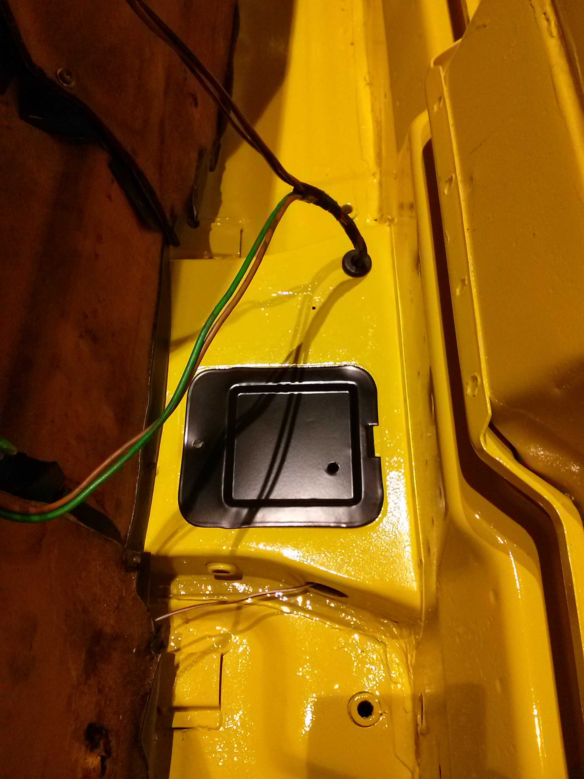

Hey, could you back up a bit and show where you are putting the fuel pump?
I can't make out the location.....
Rich
Thanks Guy's,
pump is just below the pass. side headlight bucket.
Jeff Hines answered the mystery wire issue. I don't want a visit from Mr. Sparky or his pal Smoke
Got it.
Based upon experience, I would strongly suggest you either don't put fuel lines and pump in the front trunk, or build a cover for everything.
Once you start using the car, the front trunk is key to be able to stuff full.....and things rolling around and bumping into the fuel system is just not cool.
Just putting that on the table for you to consider.
Rich

Thanks Rich, Always good to think this stuff threw and I welcome other options that don't require cutting or having it somewhere hard to service.

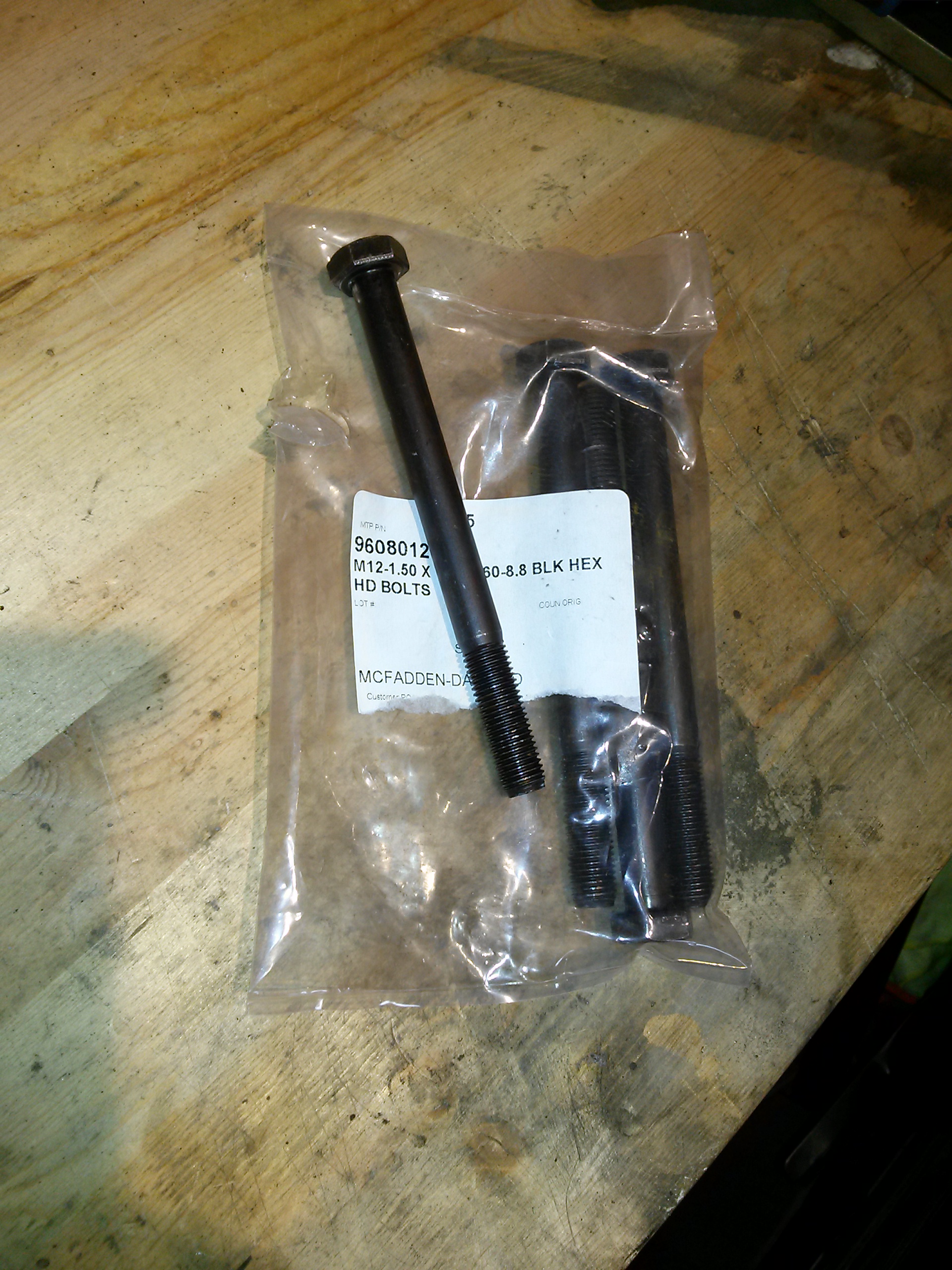

I had to special order the front mount bolt but had to order 5 so ping me if you need one. My cost was 9.75 ea. (IMG:style_emoticons/default/biggrin.gif)

QUOTE(Socalandy @ Feb 7 2014, 12:52 AM) *
Hmm, no cutting....
Underneath the tank, under the car, just above the steering rack.
Cover plate would protect it.
Similar to a 911.
Or
At the rear, mounted to the firewall, passenger side.
bigkensteele
post Feb 8 2014, 08:21 PM
Post #948
Major Member
Posts: 2,200
Joined: 30-August 04
From: Cincinnati, OH
Member No.: 2,660
QUOTE(r_towle @ Feb 8 2014, 04:27 PM) *
Similar to a 911.
This gets my vote. Under the tank is a PITA as hoses get kinked and pinched. Behind the steering rack is the perfect location - short, direct hose runs and easy to get to.

two more bolts remain.

QUOTE(bigkensteele @ Feb 8 2014, 09:21 PM) *
Similar to a 911.
Love this thread - keep up the awesome work, Andy! (IMG:style_emoticons/default/smilie_pokal.gif)
that's where I put mine - no sheet metal mods other than two mounting holes.

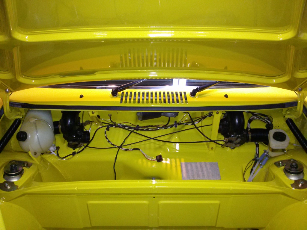

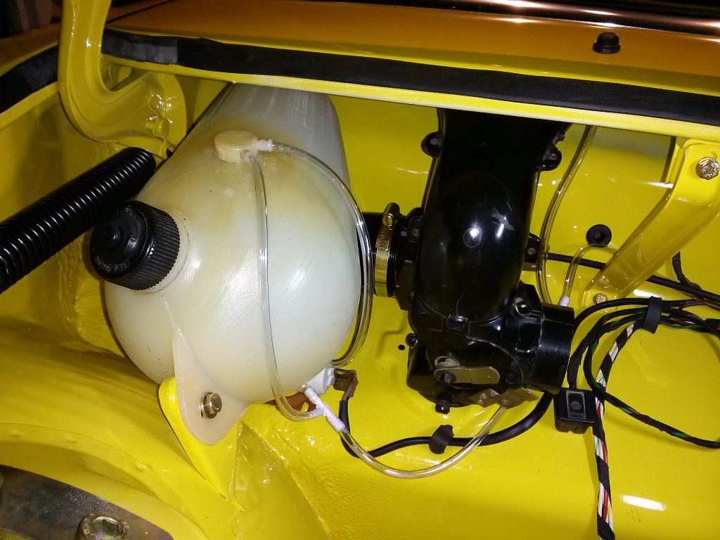

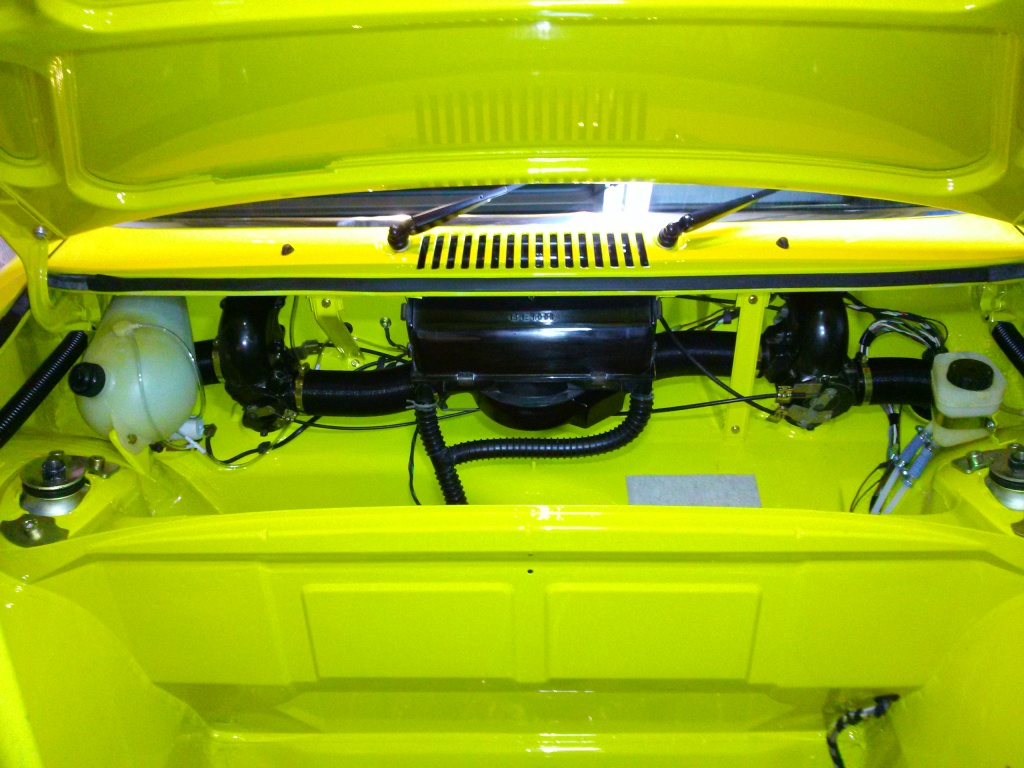

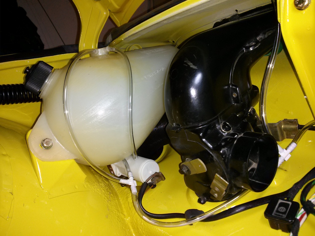

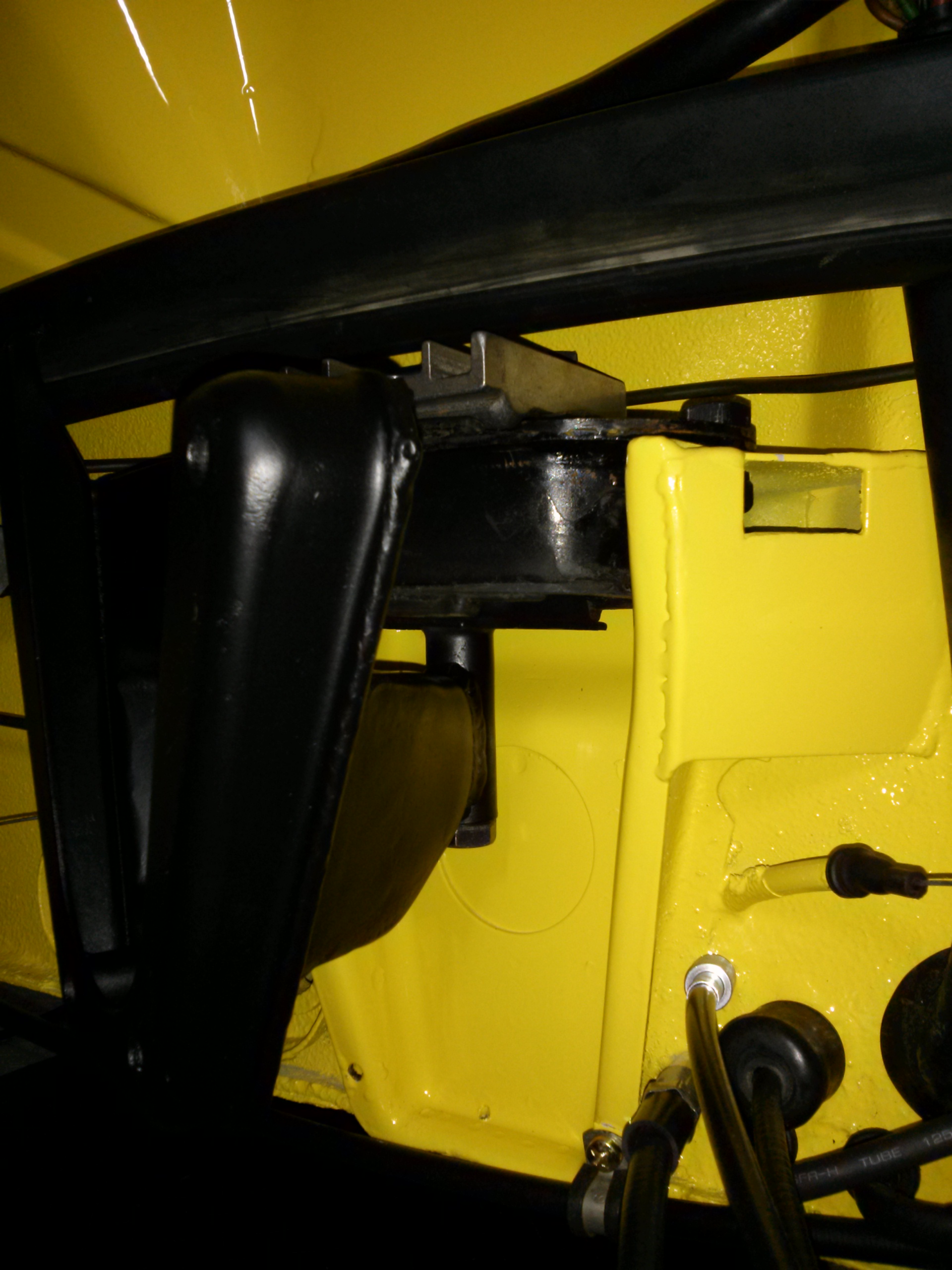

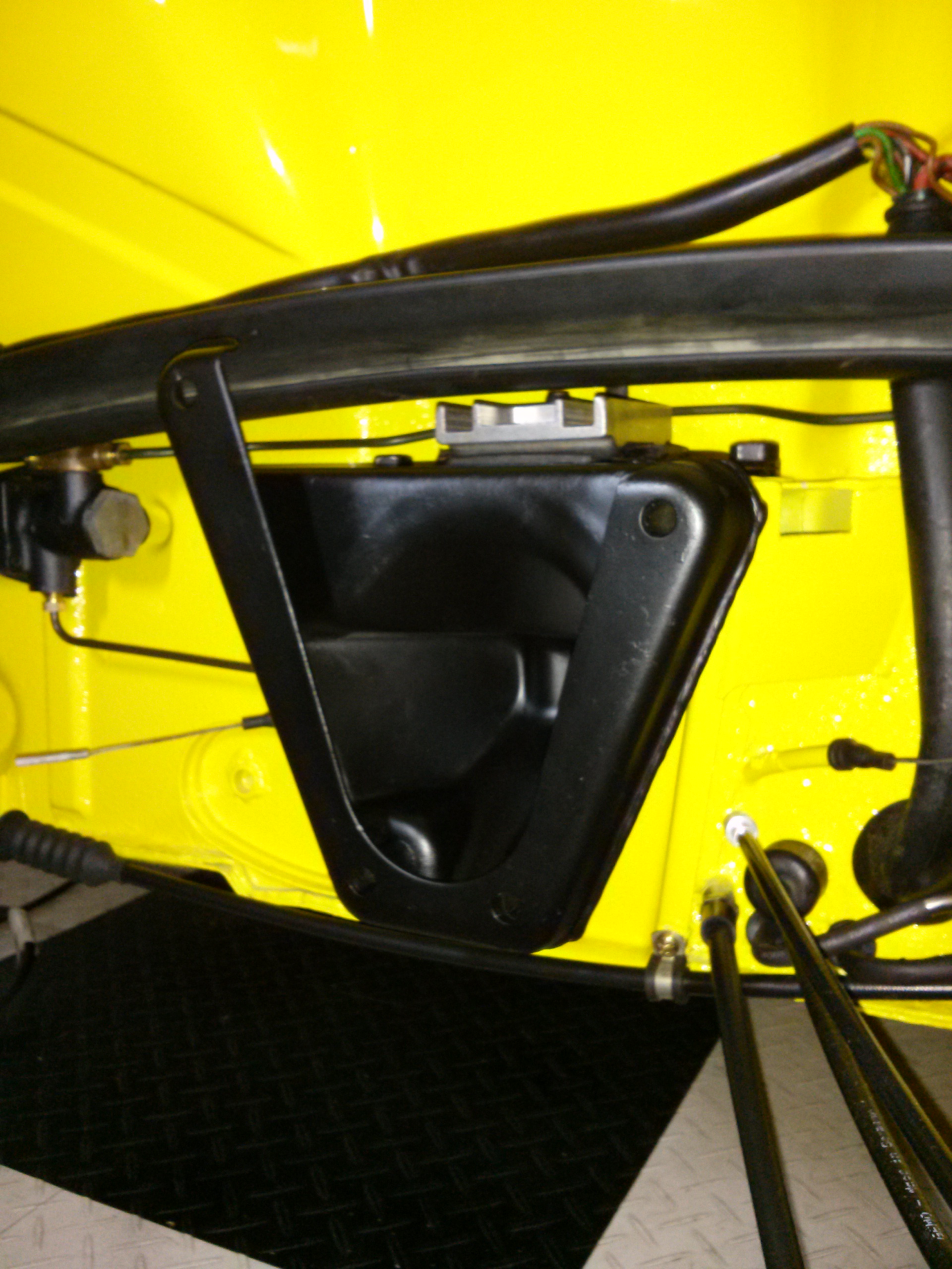

This weekend and tonight was the final wrap on the dreaded front trunk (IMG:style_emoticons/default/headbang.gif) I think the flapper box cables are in right (IMG:style_emoticons/default/wacko.gif) I also modified the late dash pad very carefully for the early dash/glove box area . I was able to shave away the foam underneath and the heat and glue the vinyl down into a nice radius to match the other side
bulitt
post Feb 11 2014, 01:56 AM
Post #952
Achtzylinder
Posts: 4,189
Joined: 2-October 11
Member No.: 13,632
This car should go to Pebble Beach! Except it wouldn't win because it's in far better condition than Porsche built it. Amazing. Re-badge it as "Andy 914"

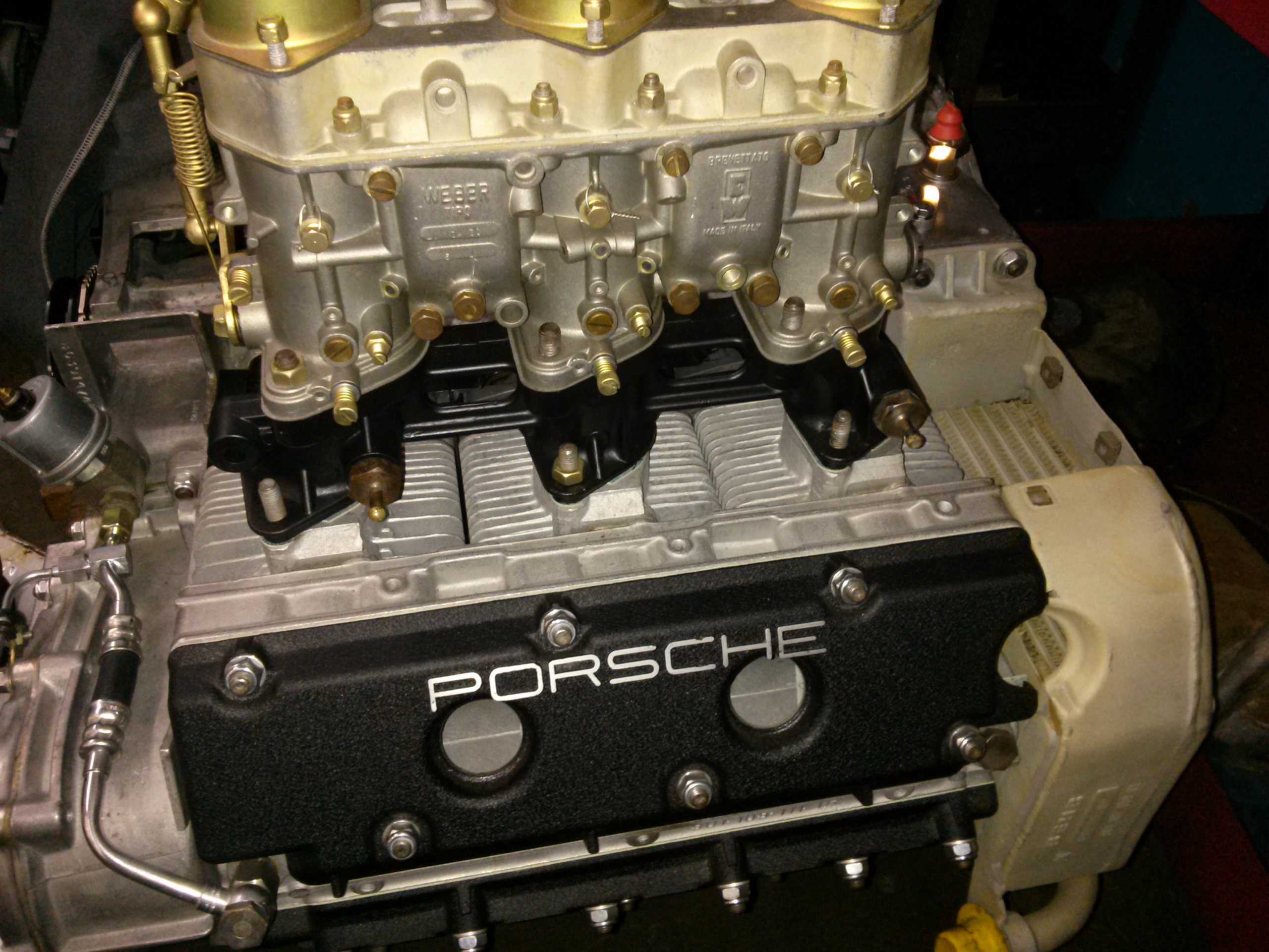

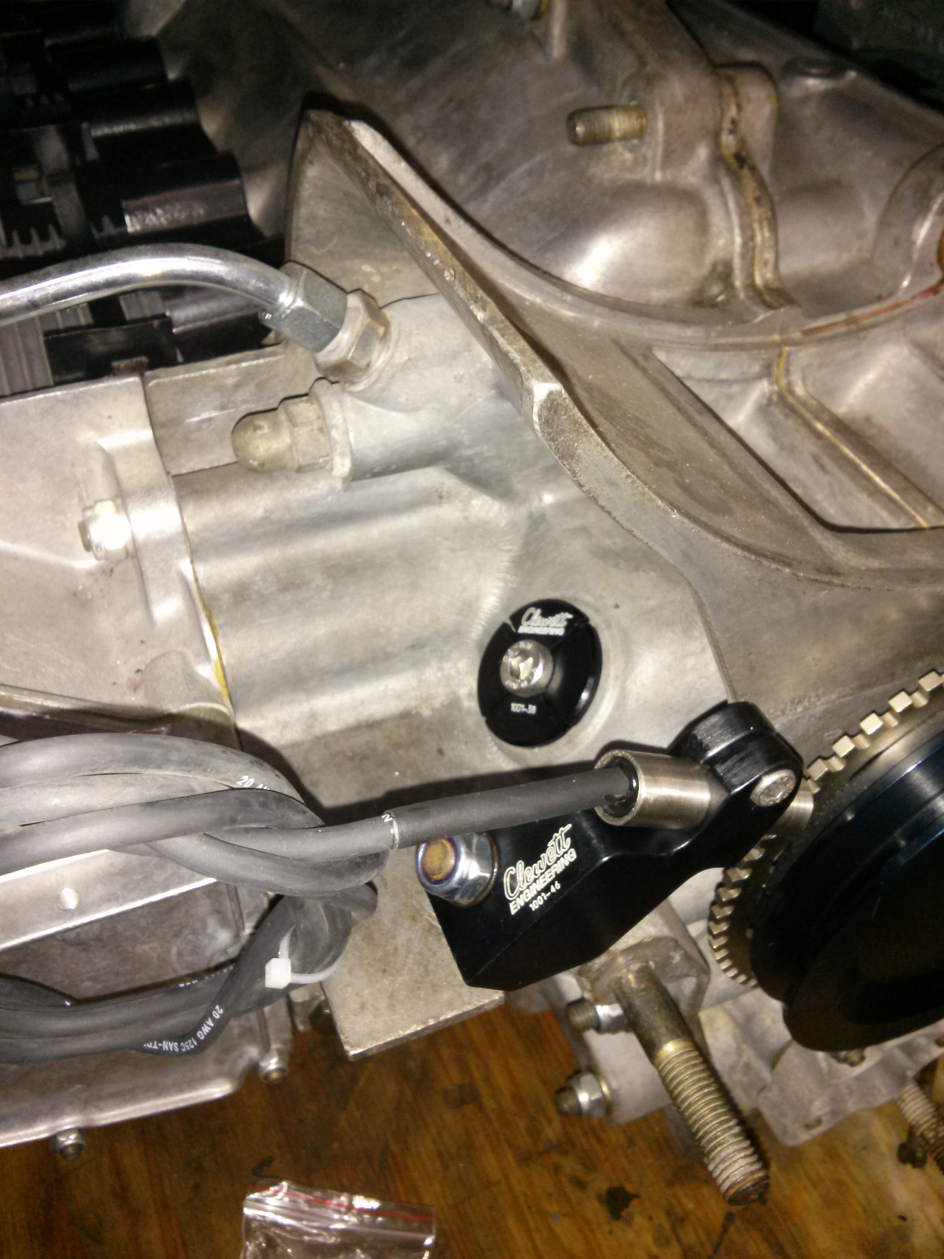

Lunch break dash, installed trigger wheel pickup sensor and set the gap, distributor plug, ported manifolds and working on the engine tins now. this thing goes hot next week (IMG:style_emoticons/default/piratenanner.gif)

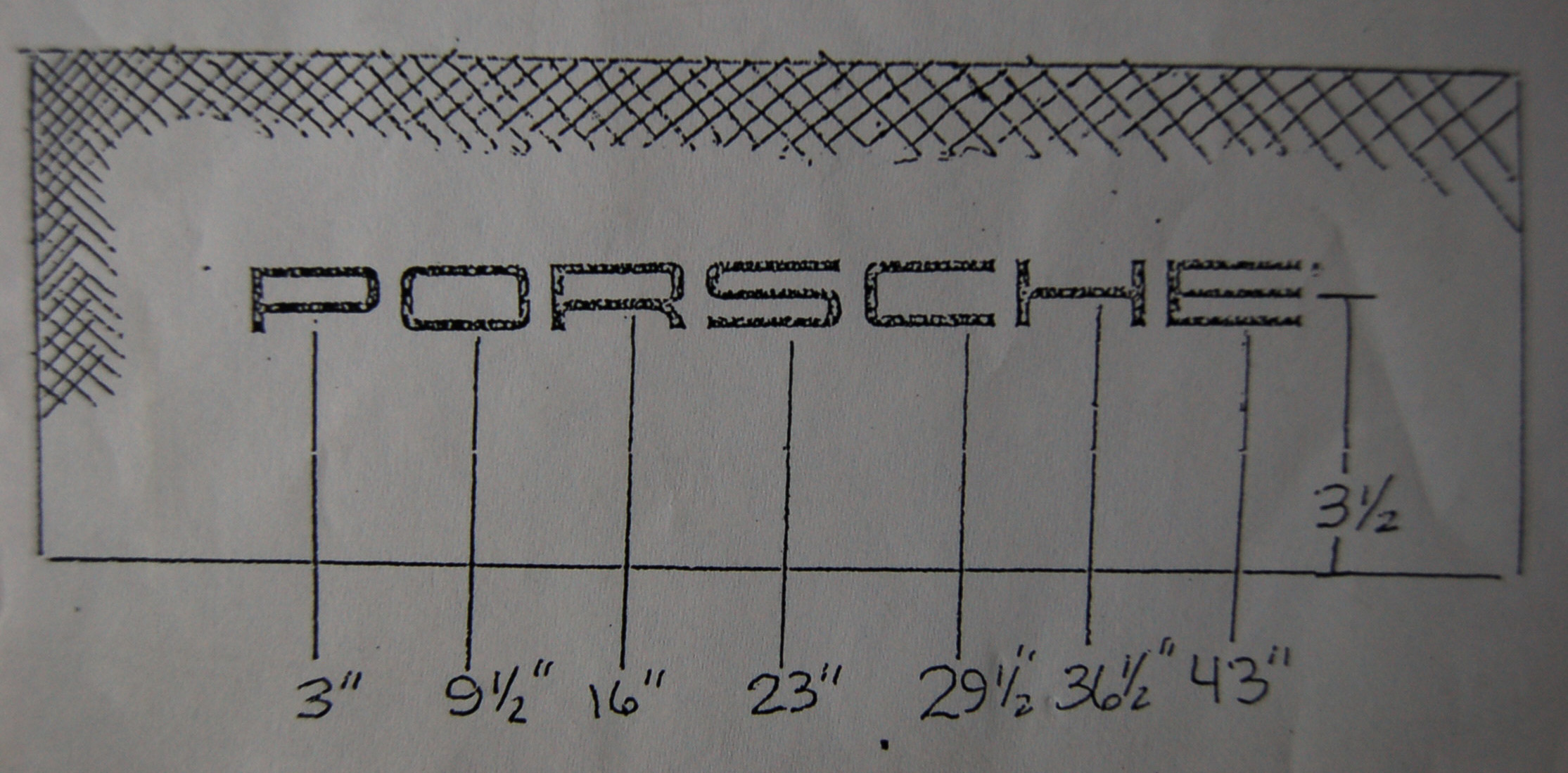

Hi Andy,
Looking good (IMG:style_emoticons/default/pray.gif)

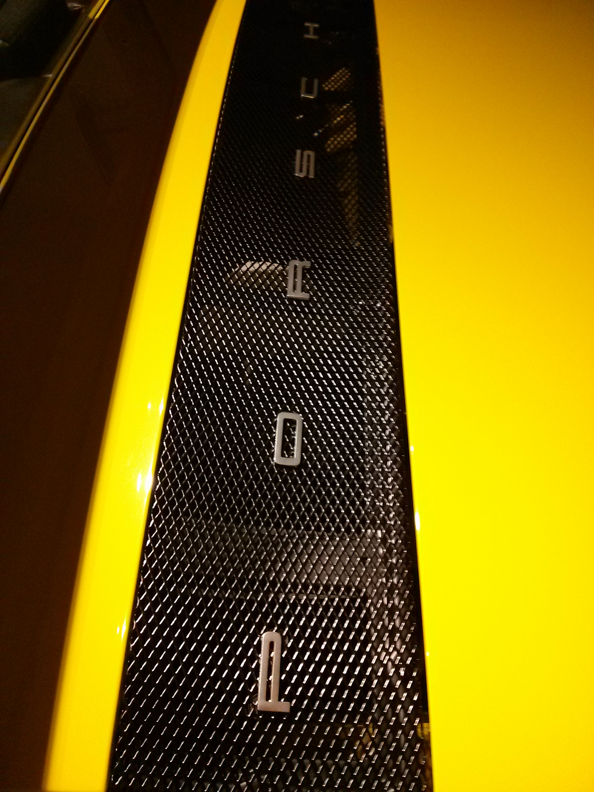

Check those dimensions on the emblems. (IMG:style_emoticons/default/w00t.gif) (IMG:style_emoticons/default/stirthepot.gif)
Tom
Socalandy
post Feb 12 2014, 08:07 PM
Post #955
Its got to be Yellow!!!
Posts: 2,433
Joined: 29-August 09
From: Orange
Member No.: 10,742
Thanks, Your picture is a better reference than what I used along with a grill I have with the lettering still on it. I just went out to the garage and checked and its good.

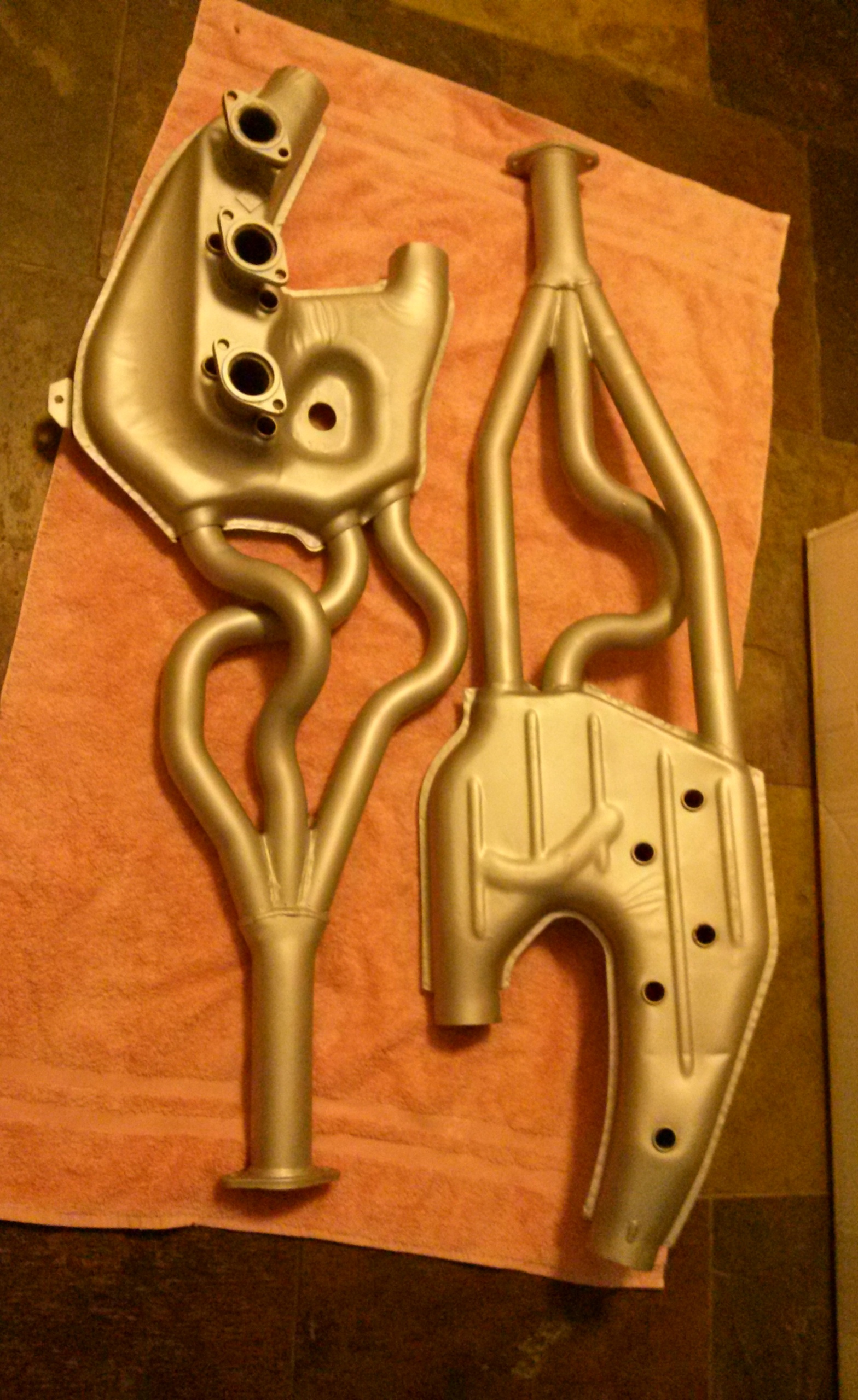

Heat exchangers are ready for the car. ceramic is a little more silver than grey

Ooooo, so jealous of those heat exchangers!

QUOTE(Socalandy @ Feb 10 2014, 10:30 PM) *
Ah memories of that pain in the a%& that was lol. Lookin really good bud.

Those heat exchangers are beautiful. (IMG:style_emoticons/default/drooley.gif)
