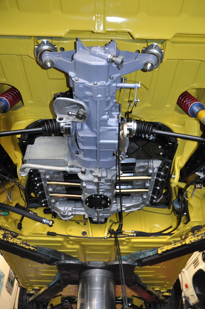

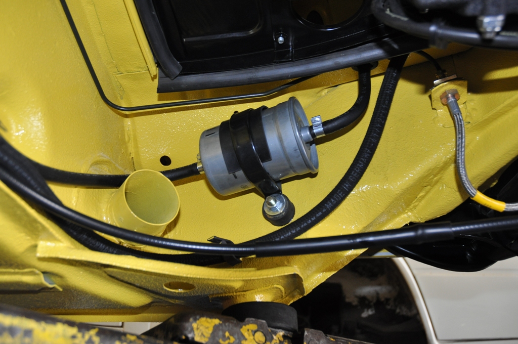

Andy- Man am I jealous. That looks absolutely awesome. I was looking at the picture in post 980 of the fuel pump and fuel line, is that the correct type clamp? I am sure it must be or you would not used it. I just had heard that on fuel lines the clamp should be the style without the slots so they don't cut into the hose. I bet it is OK because if the cloth covered fuel line, but thought I would ask.

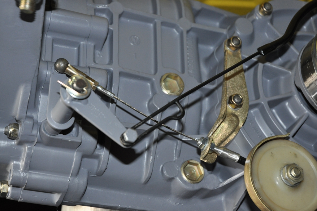

Andy maybe I missed it earlier. I see a side shift tranny there. It is all incredibly clean & beautiful. I went back to see pics of the firewall. For some reason your shift spot at the wall looks funny. Maybe I'm just getting tail shift & side shift mixed up. That looks like a tail shift wall bracket. Is there a custom boot your using to keep the dust out? Hell it's just been a long day & my brain isn't working. At least I can still drool over your car

more progress, CV's and shafts built and installed, Fuel lines complete along with excel,clutch and speedo cables. Went to mount the oil hard line but didn't have the correct fitting for the 3L case so that will be here on Monday so couldn't continue with the oil lines and exhaust.

QUOTE(Cairo94507 @ Feb 21 2014, 07:14 PM) *
Clamps are OE German and will not cut into the lines. To answer Jamie, our relocated resident German "Thomas" built the trans and converted to side shift, I'm running sideshift gear up front with Patrick Motorsports rear tube and bushings

QUOTE(Socalandy @ Feb 22 2014, 05:43 PM) *
I know you got it covered Andy. truly beautiful work. For some reason looking at the firewall pic it just looked wrong to me. Couldn't quite figure out why. I think it was just the combo of the tail shift rubber seal lip there & the upgraded bushing. I can't wait to see the video of it firing up. Going to be sweet to see you at Route 66 next month (IMG:style_emoticons/default/pray.gif)

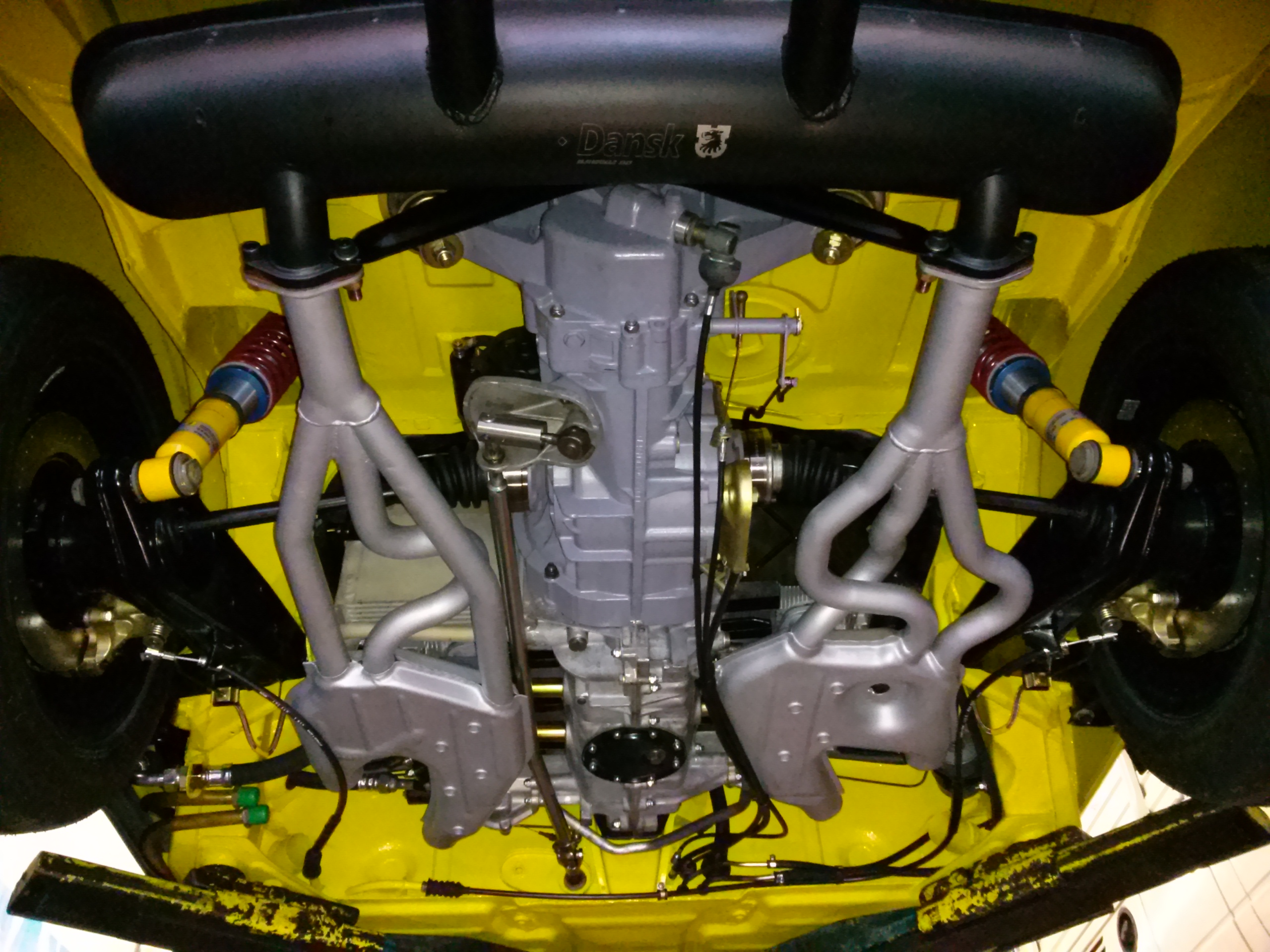

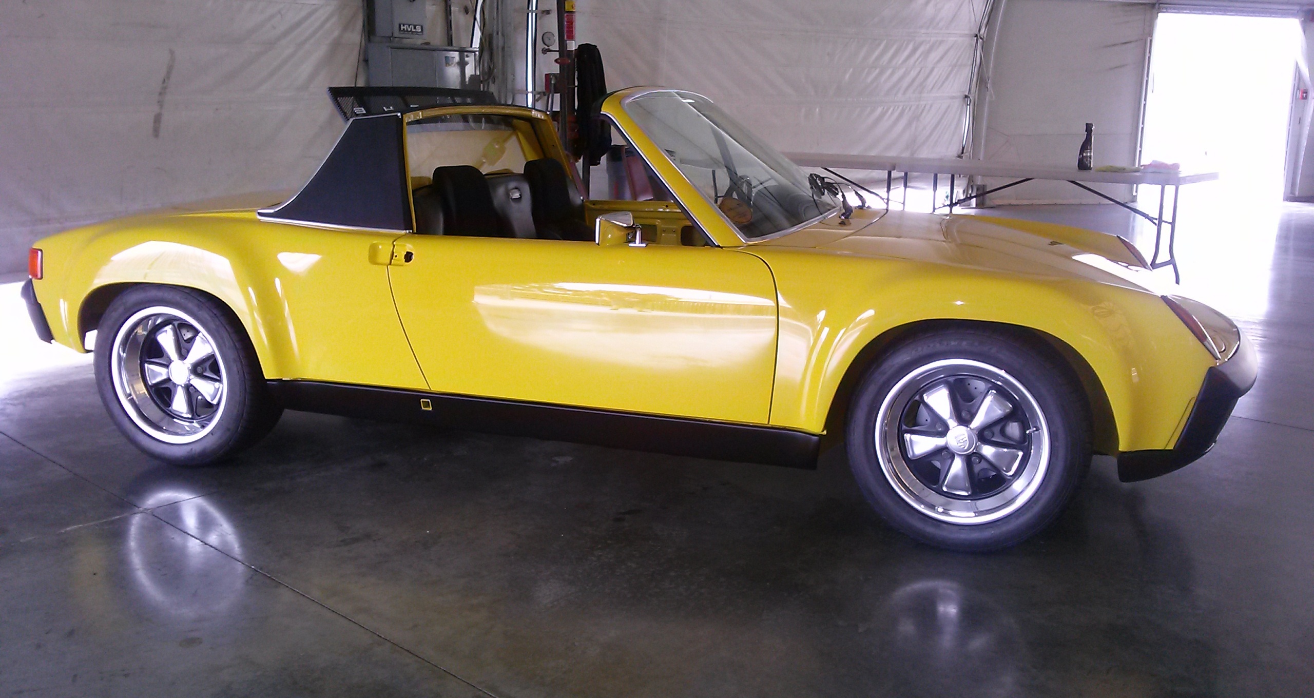

So I didn't get everything done before the show but it was a blast and thanks to everyone that came over and shared their thoughts. Now back to it and get it finished and driving!!!
Got the exhaust on before the Phoenix event and in the tent without a drop of rain.
