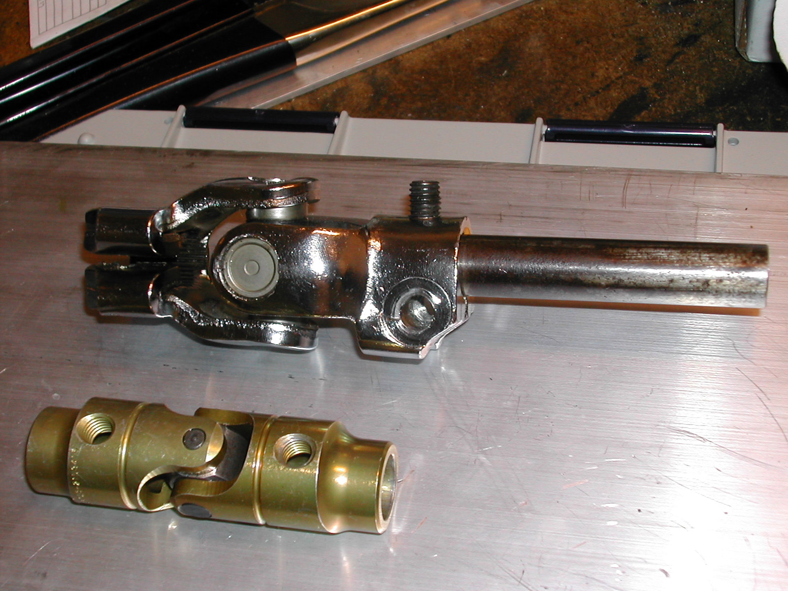

I thought this was going to be a rant, but reconsidered. I like to look at others projects - time to return the favor. Anyhow, I'm putting together a 3.2 with 915 wevo. As a diy'er, I don't have fab capability, so I bought a shift linkage from a well known vendor. I think the product needs improvement. The kit includes front and rear bars, 2 u-joints, and a firewall bearing.
Above is a u-joint from the kit. It is like the joints used in the steering linkage. It is drilled and tapped for a cone screw on one end. Problem is, the screw only engages 1.5 threads before bottoming in the wevo input shaft.
Below is a wevo joint I bought to replace it. Using a wevo joint, you'll get 4.5 threads engagement.

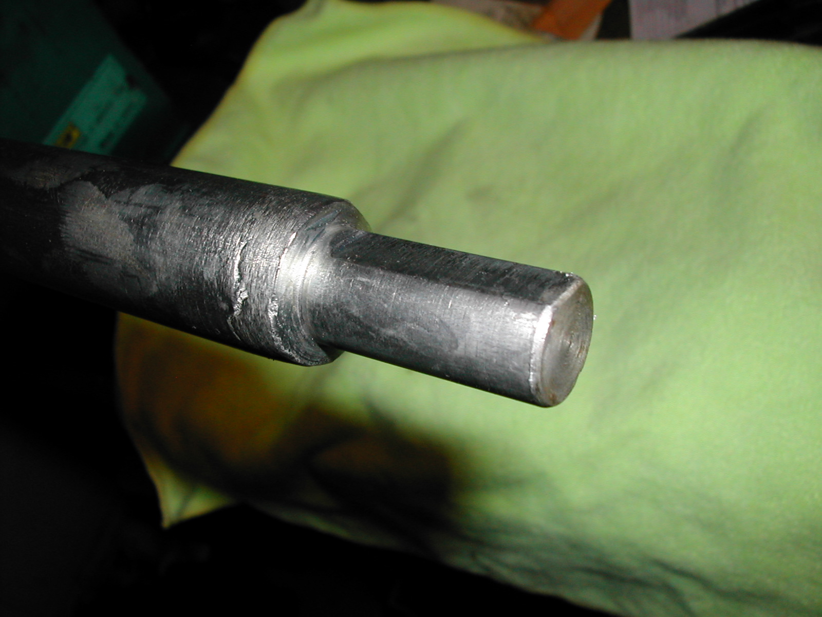

The next problem I encountered was that unlike the steering shafts that have a groove for the pinch bolt, a flat is made in the bar stub. Also, the u-joint is splined, but the stubs are not. Friction holds the thing together, except that on one of the joints the pinch bolt was not strong enough to apply sufficient friction. Here is an example bar stub:

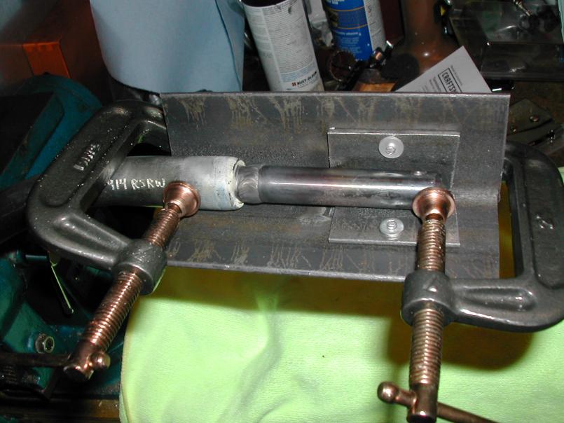

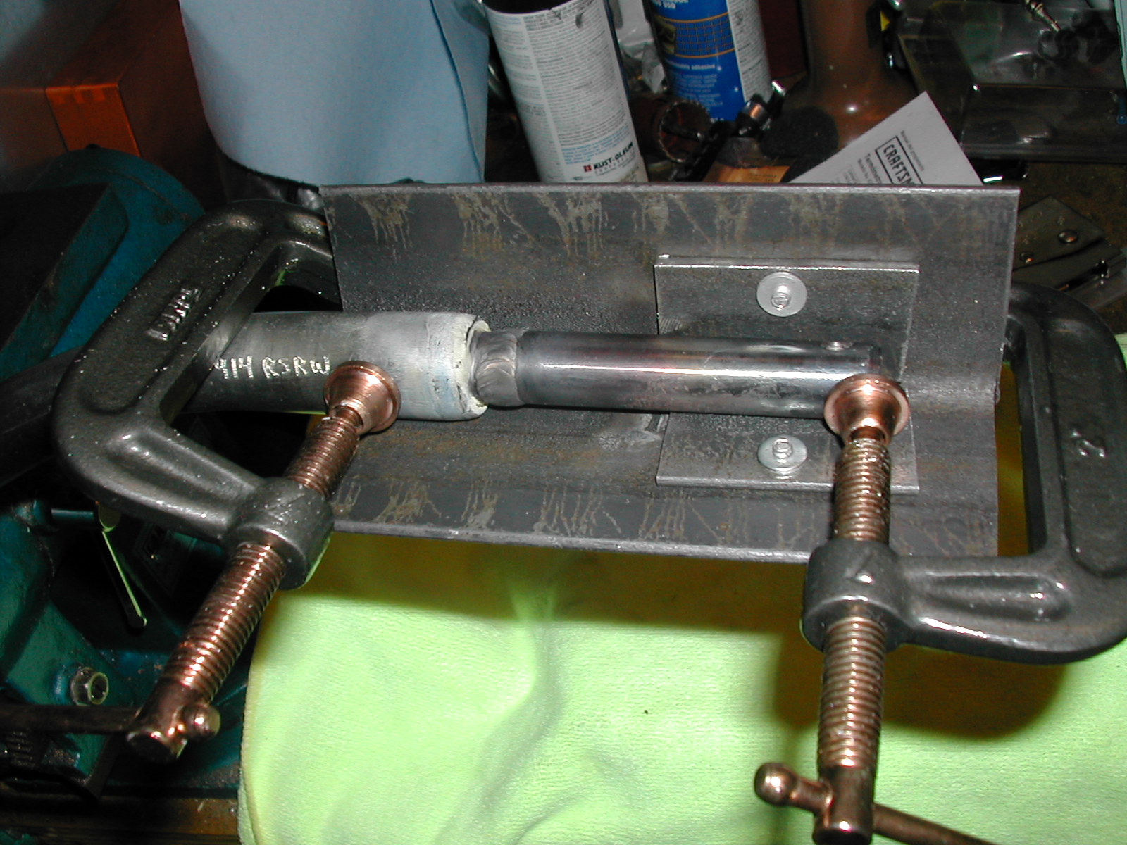

I replaced both u-joints from the kit with wevo joints. Wevo jonts are shorter, so the bar needs to be lengthened. Wevo gave me a spare stub. The bar is 22mm and the stubs are 15mm, so a little jig was made to center the stub. Care must be taken to clock the shift bars relative to the shifter and wevo input. Brought it to a local welder and got this:

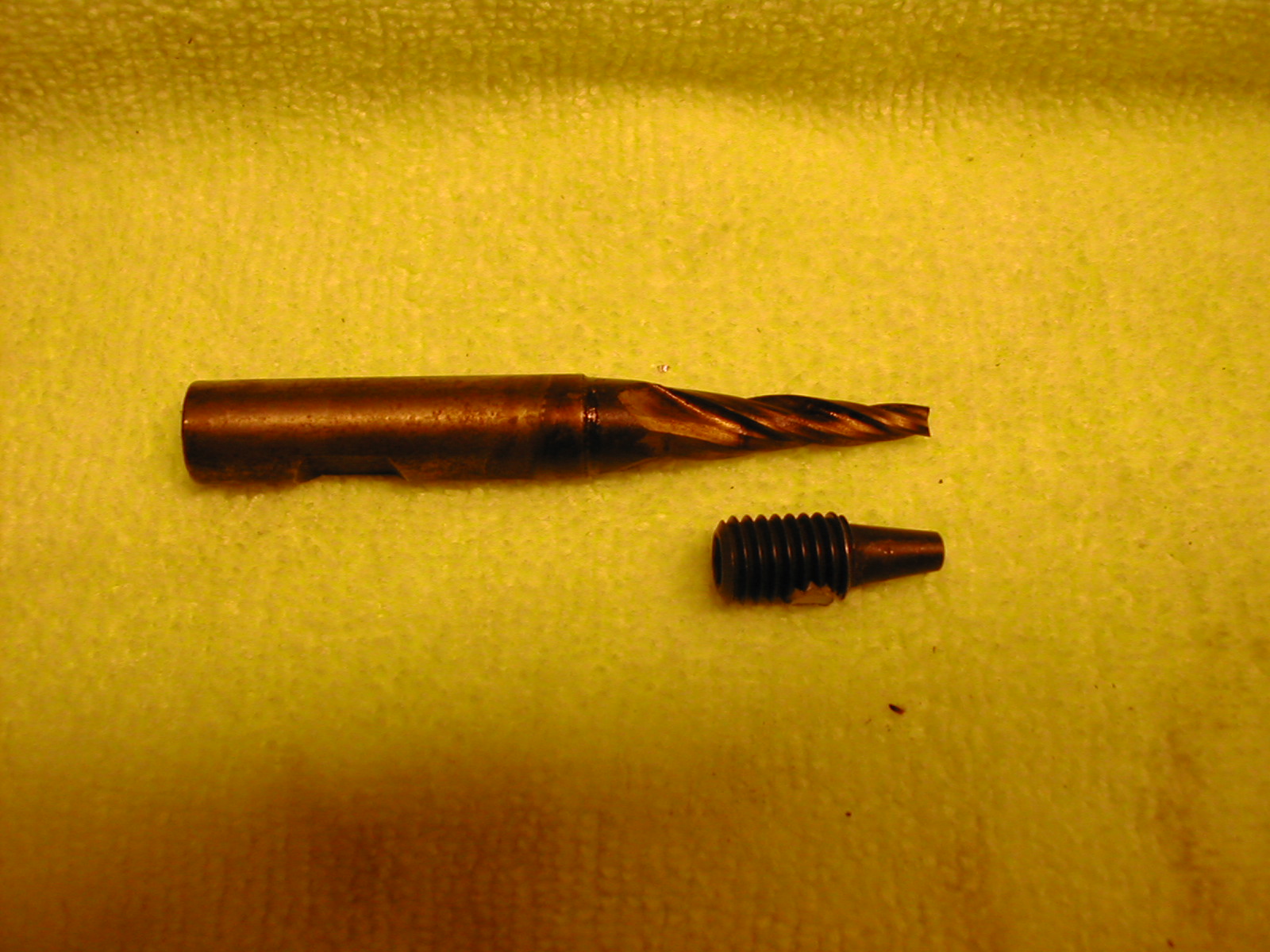

Now with the connection at the transaxle done, move to the front. Here, I needed to make conical holes for the set screws. Went on amazon and got a tapered end mill:

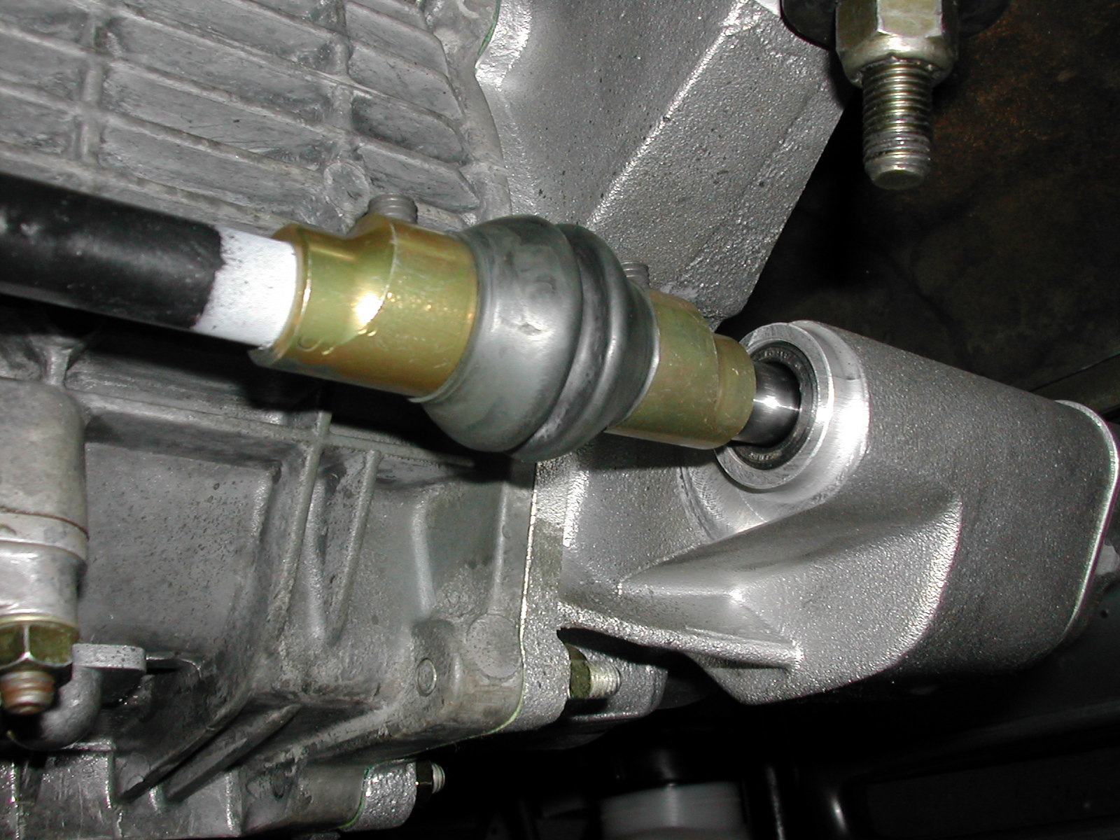

wullah. connection at gearbox:

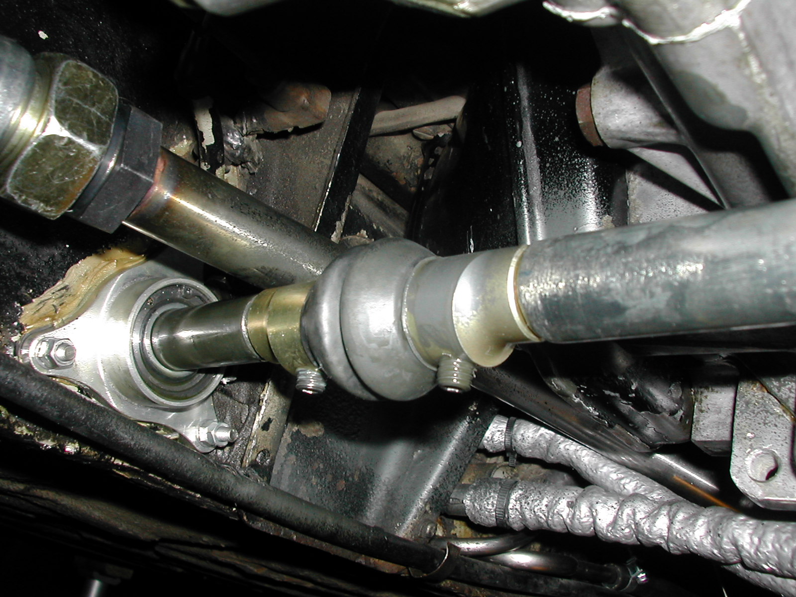

and firewall:

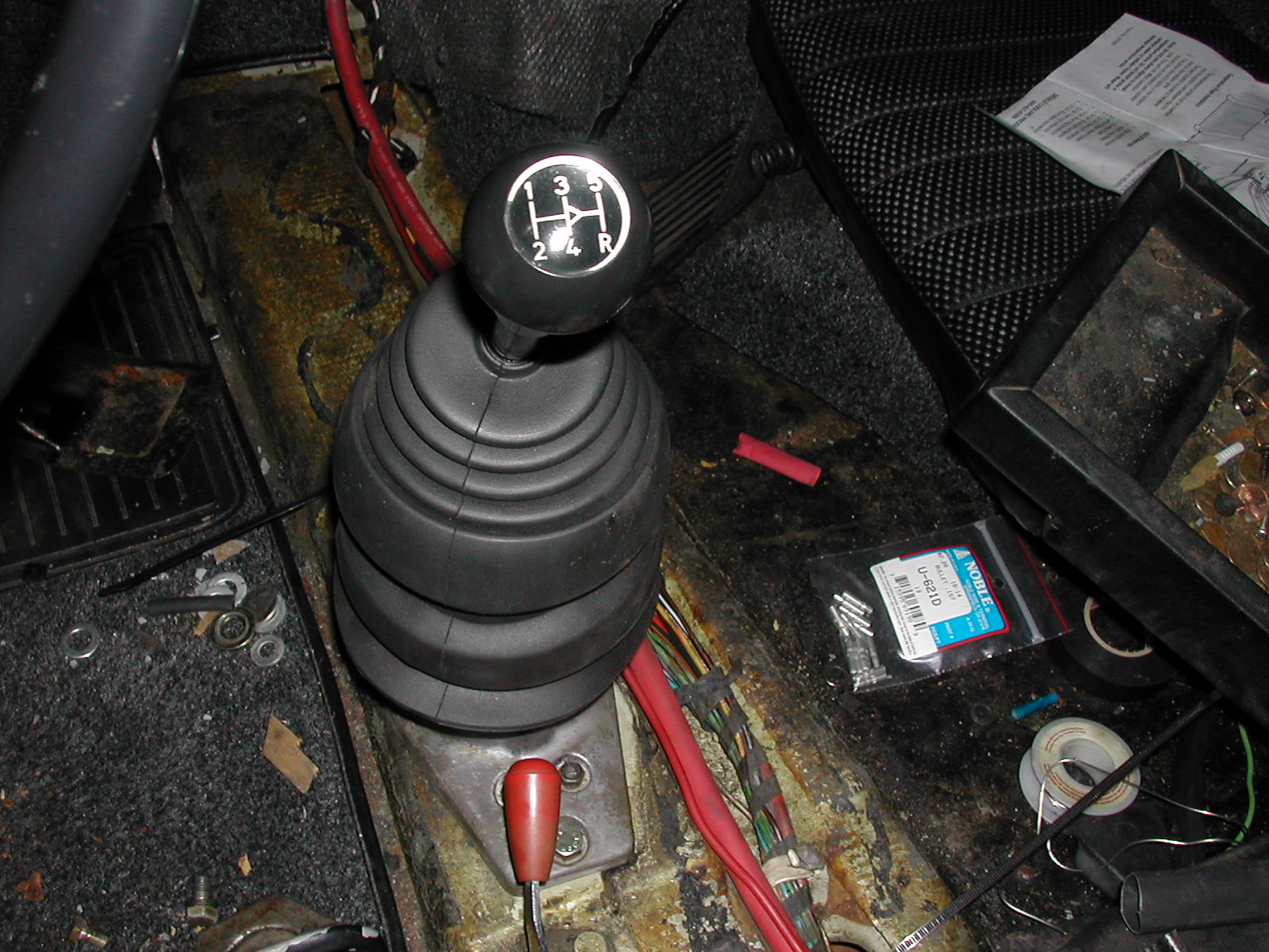

interior, featuring mikey914 shift ball (pardon the mess):
