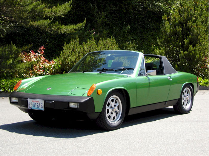

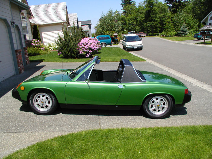

I've got a '75 Palma Green Metallic that is almost ready for new paint. I'm in the process of sanding down and priming. My question is with this metallic paint, is it best to go with a two stage color then clear coat than a single stage? My understanding is that you can't color sand with the metallic fleck in it. But I don't know so that's why I'm askin. (IMG:style_emoticons/default/rolleyes.gif)
The attached photos are what I want the car to look like again.

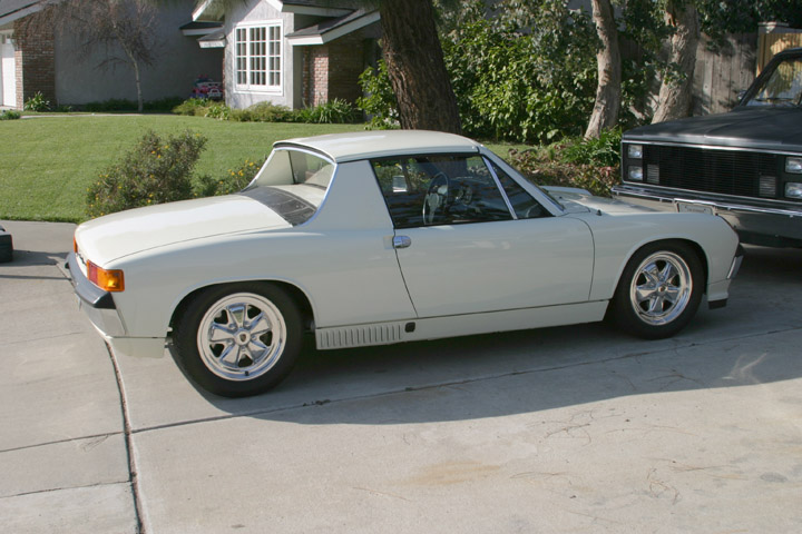

Nice rainy so cal day...half the fam is gone the one remaining is doing homework...i'm gonna get something done...tired of looking at this shell.
Got a nice rhythm going and took down the all the clear (pain in the butt) and some color, but it feels real nice and smooth. just a few tiny spots of rust to ospho before i hit it with metal etch and a coat of primer. I'll hit it with some primer sealer then float out some tiny dents that i cant bang out. Overall, this thing is pretty straight. (IMG:style_emoticons/default/beerchug.gif)

nice and smoooooth....

Hey Stevo, looking good. Yes, it does LOOK nice and smooth, but take a lesson from my experience and shoot and sand a guide coat. I just got done painting (repainting) my 914 and it looked just as smooth as your primer. I did the reflective light test and swore that I had all the dips and bumps out. That is, until I shot the color. That's when I found everything I missed. I had just shot a guide coat using $114/quart paint. For the price of a couple cans of Walmart's best $.98 spray paint I could have avoided a lot of expense and work.
HTH you avoid the same. Good luck on your shoot.

Yep, got paint to shoot a guide coat. I'm just taking it slow (and that goes without saying). I'm just working through how to take the layers down without taking it all down to bare metal.
