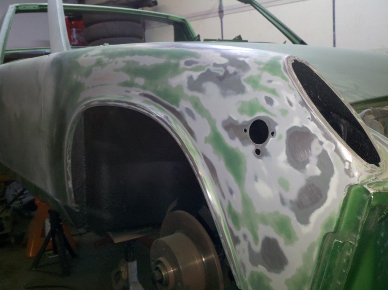

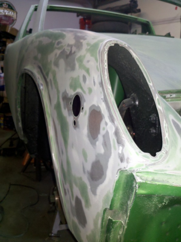

Nice rainy so cal day...half the fam is gone the one remaining is doing homework...i'm gonna get something done...tired of looking at this shell.
Got a nice rhythm going and took down the all the clear (pain in the butt) and some color, but it feels real nice and smooth. just a few tiny spots of rust to ospho before i hit it with metal etch and a coat of primer. I'll hit it with some primer sealer then float out some tiny dents that i cant bang out. Overall, this thing is pretty straight. beerchug.gif

swood
nice and smoooooth....
IPB Image
Cheapsnake
QUOTE(swood @ Oct 23 2010, 03:37 PM) *
IPB Image
Hey Stevo, looking good. Yes, it does LOOK nice and smooth, but take a lesson from my experience and shoot and sand a guide coat. I just got done painting (repainting) my 914 and it looked just as smooth as your primer. I did the reflective light test and swore that I had all the dips and bumps out. That is, until I shot the color. That's when I found everything I missed. I had just shot a guide coat using $114/quart paint. For the price of a couple cans of Walmart's best $.98 spray paint I could have avoided a lot of expense and work.
HTH you avoid the same. Good luck on your shoot.
Tom

swood
Yep, got paint to shoot a guide coat. I'm just taking it slow (and that goes without saying). I'm just working through how to take the layers down without taking it all down to bare metal.
Joe, I'll let you know when i'm going to shoot it. Let's get caught up soon.
