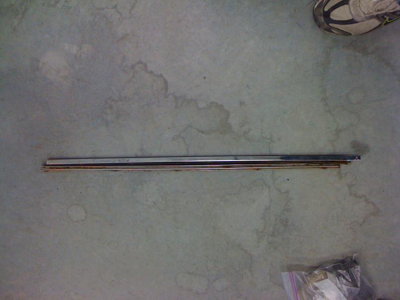

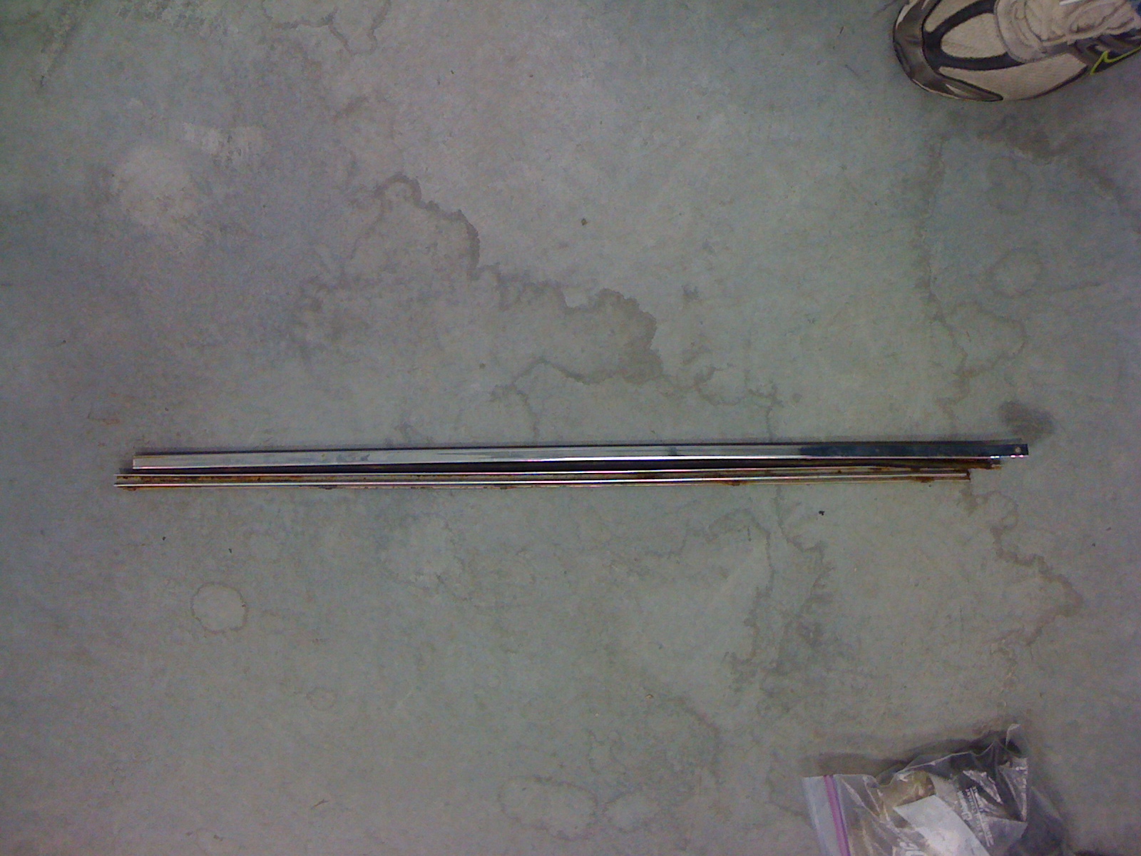

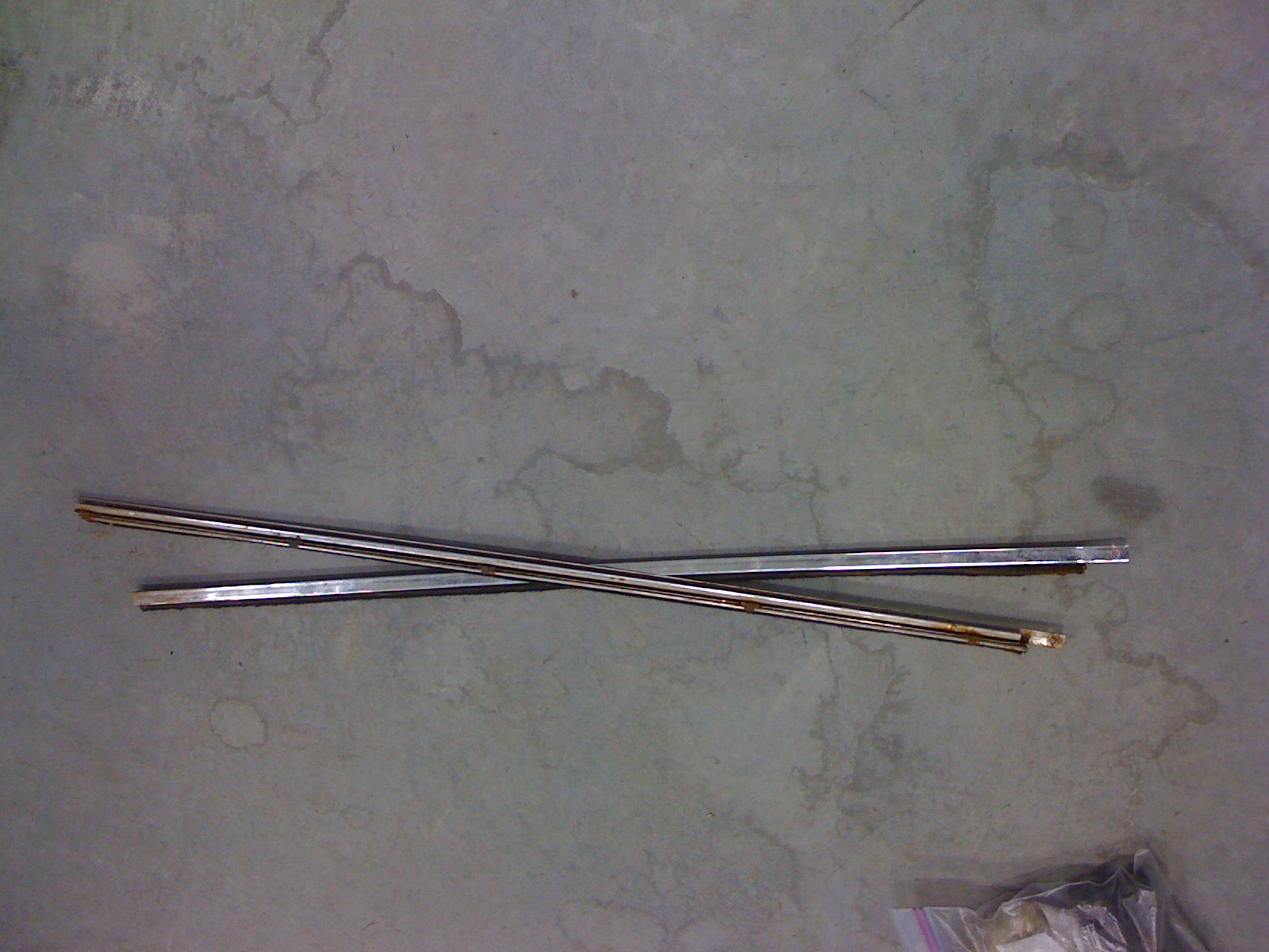

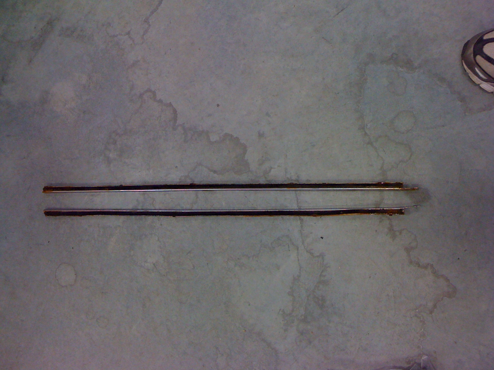

We're trying to figure out exactly where these bright/fuzzy strips go. Obviously a left and right with a slight curve.
Dr Evil
post Jan 30 2010, 02:42 PM
Post #224
Send me your transmission!
Posts: 23,044
Joined: 21-November 03
From: Loveland, OH 45140
Member No.: 1,372
Those go in the door on the outside of the window. The fuzzy strips are very expensive for what they are (Like $70 ea). They are to clean and protect the window. There are like 3 screws (that are usually rusted to poo) that go through the fuzz and hold the assembly on. They suck to install if the window is in place. The channel on top is for the window squeeqie seal.

Mike (Doc Evil), Mike, (Kansas 914) asks; "Do you have the steering wheel as well as the column?"
I think you guys are confusing the bottom part with the top pictured on top. We're trying to identify the top part.

I still believe it is a door part.

QUOTE(Dr Evil @ Jan 30 2010, 02:36 PM) *
Yeah, that's the general consensus around here also. The question is, what door part and where how does it mount?

Window channel? Mounts inside the door?

Fuzz always goes towards the window (IMG:style_emoticons/default/wink.gif)

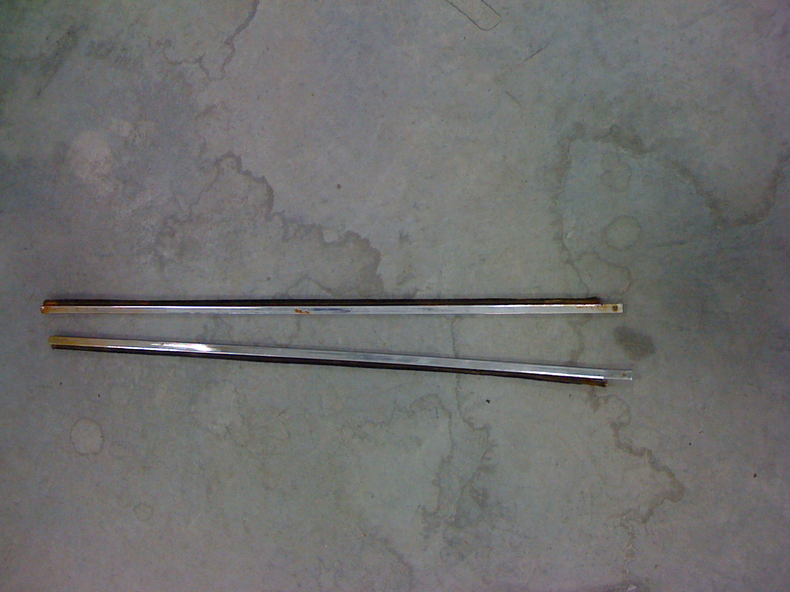

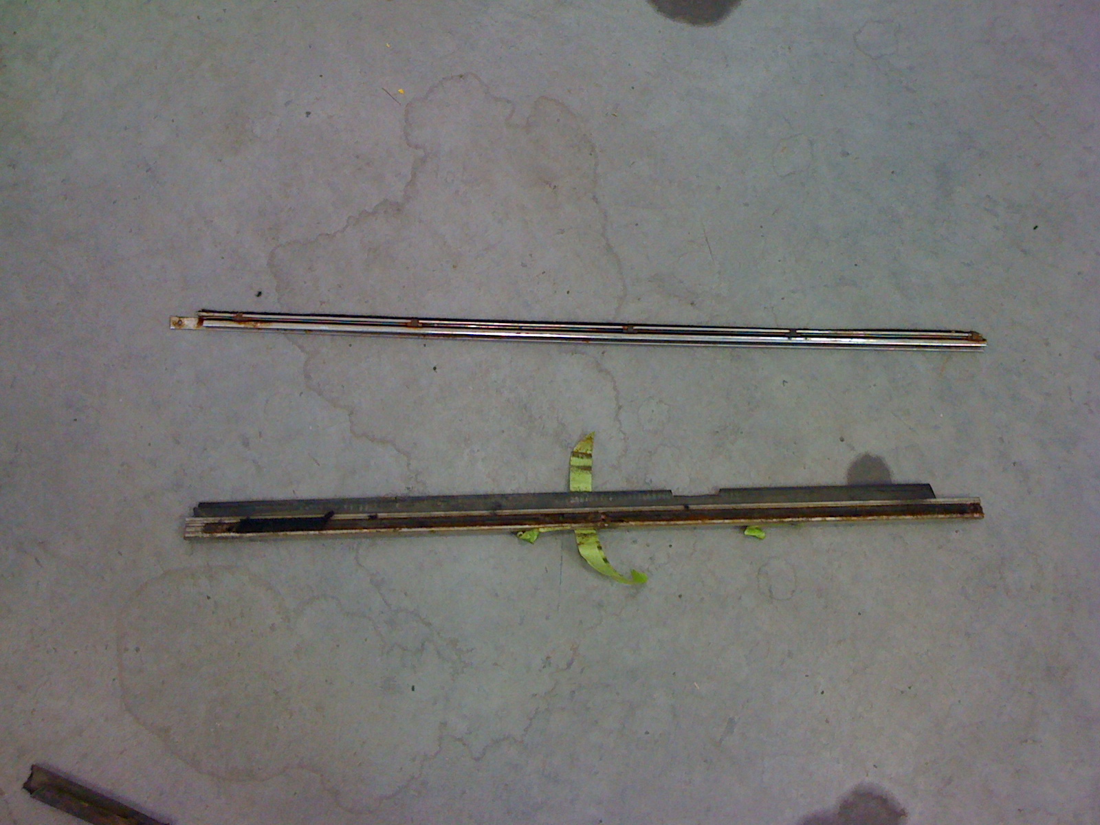

Sent you a text Gint, but is it this piece?

QUOTE(Sleepin @ Jan 30 2010, 03:54 PM) *
I got it, but I don't really do txt messages.
No, that's not the one. We have one of those for each side, but we also have this other one that I'm asking about. Look at the pic in post #226 in this thread. The bottom assembly in the picture is the same one that you've posted pics of. The top one is the one we can't figure out. Seeing your pic though, it may be the inner one. Wish we had a complete 914 to look at right about now.

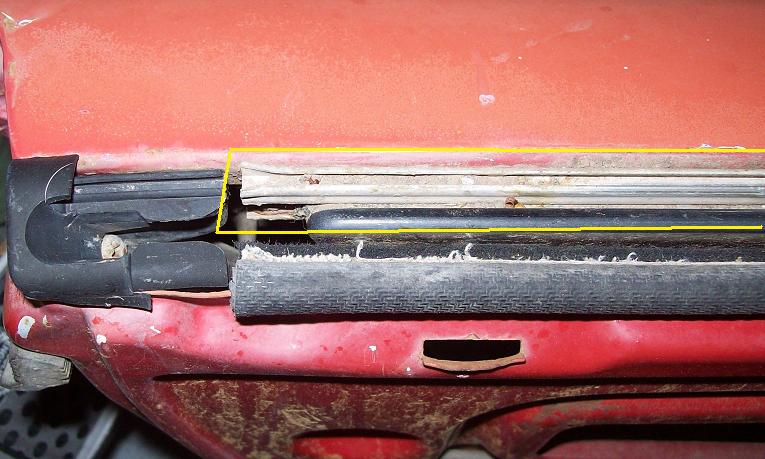

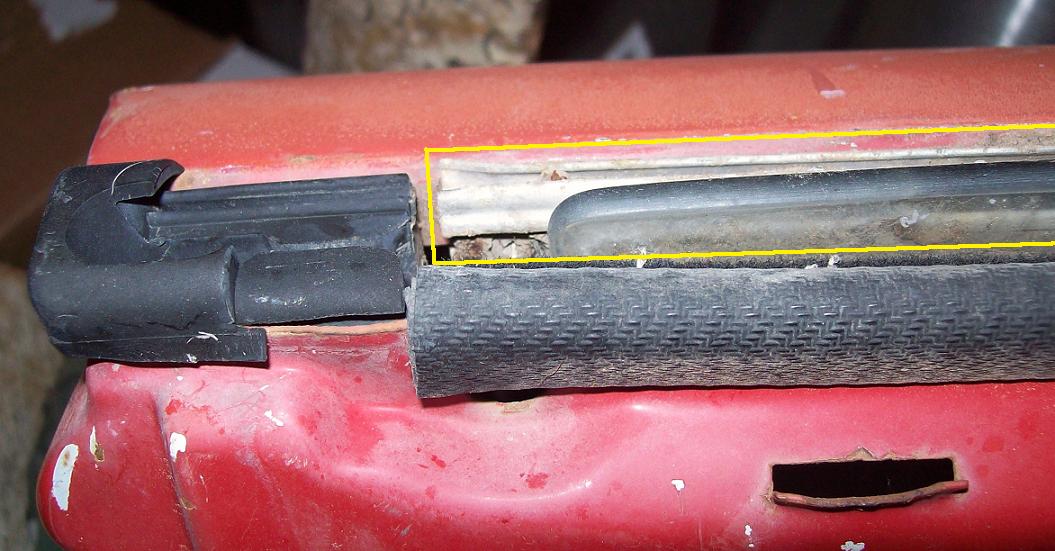

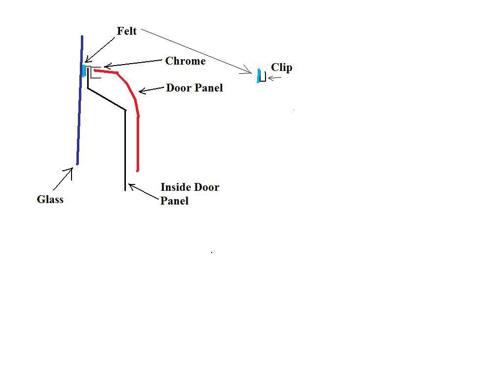

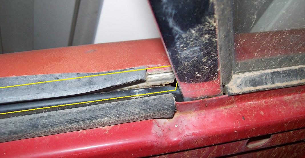

OK we were not her to assemble the car but try to see what was needed for the build off.
I think I figured the part out. I think it goes here in place of the black rubber.
Here is the part.

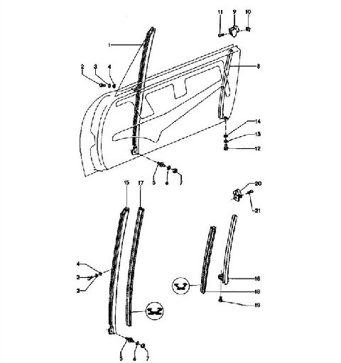

Here is a diagram of how I think the part installed. Anyone have a chrome inner window trim at the top edge of their door panel? My 72 doesn't
Anyone know if the felt is available?
