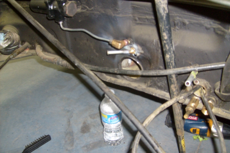

BTW: Here are a couple photos from the recon mission. You can see what were up against! (IMG:style_emoticons/default/screwy.gif) (IMG:style_emoticons/default/biggrin.gif)
rick 918-S
post Feb 4 2010, 08:37 AM
Post #273
Hey nice rack! -Celette
Posts: 21,339
From: Now in Superior WI
Member No.: 43
another
rick 918-S
post Feb 4 2010, 08:38 AM
Post #274
Posts: 21,339
Member No.: 43
another
rick 918-S
post Feb 4 2010, 08:40 AM
Post #275
Posts: 21,339
Member No.: 43
Wish I would have take many more photos.
Kansas 914
post Feb 4 2010, 09:38 AM
Post #276
Posts: 3,008
Joined: 1-March 03
From: Durango, Colorado
Member No.: 373
QUOTE(rick 918-S @ Feb 4 2010, 08:40 AM) *
Notice Rick's Fire Extinguisher (water bottle)... (IMG:style_emoticons/default/biggrin.gif)
It was a fun moment ("Fire in the hole - or tunnel as it were).
