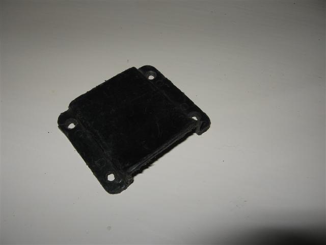

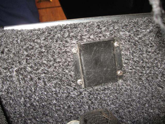

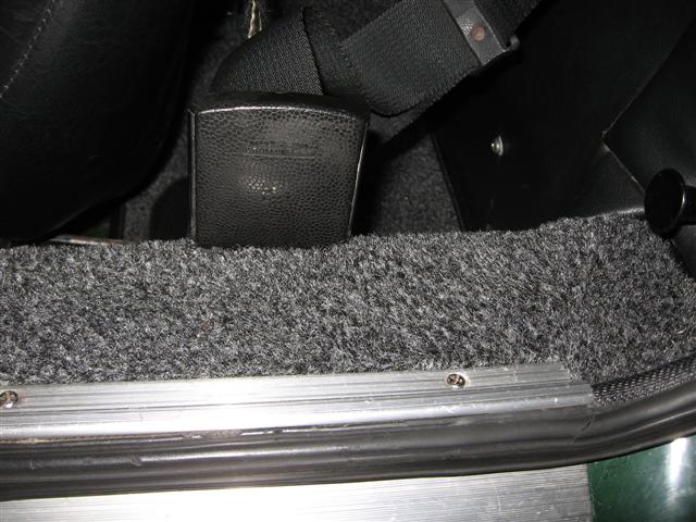

I was diging through my parts and came across this seat belt buckle holder:
so I decided to install it today I pulled back my carpet and found the factory holes"
Here is the belt in the holder:
I have two of these, does one go on the passanger side also? I am a bit lazy to go and pull up the carpet to find out. The car is a '70 and has early interior.

tradisrad
post Nov 30 2009, 10:50 PM
Posts: 985
Joined: 11-September 06
From: San Mateo, CA
Member No.: 6,815
my car has 4 factory holes in the long on the driver side. I have not checked the passanger side yet.
I attached it using screws, but I probably used different screws than the factory.
No part number on it.

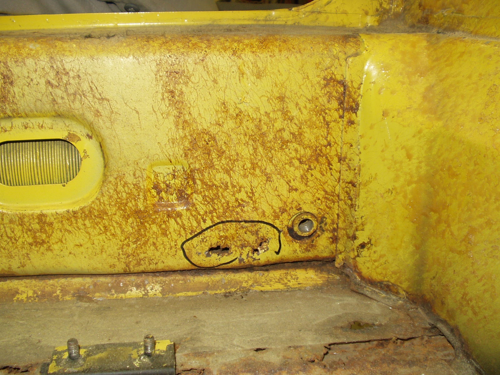

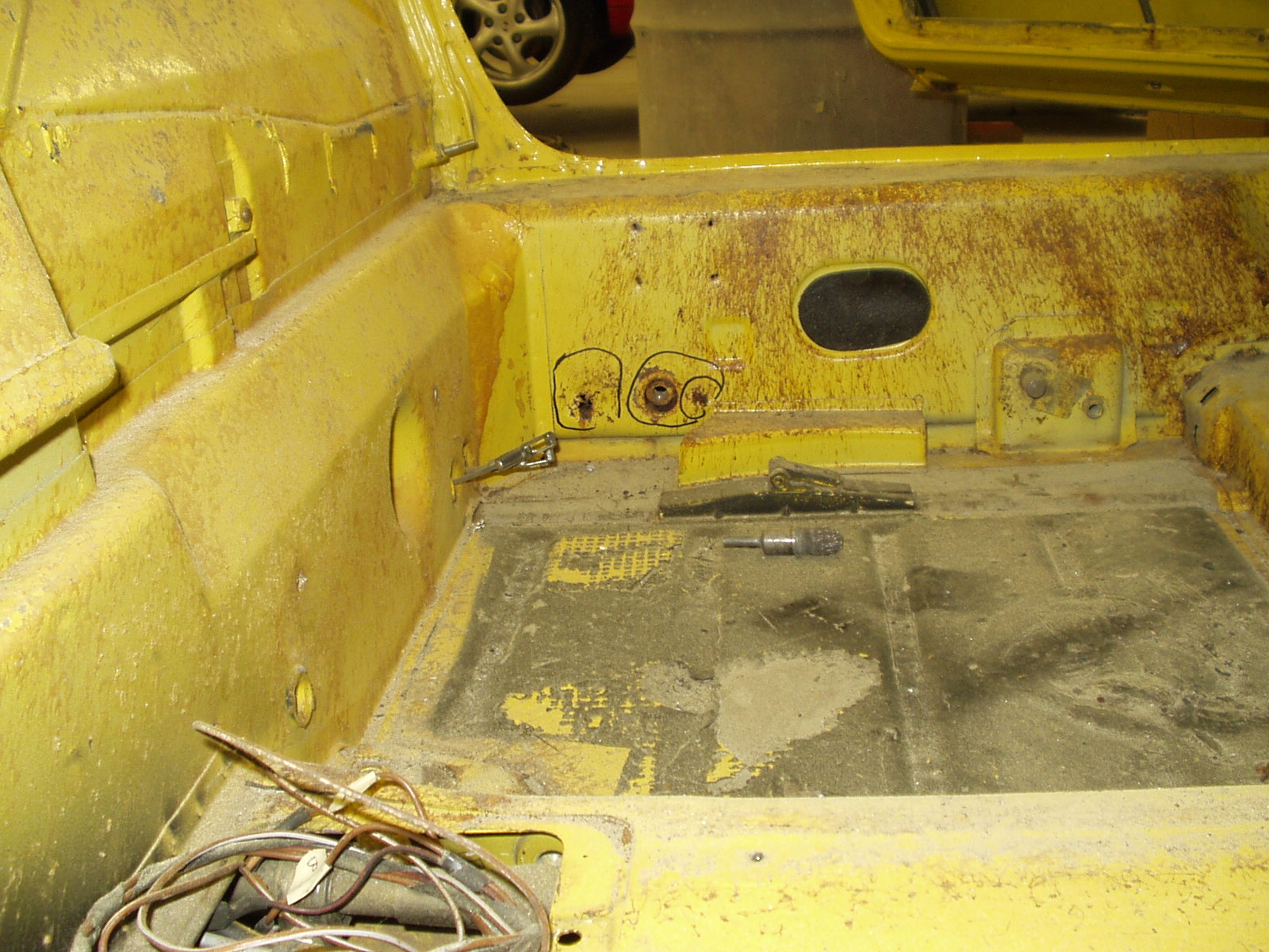

1970 Neun vierzehn
post Dec 5 2009, 10:56 PM
Posts: 3,199
Joined: 16-March 06
From: cincinnati, ohio
Member No.: 5,727
QUOTE(Gint @ Dec 2 2009, 03:54 PM) *
I'll look at the /6 tub tonight. Since it's still bare with fresh paint on it it should be easy. Provided I can maneuver in my tiny garage...
Removing upholstery, seats and carpets reveal this on driver's side ('70/4). Screws are original to car and went through carpet and fastened into long.
1970 Neun vierzehn
post Dec 5 2009, 11:00 PM
Posts: 3,199
Joined: 16-March 06
Member No.: 5,727
Passenger side, rust holes yeah, but no holes for seat belt buckle holster....
