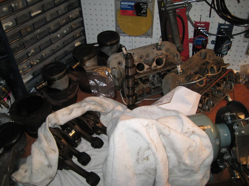

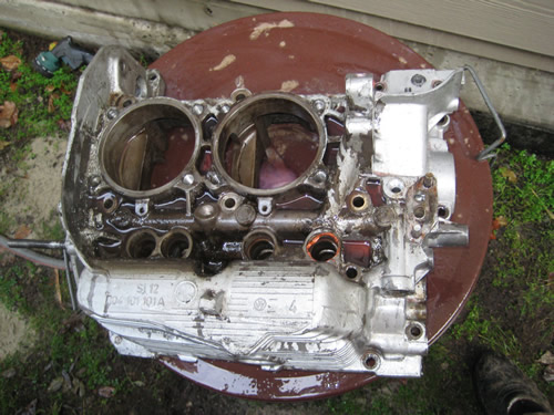

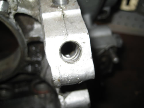

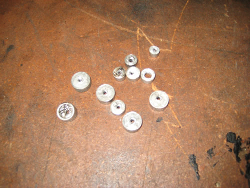

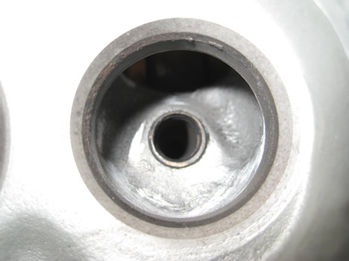

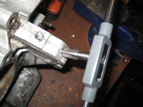

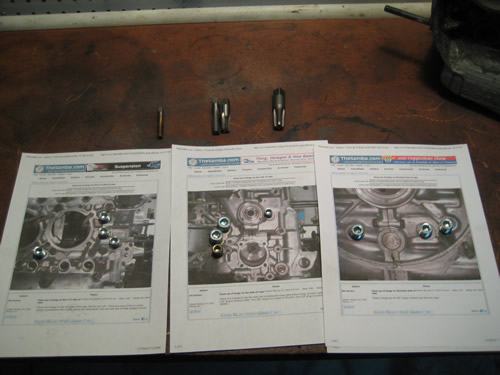

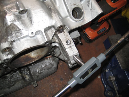

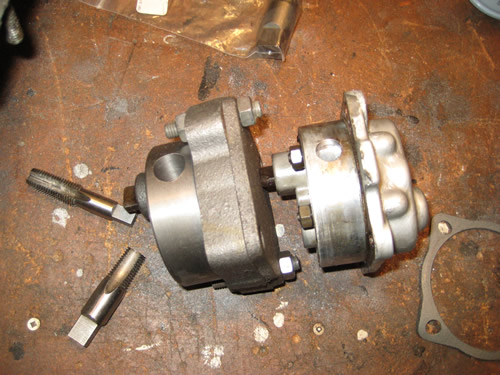

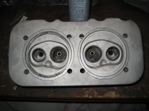

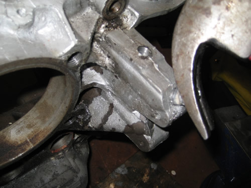

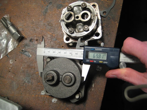

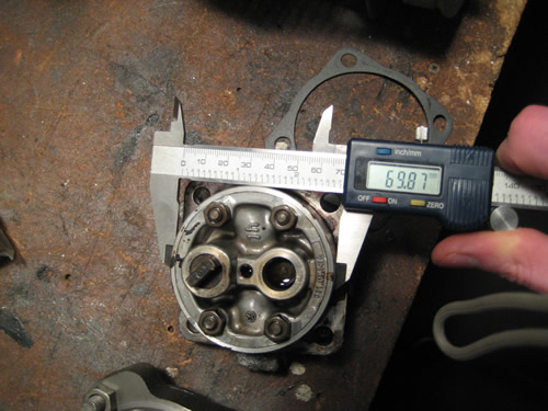

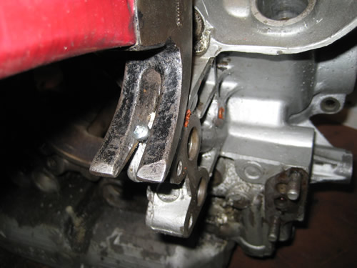

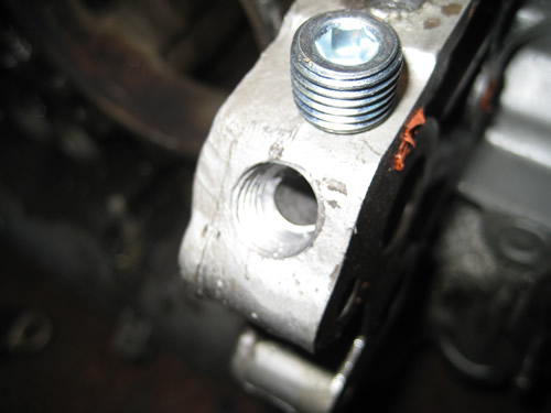

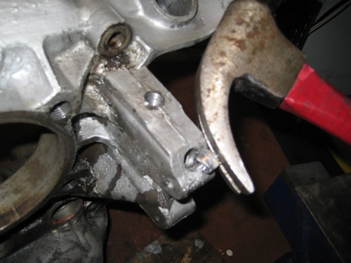

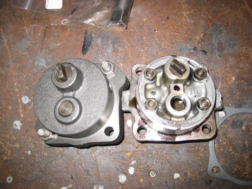

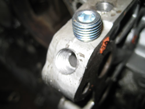

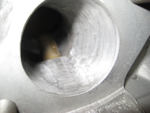

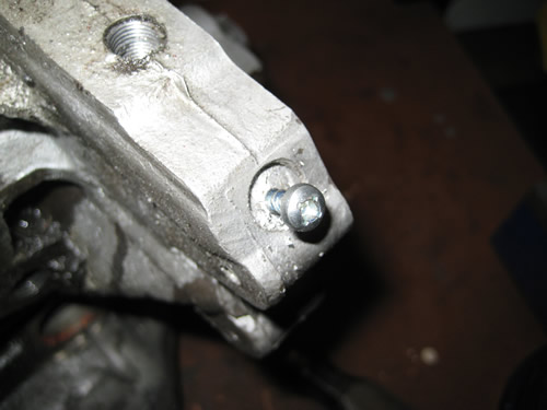

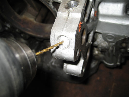

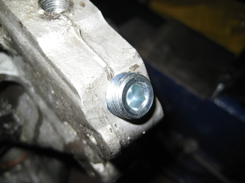

ok - i'm making serious progress now...
* cc'd the heads
* created my own gear puller for the T4 gear (i didnt know the crank gears were substantially larger than T1)
* getting the crank gear off was a feat in itself. propane torch, cold garage - two nights, sweat / swear - finally got it off. putting it on was a piece of cake. 400 degrees (after cleaning), bag of frozen peas on the crank end. slid right on.
* balanced the rods to 1g
* picked up new main and rod bearings - redid the crank setup
* modified the HD T1 oil pump to fit the T4
* new pistons balanced to 1g
* shortblock is nearly ready to be closed up. just going to pick up some permatex thread sealant (white stuff) first.
