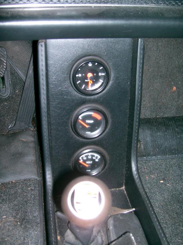

4. There is a temperature gauge in the center console - see attached picture. Is this oil temp? The needle on the gauge moves when power is applied, but the temp never increases. My guess is that the sending unit is bad but I wanted to get another opinion before testing mine and/or ordering one.

The temp guage may not move much (I don't remember my 74 too well). You can check the sender (found under the engine screwed into the small round plate (taco plate) by immersing it in boiling water and see where 212 degrees shows up on the guage.

Center console is an oil temp gauge.. Sender is probably suspect.. But could be the wiring,.. follow the wire from the taco plate to the gauge, some times people make there own connection and center console get screwed around with or even added after purchase so check that 2 also checke ground wire too but usually w/ no ground then the needlee pegs the other way.. suspect the gauge last but do not rule it out.. ..
