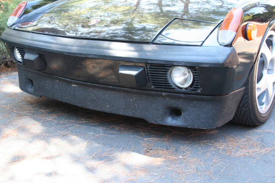

I used it on my front valance/spoiler. This was taken just before I cleaned it and it cleaned up surprisingly well although I don't think I would use it as an interior.
