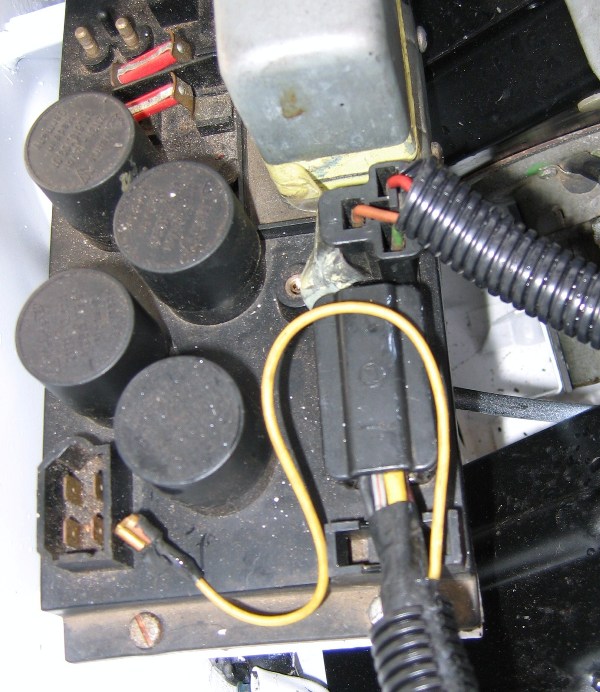

Which prong does this yellow wire attatch to?

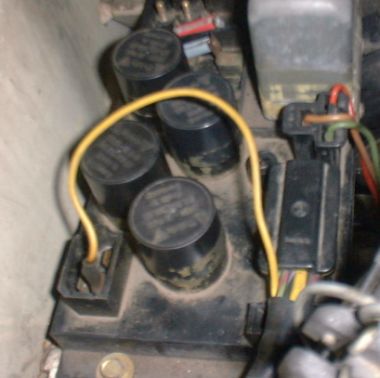

That is the wire that powers the fuel pump on a 1.8L L-Jet system. It needs to be hooked to one of the two rear most connectors on the 4 pin connector on the relay board.
Without that wire the fuel pump will never run when the engine is cranking, and that will keep the car from starting.
