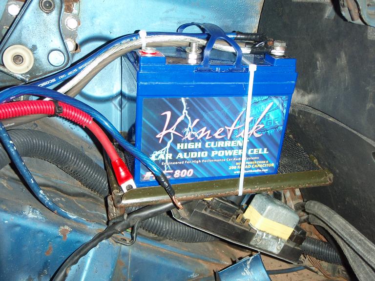

I might not be faster than you guys, but I will have a very unique 914. I pulled all the stereo stuff out of my car, and I am starting all over. I just recieved my Kinetik batteries today.
I got a HC1800 to replace my optima, the 1800 is rated at 1900 Amps. I also purchased a HC800 rated at 950 amps. I just found a upgrade 75amp alternator and a guy who will wind it to 120amp output to drop in place of the 55amp unit. I am going to be High Voltage!
The totall draw on my stereo install will be about 120 amps at peak. I am keeping my amplifiers but building a different cabinet for the rear trunk. It will house both amps and the 800 power cell. I am ditching both capacitors that were in the trunk. The wiring will be upgraded from the alternator (Jeff Bowlsby) and I will run "0" guage from the batterys to hook togeather + to + and - to -. I will also add a few more heavy grounds from each battery to chasis and from chasis to engine. Yes there will be multiple inline fuses on the positive leads. (saftey first)
I will update this thread with pics and progress as i go.

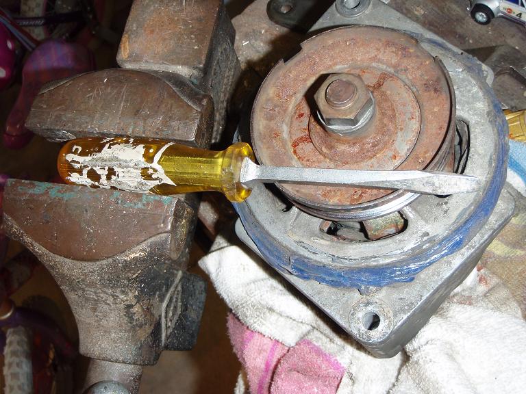

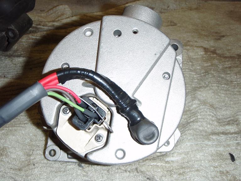

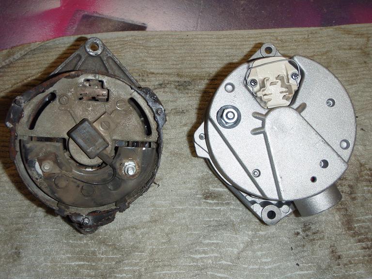

jsayre914   figured i would post the pics of my swap. Basicall...   Jan 12 2010, 09:46 AM

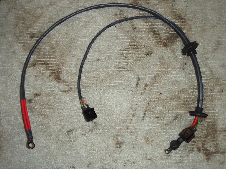

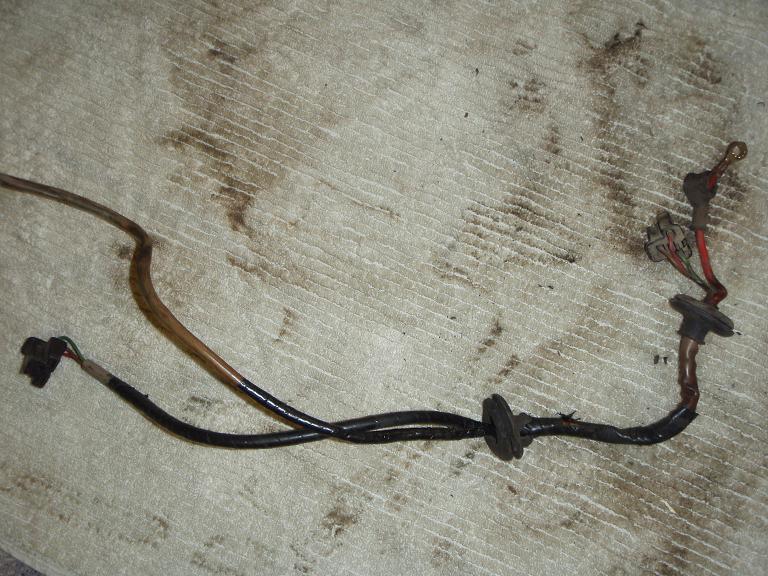

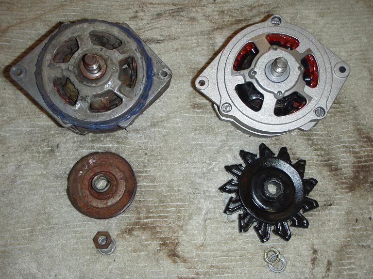

jsayre914   Picture of the old harness and the new harness vs...   Jan 12 2010, 09:48 AM

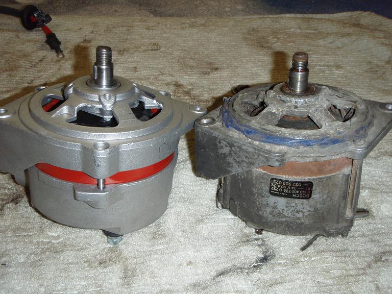

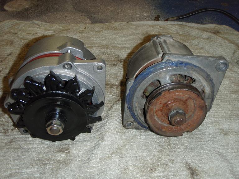

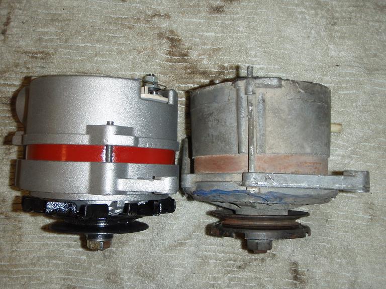

jsayre914   side by side comparison 55 amp vs 120 amp :chow:   Jan 12 2010, 09:51 AM

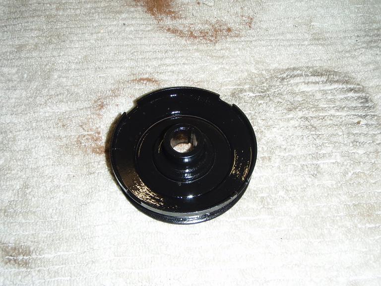

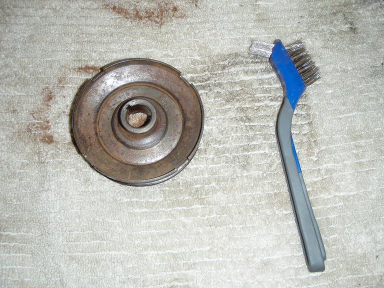

jsayre914   Then to get the pullys off it is a little tricky, ...   Jan 12 2010, 09:53 AM

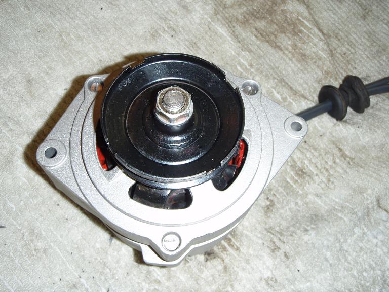

jsayre914   Now that they match, I painted the pulley so it wo...   Jan 12 2010, 10:00 AM

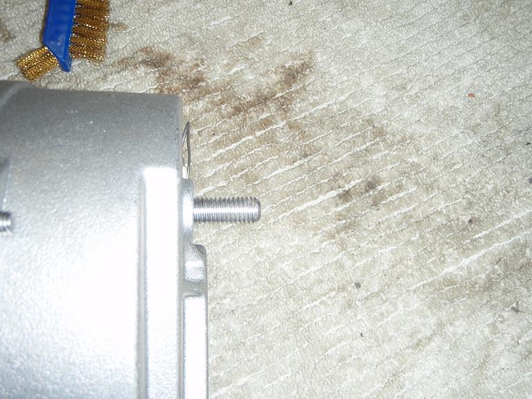

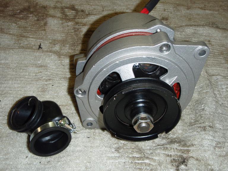

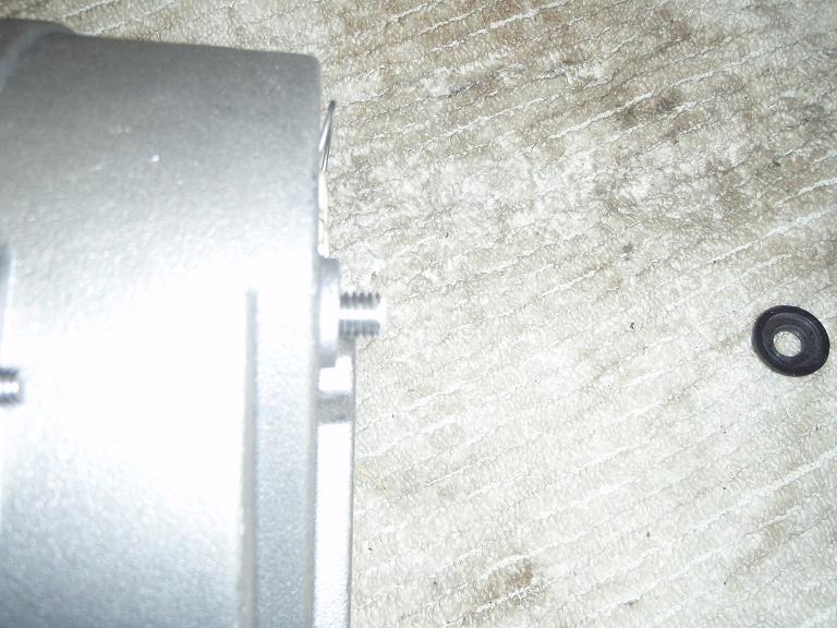

jsayre914   The Bolt was a little tight so had to be adjusted ...   Jan 12 2010, 10:05 AM

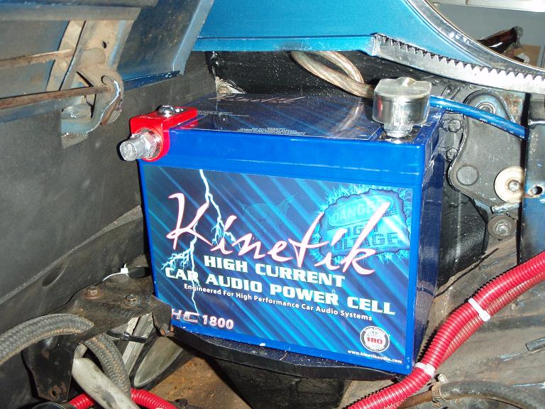

jsayre914   The Final result, looks almost stock and fits exac...   Jan 12 2010, 10:07 AM
jsayre914   Now I should have just enough power to listen to m...   Jan 12 2010, 10:09 AM
SirAndy   Any way you could have kept the cooling fins? Woul...   Jan 12 2010, 02:14 PM
detoxcowboy   Any way you could have kept the cooling fins? Wou...   Jan 12 2010, 03:19 PM
Dr Evil   Why are you running two different batteries? One i...   Jan 12 2010, 11:22 PM
