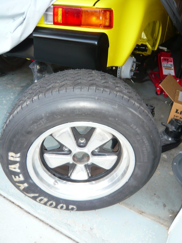

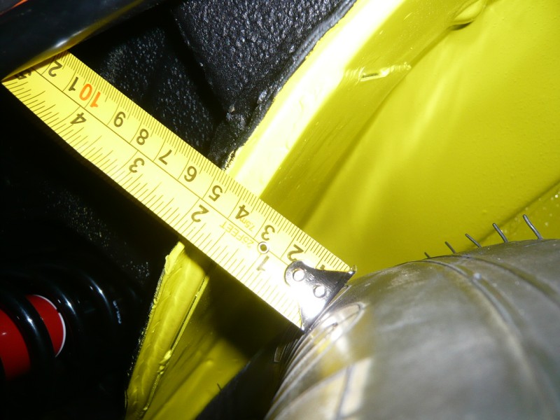

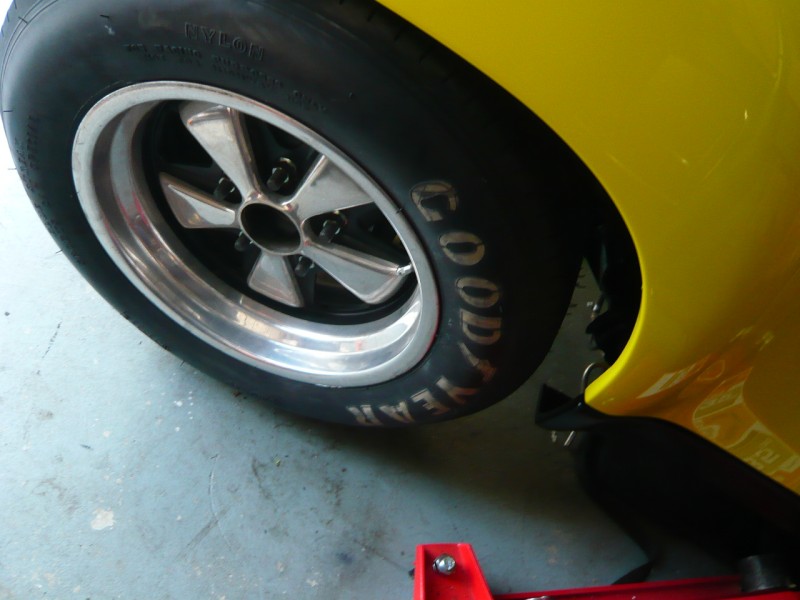

Eric_Shea
post Jan 30 2010, 06:43 PM
PMB Performance
Posts: 19,304
Joined: 3-September 03
From: Salt Lake City, UT
Member No.: 1,110

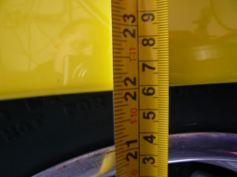

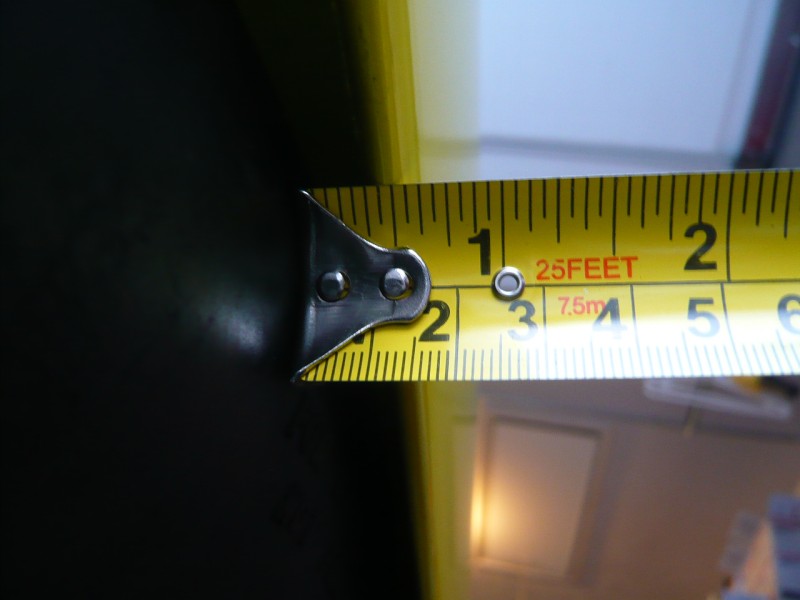

Looks like it barely makes it... 1/4" of clearance on the outside and plenty inside (1 1/2"). I have 5mm spacers under the rotor as well. I could take those out and space the calipers back by 5mm if need be.

Thanks Mark, I done bought'em already. You're looking at the result.
This is what we were talking about with the 8x15 offset. It's just about perfect for a GT flared car. Those have a 10.5" standard width.
If I yank that spacer I'll have a tad over an 1" on the backside and "almost" a 1/2" on the outside. That is... unless the camber needs to be set and, from the rear it looked like there was a smidge of negative in there.
Relieved.
