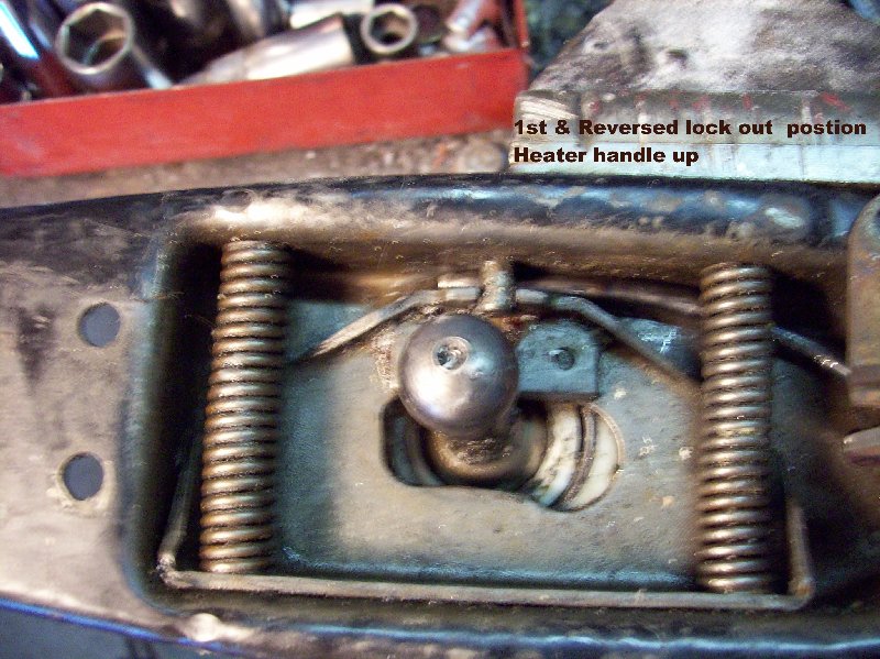

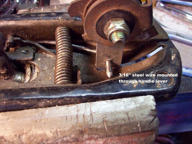

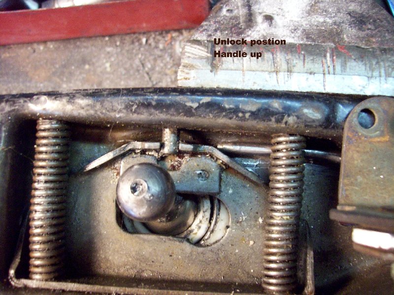

904svo
post Dec 18 2009, 09:56 AM
904SVO
Posts: 1,129
Joined: 17-November 05
From: Woodstock,Georgia
Member No.: 5,146
Heres how I did it.

QUOTE(904svo @ Dec 18 2009, 07:56 AM) *
Heres how I did it.
Brilliant! (IMG:style_emoticons/default/aktion035.gif) (IMG:style_emoticons/default/aktion035.gif)

Two years ago at the "Renfest" in Daytona I noticed that almost all the Old 914 racers had a lock out. Most were a simple drop down bolt/ wire .
