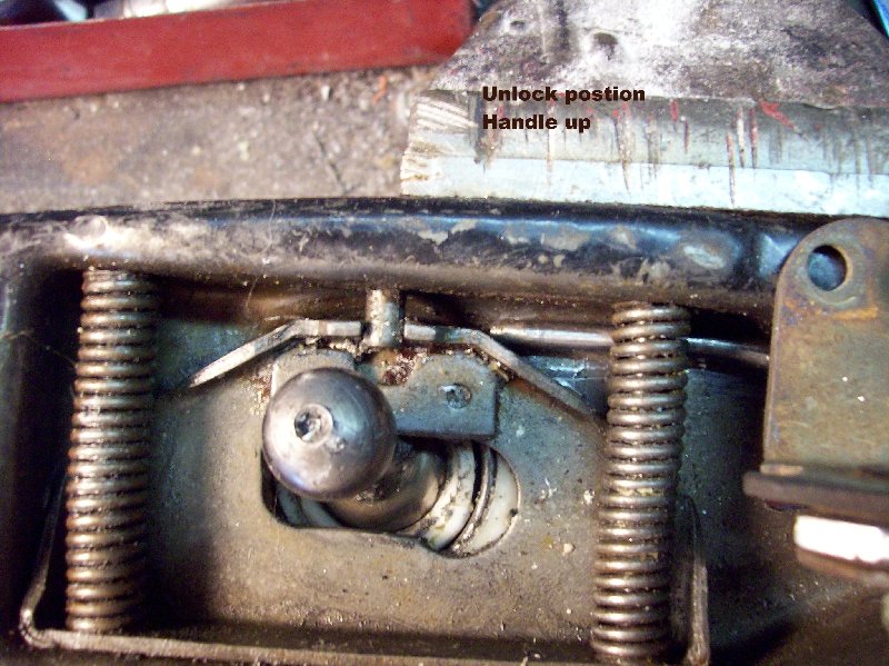

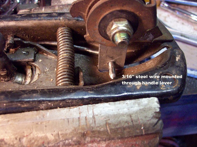

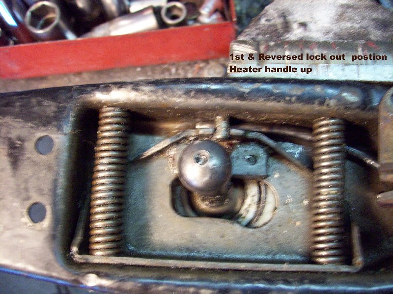

904svo
Heres how I did it.

QUOTE(904svo @ Dec 18 2009, 07:56 AM) *
Heres how I did it.
