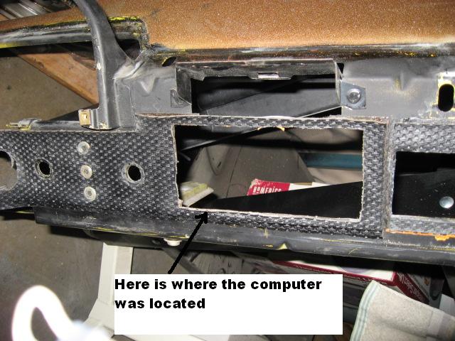

The DAPO installed some crazy computer system in my car that monitored all kinds of stuff, CV velocity, injector pulses to name a few. None of it worked so I intended to rip it all out someday...that was today.
The dash frame was hacked up as well to house the computer and some hack job on the vent controls since they had to move to make room for the computer, so today I decided to pull the dash frame so I could return it to stock condition. I labeled wires I pulled off the gauges and pulled the switched out of the dash without pulling off wires.

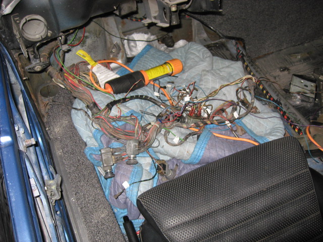

The forward harness is just laying in the floor and I'm feeling a little overwhelmed. Tell me there is a resource available to put it all back together. Wire that previously went to the air controls were wired to switches...

We'll all done that one time or other. Good news is you probably have another 914er close by that can help and after 30-40 hours of work you'll figure it out. (IMG:style_emoticons/default/biggrin.gif) Really it's not that hard after you understand how German wires layout. They're all color coded. There's an ebay store that sells jumbo size, laminated, colored and labeled electrical schematics..http://www.colorwiringdiagrams.com
It's the only way I finally figured it out. Post Pictures! Good Luck and Merry Christmas.

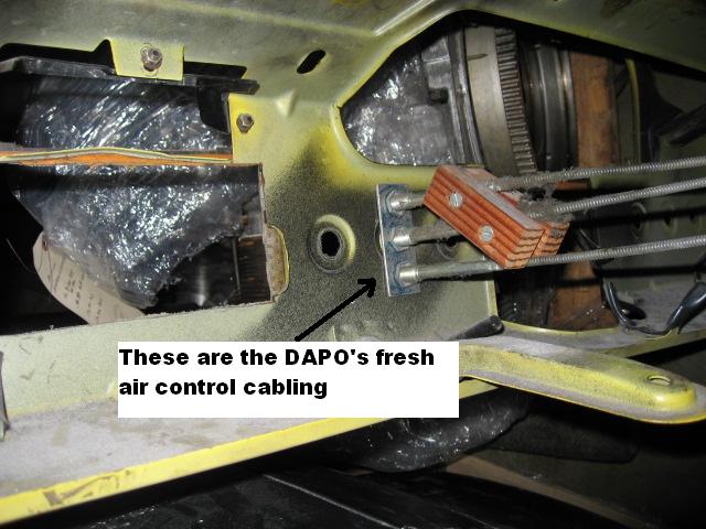

Here are a few photos of the dash frame, I suspect the biggest unknown is the wiring that goes to the fresh air slider controls, they were connected to a rheostat in the dash. Hopefully they're still long enough to get to where they need to be.

Kevin - That dash assembly setup is really bizarre and that's a big hole! If you're down this far you might consider just buying a whole new dash assembly from somebody who has some parts cars and just bolt it in. Ask them to include the heater/vent assembly as well.
Note; Bruce Stone probably has one and he's local. PM him; bdstone914.

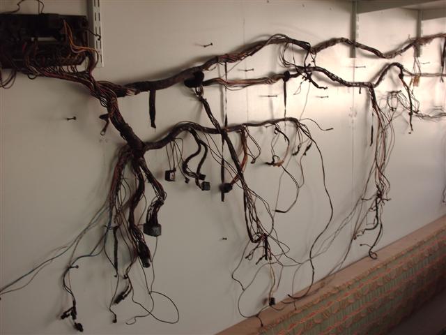

I have a complete harness from a '75 in a box that may help. When I first got it, I mounted it the length of the garage wall; I wanted to see where everthing goes. A few of the color coded wires were cut and used on my 914; 99% is intact with switches and fuse panel. I also have a laminated wire diagram. Let me know if you can use it. It's in a box and ready to use.
Steve,
One of the first things I did when I got this car some 4-5 years ago was locate a dashframe. Mike D. up your way graciously donated one I'm going to use.

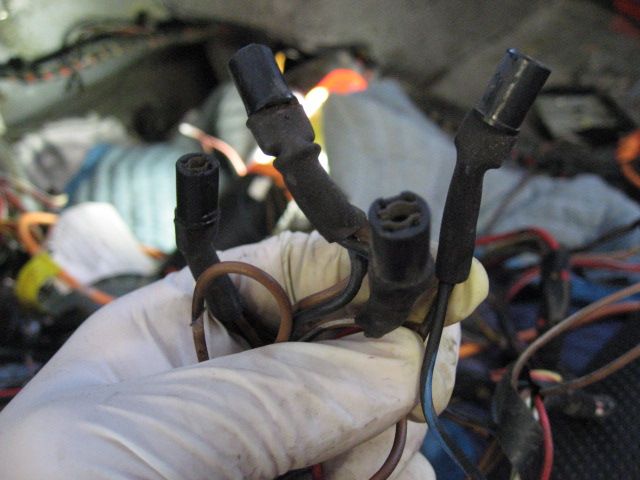

kconway
post Dec 22 2009, 05:26 PM
Posts: 1,347
Joined: 6-December 04
From: Monrovia, CA
Member No.: 3,231

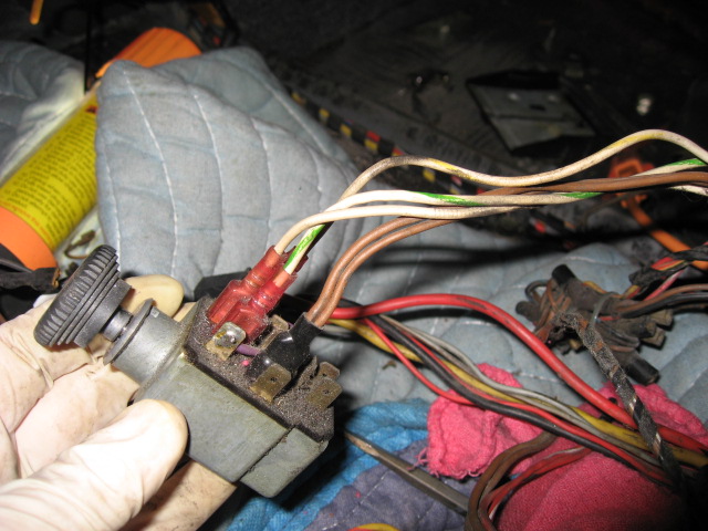

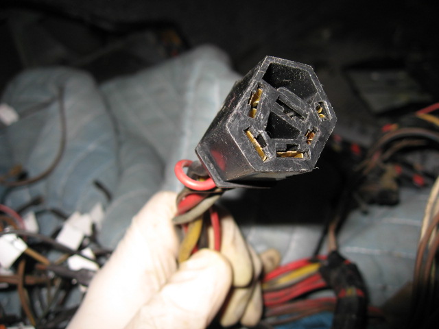

Can you identify these as original wires/connectors and what they go to?
#1
#2
#3
post Dec 22 2009, 05:37 PM
Resident German
Posts: 42,565
Joined: 21-January 03
From: Oakland, Kalifornia
Member No.: 179
#1 - Goes to the Steering column
#2 - Dash lights (well, you have the sockets, without the lights)
#3 - A switch of sorts, a pic of the knob would help ...
(IMG:style_emoticons/default/bye1.gif) Andy
