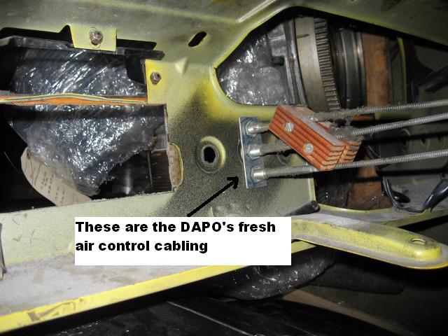

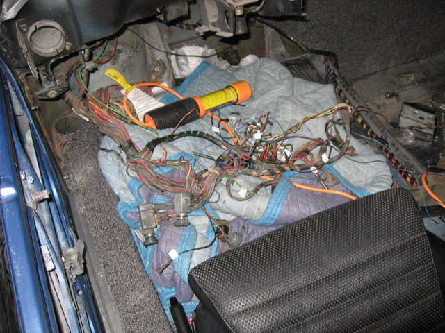

Here are a few photos of the dash frame, I suspect the biggest unknown is the wiring that goes to the fresh air slider controls, they were connected to a rheostat in the dash. Hopefully they're still long enough to get to where they need to be.

ahdoman
Kevin - That dash assembly setup is really bizarre and that's a big hole! If you're down this far you might consider just buying a whole new dash assembly from somebody who has some parts cars and just bolt it in. Ask them to include the heater/vent assembly as well.
Note; Bruce Stone probably has one and he's local. PM him; bdstone914.

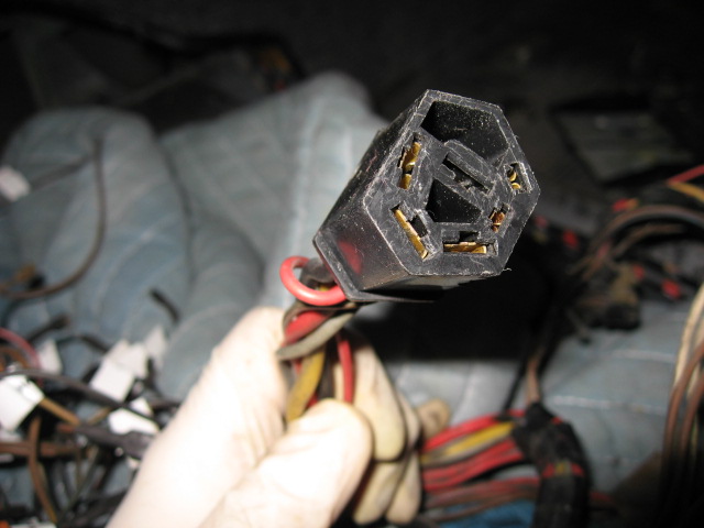

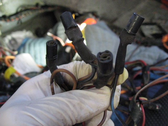

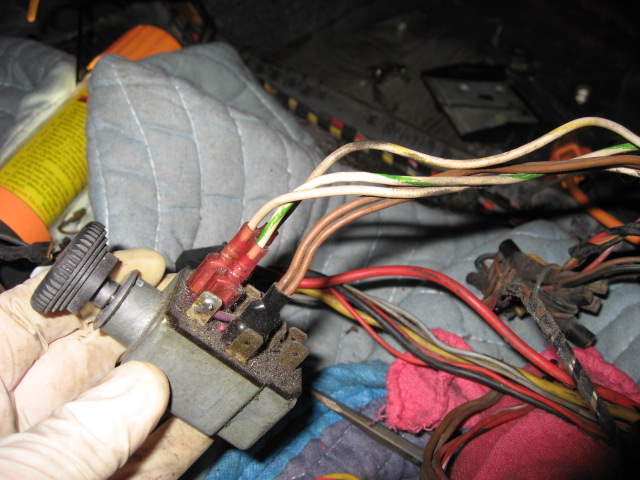

kconway
Can you identify these as original wires/connectors and what they go to?
#1
#2
#3
#1 - Goes to the Steering column
#2 - Dash lights (well, you have the sockets, without the lights)
#3 - A switch of sorts, a pic of the knob would help ...

#1 YES, thank you. Didn't notice that one when I pulled the column, just the two smaller connectors. Unfortunately, the hot wire does not stay seated in this connector. Got lucky as I noticed a big slice in the jacketing of the hot wire before I melted everything after reassembly!
#2. Okay, maybe there are dash lights on the fresh air controls? All other dash lights are accounted for.
#3 I suspect these go to the terminals on the fresh air sliders. This knob says "lights" but as i remember it I think they operated the fan for the defroster?
Aha. The fresh air fan is normally operated by the dash controls, so you won't need that switch anymore ...
And yes, the dash lights go to the dash controls ...
