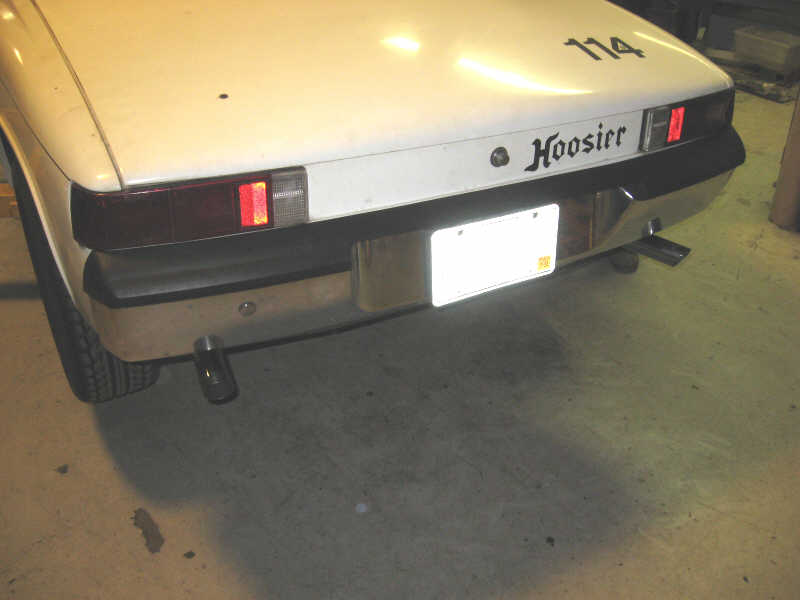

We just got this thing mounted and ready to go this morning. We started it up while E-man was here picking up a Christmas present for his car (clutch pulley adapter) a little while ago.
I'm going for a short ride before it gets any colder since we didn't have time to hook up the heating system yet.

Looks great! Is there any performance improvements or deficincies from it?
ChrisFoley
post Dec 23 2009, 02:58 PM
I am Tangerine Racing
Posts: 8,031
Joined: 29-January 03
From: Bolton, CT
Member No.: 209
QUOTE(Zimms @ Dec 23 2009, 03:32 PM) *
My Butt-o-meter says its better than factory but its no Tangerine Header. I (IMG:style_emoticons/default/wub.gif) my EVO. (IMG:style_emoticons/default/smile.gif)
I need to install an O2 bung, then drive around for a few days.
The sound is very different than what I'm used to. Not as loud, even at WOT but more resonant inside the car.

I checked with FedEx. I can deliver it to the west coast (LA to Seattle) for $70 shipping/handling/insurance, including the heat exchangers

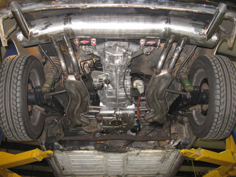

Ed, will you send it to my phone? Chris - how did you get that tranny so clean and sparkly?

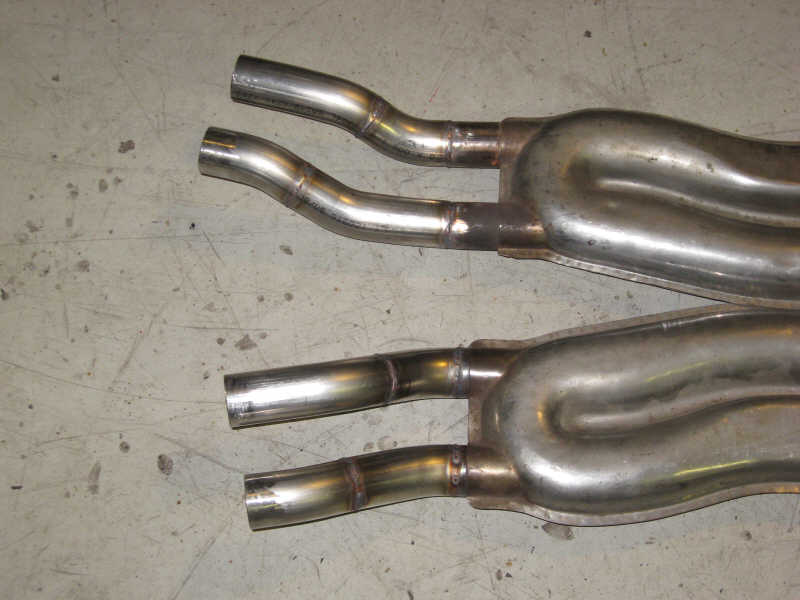

What is it?
Does it go onto 2.0 liter HE's or 1.7....for some reason I cant make it out...

QUOTE(Cevan @ Dec 23 2009, 07:28 PM) *
Elbow grease. (IMG:style_emoticons/default/biggrin.gif)
I fully rebuilt it a few weeks ago, including complete pinion depth and backlash adjustments.
QUOTE('r_towle')
What is it?
Its the new Tangerine EVO IV Silencer.
Yes it goes on either 2.0 or 1.7 HE's. The HE outlet ends are modified for the muffler.
