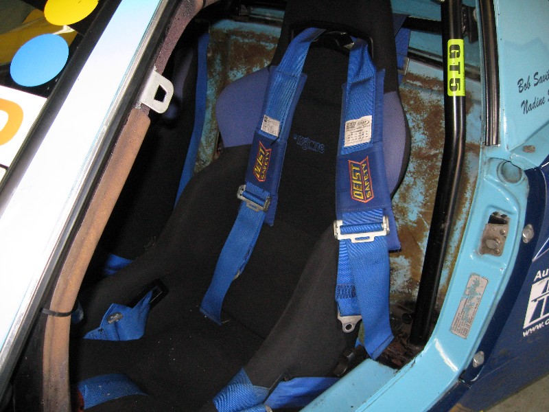

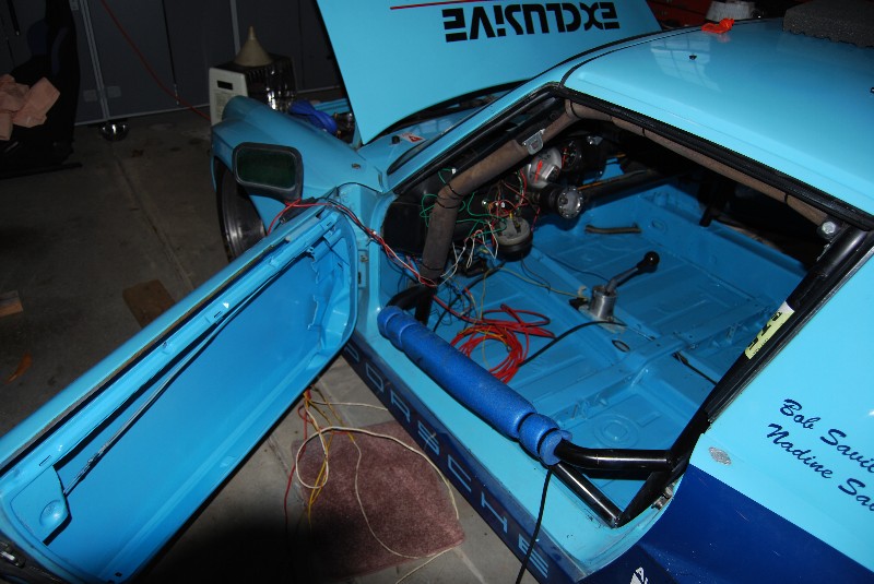

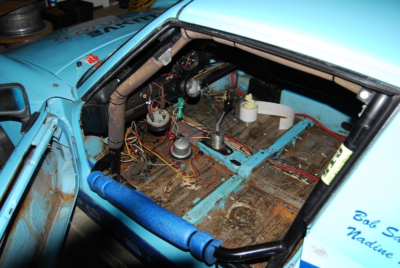

So I got to thinking....there are soooo many wires and stuff in a 914 that are not needed for a race car....not to mention the sound deadening 'tar' on the floors. Also, every time I took a picture of the inside of Papa Smurf, I realized how ugly it looked. I decided that one of my 2009/2010 winter projects is to scrape the floors, pull out all the wiring, cut all wire harness tabs, brackets, etc, and take out whatever is not necessary. Sounds easy when you're sitting around with a beer, or at the track.

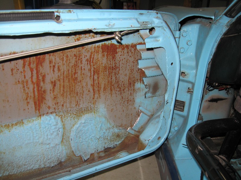

So, a few weeks ago I started. first picture is as it ended the 2009 track season: see the 'glue' on the firewall, and rust in the doors? You can also barely see how bad the floors look.

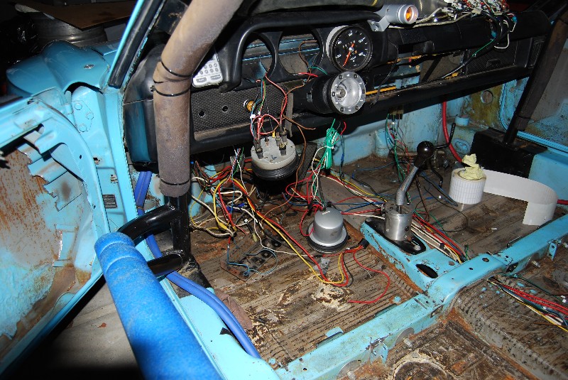

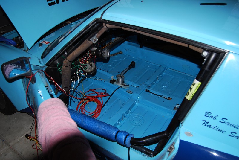

Now we strip out everything: (what a mess!!)

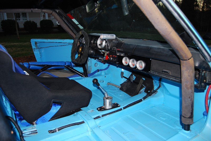

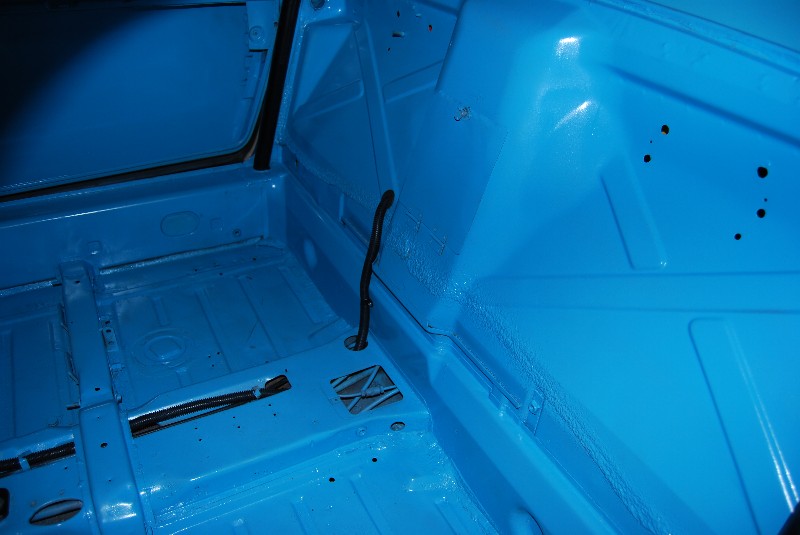

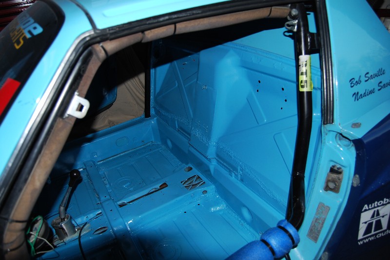

Here's where I am today, after painting the interior. Yes, it is the same color as the outside (Olympic Blue) - just looks darker in the pictures probably because of the flash in a dark garage (sorry, got side tracked for a little while with my posts)
Next up: new wires this coming weekend.

believe it or not...I had paint made up and put into spray cans. You can get it at any Keystone Automotive or I'm told Carquest will do it to. Figured it was the interior of a race car. Once seats are in, you won't see much of it anyway....

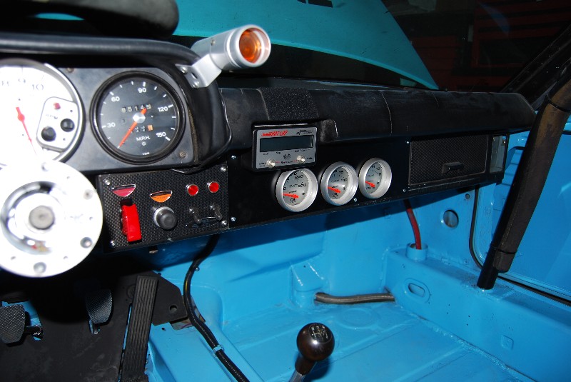

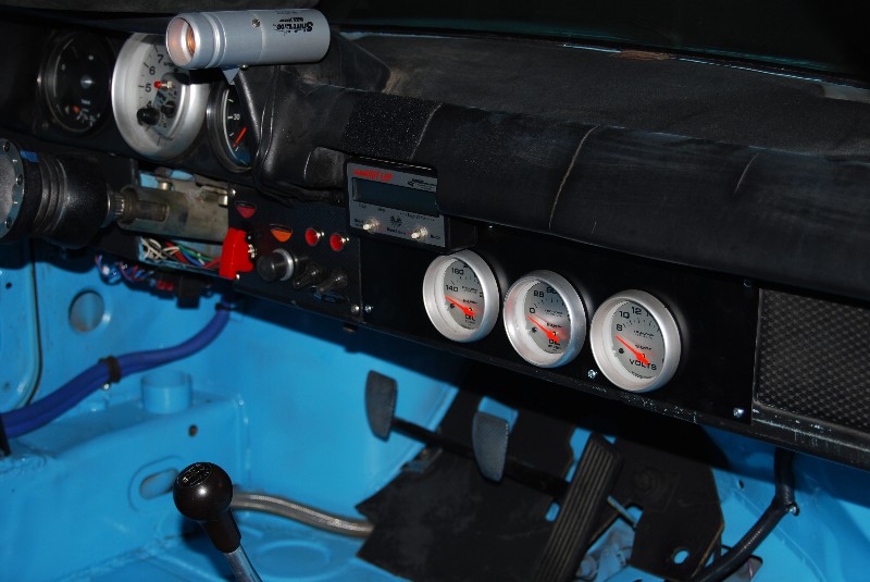

I am taking out some of the dash too, forgot to mention that. Can't figure out how to get the lower dash out without destroying it because of the roll cage in the way, and the vent ducts are still there. No reason to take the top of the dash off - doesn't weigh much and keeps it clean looking for now.
Putting in an ignition switch and button, guages are up on the dash in one of the pics, need a few switches for cool suit (currently and probably staying as the fog light switch you see left of steering wheel)

The interior came out very nice. Heck, if I had 'that kind of attitude' I would have just left is as-is for the interior. The point about spray cans is that I was not going to send it to a body shop and pay thousands of $$ for the interior to be painted.
I bought all new wires, not using any old stuff, weatherpack connectors, the ignition panel is carbon fiber, etc.
Papa gets very well taken care of.
the dash will be nice. Not shiny, but very clean and black.

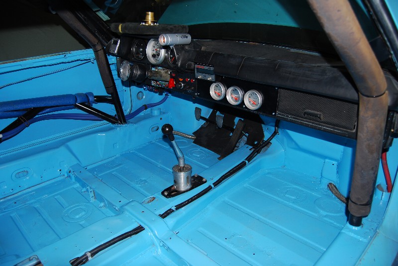

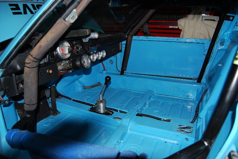

Interior and wiring are basically done:
naro914
post Jan 10 2010, 07:32 PM
Losing my mind...
Posts: 2,476
Joined: 26-May 06
From: Charlotte, NC
Member No.: 6,073
I still need to get the collar for the steering wheel on. the guys at Black Forest Racing are cutting it apart and welding/fabricating it so it doesn't have the key, turn or wiper stalk holes.
I ran the conduit up and into the engine bay from the passenger compartment, instead of going down, under the engine, then back up. Much easier to work with if I have to add wire for something.
Looks nice and clean inside now.

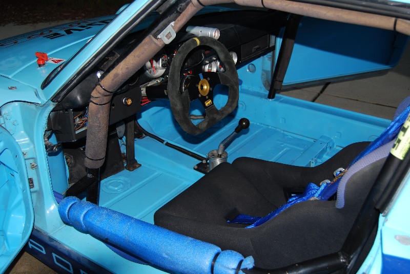

finished!
OK, still got to do new roll bar padding, but he's ready to run!
going to the track in a couple weeks. Still have some minor stuff to do - brake pads, change oil, etc. but nothing to take pictures of.. (IMG:style_emoticons/default/smile.gif)
