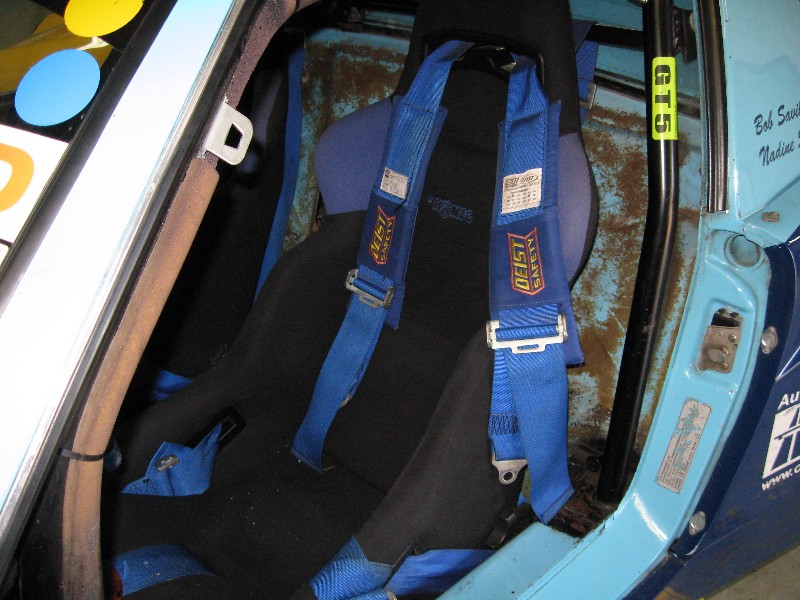

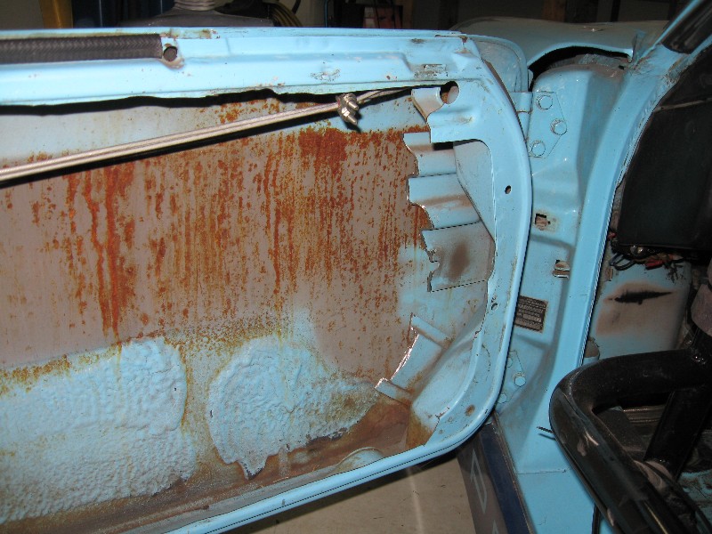

So, a few weeks ago I started. first picture is as it ended the 2009 track season: see the 'glue' on the firewall, and rust in the doors? You can also barely see how bad the floors look.

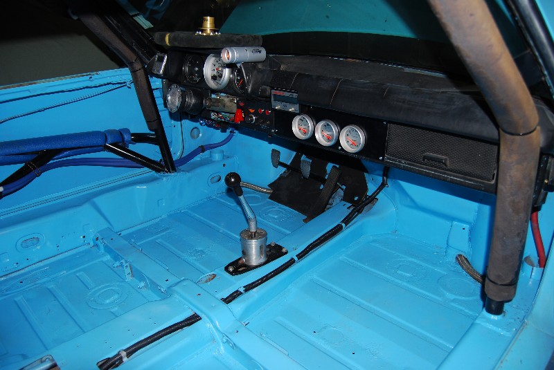

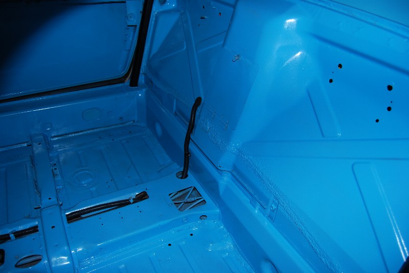

Here's where I am today, after painting the interior. Yes, it is the same color as the outside (Olympic Blue) - just looks darker in the pictures probably because of the flash in a dark garage (sorry, got side tracked for a little while with my posts)
Next up: new wires this coming weekend.

Looks nice! What'd you shoot it with? Also, that's a lot of dashboard for a race car...
naro914
believe it or not...I had paint made up and put into spray cans. You can get it at any Keystone Automotive or I'm told Carquest will do it to. Figured it was the interior of a race car. Once seats are in, you won't see much of it anyway....
I am taking out some of the dash too, forgot to mention that. Can't figure out how to get the lower dash out without destroying it because of the roll cage in the way, and the vent ducts are still there. No reason to take the top of the dash off - doesn't weigh much and keeps it clean looking for now.
Putting in an ignition switch and button, guages are up on the dash in one of the pics, need a few switches for cool suit (currently and probably staying as the fog light switch you see left of steering wheel)

The interior came out very nice. Heck, if I had 'that kind of attitude' I would have just left is as-is for the interior. The point about spray cans is that I was not going to send it to a body shop and pay thousands of $$ for the interior to be painted.
I bought all new wires, not using any old stuff, weatherpack connectors, the ignition panel is carbon fiber, etc.
Papa gets very well taken care of.
the dash will be nice. Not shiny, but very clean and black.

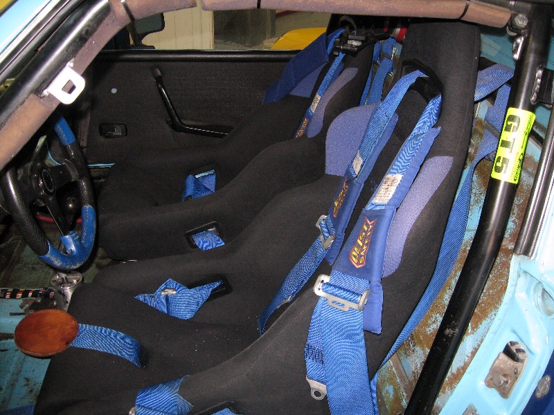

Interior and wiring are basically done:
naro914
I still need to get the collar for the steering wheel on. the guys at Black Forest Racing are cutting it apart and welding/fabricating it so it doesn't have the key, turn or wiper stalk holes.
I ran the conduit up and into the engine bay from the passenger compartment, instead of going down, under the engine, then back up. Much easier to work with if I have to add wire for something.
Looks nice and clean inside now.

finished!
OK, still got to do new roll bar padding, but he's ready to run!
