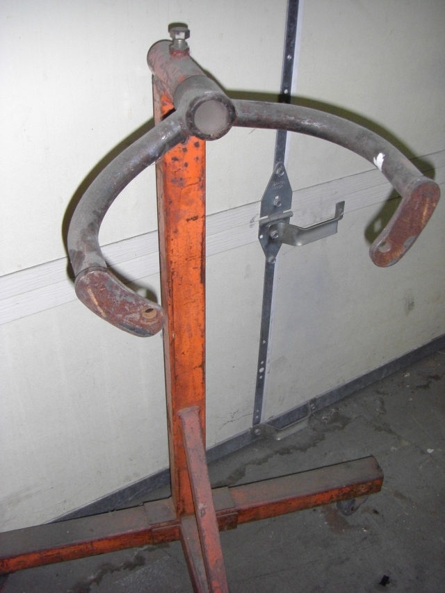

swood
post Jan 1 2010, 07:19 PM
Posts: 1,839
Joined: 6-February 03
From: Strong Beach
Member No.: 251
Will your adapter mount to this DR.? the holes are about 8.5" apart.

QUOTE(swood @ Jan 1 2010, 08:19 PM) *
I have built 2 motors on a stand exactly like that one. its not the best out there, to be sure. But no adapter is needed.
