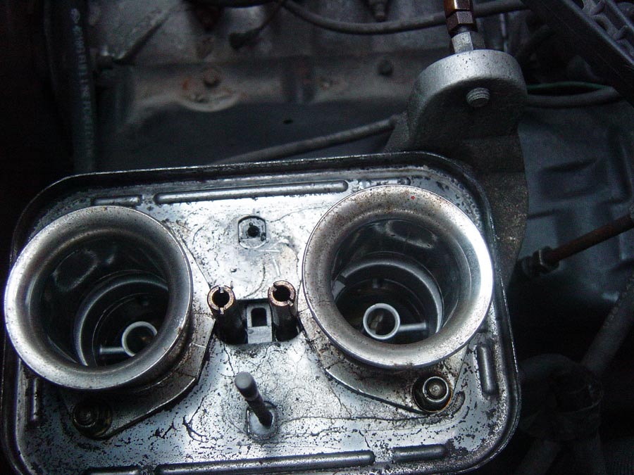

Thanks for the tips people, much appreciated!! Now, when I order these parts are they the same for all 40mm twin Dellortos? Are there different models like the Webers? I bought my Dells so long ago new (from Dave S at GPR) that I forgot what they are, all I remember is they are 40mm.
Here are some pictures

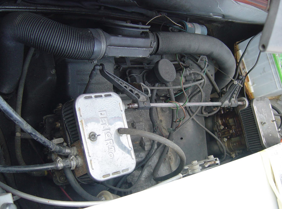

Another picture here too I forgot to post...it looks bad in the engine compartment but should be much better when spring arrives hopefully and I have a bunch of parts on order too.

As long as you are ordering from CB or ACE they are all "the same" (DCNF). There are a few different varieties, but they would not be a down draft and running on your car.
ME733
post Jan 8 2010, 10:12 AM
Posts: 842
Joined: 25-June 08
From: Atlanta Ga.
Member No.: 9,209
(IMG:style_emoticons/default/popcorn[1].gif) ...well in your particular case, you should remove ONE CARBURATOR, and inspect it for size and nominclature. designation may be stamped in the body or at the base, near the mounting flanges. Measure the THROTTLE BORE, butterfly, so you know what you,ve got. BEFORE YOU ORDER PARTS. they are not DCNF. they are IDF.(design type) downdraft carburators. (IMG:style_emoticons/default/popcorn[1].gif) murray
yeahmag
post Jan 8 2010, 10:29 AM
Posts: 2,485
Joined: 18-April 05
From: Pasadena, CA
Member No.: 3,946
Sorry... I have no idea why I said that. Shouldn't touch a computer before coffee.
DRLA is what I meant to say.

I notice your air cleaners are short and you have velocity stacks so you need check to see if you have enough clearance between the top of the velocity stacks and the air cleaner tops you need a minimum of 34 mm.
nsr-jamie
post Jan 11 2010, 08:37 AM
914 guy in Japan
Posts: 1,182
Joined: 7-November 07
From: Nagoya, Japan
Member No.: 8,305
Hi, thanks...that helps a bit. I will be going with slightly taller filters so issues with clearance of the velocity stacks, they are the stock ones anyway.
