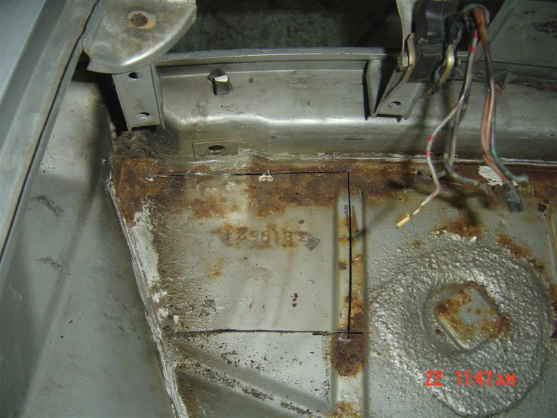

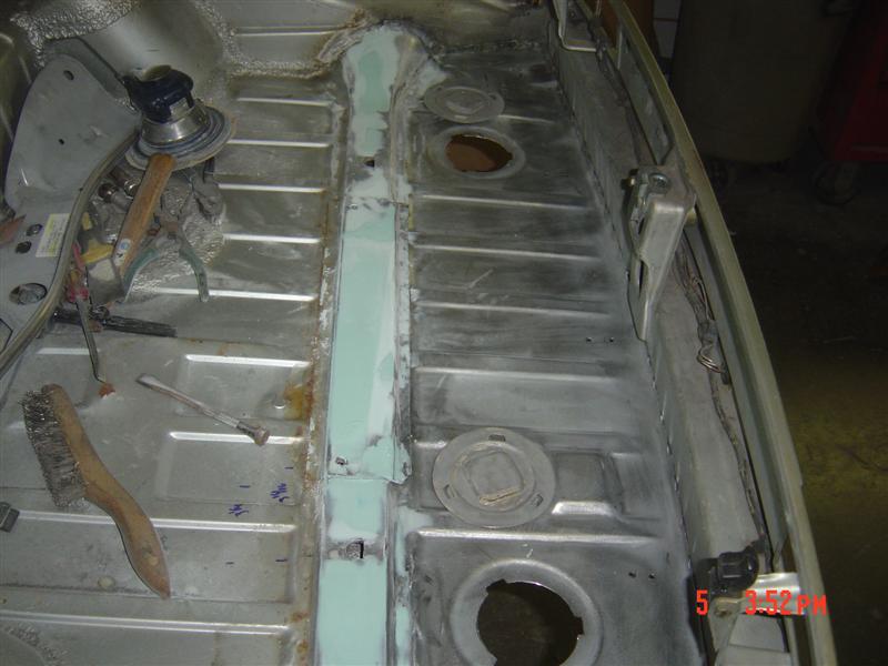

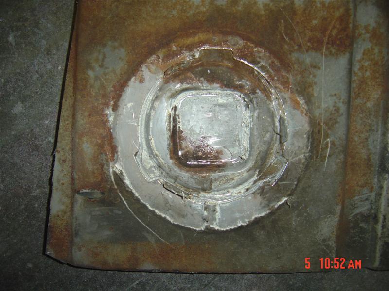

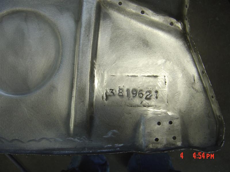

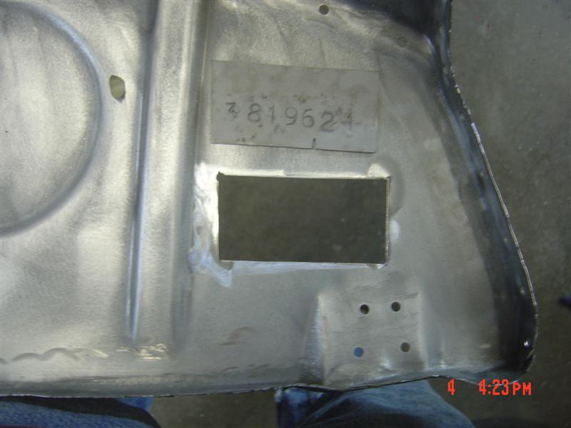

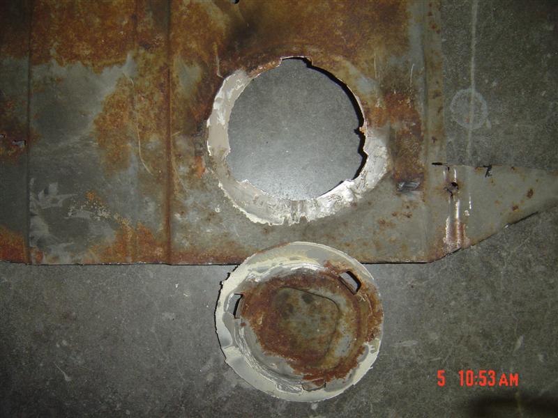

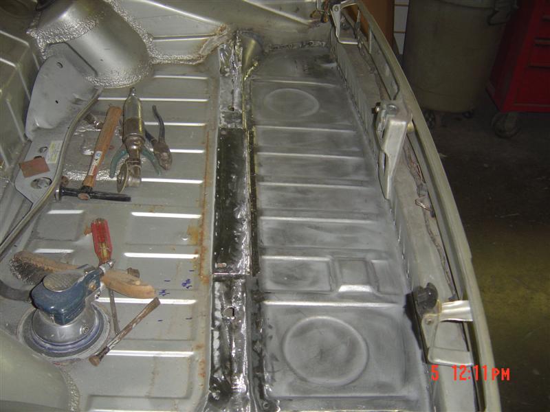

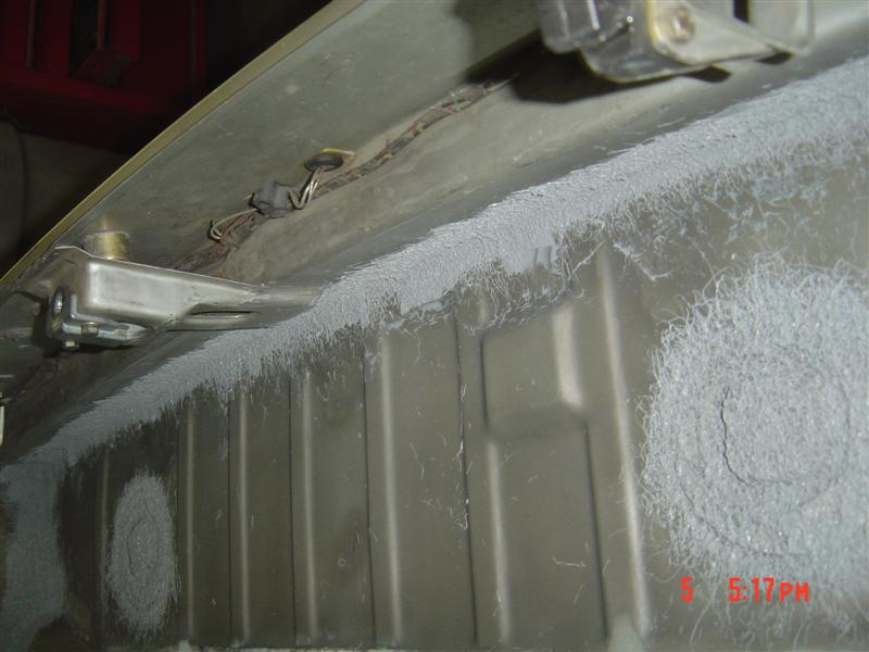

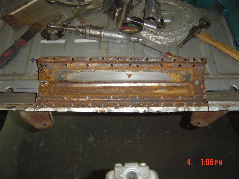

I was doing a rear trunk yesterday and today, and knowing how everyone likes to see every sqaure inch of a naked teener (IMG:style_emoticons/default/unsure.gif) I shot some pics of a trunk cut apart. I forgot to take pics of the old trunk cut out before welding in the new, but I figured the " plugs " were the more interesting prts anyway (IMG:style_emoticons/default/confused24.gif) Also note the replacemetn panels do not have the holes cut out. If you don;t care about the originality, I personally would leave them be, one less place tro trap water (IMG:style_emoticons/default/blink.gif) I went ahead and put these in because I wanted to find out exactly how much more time it would take to do them. Now I need one of the expensive seam seal guns to get the finish just right My cheapo 150.00 gun wouldn't get it quite perfect (IMG:style_emoticons/default/dry.gif) Coat of selaer tomorrow and I move on to the next hole....hell hole.........

Oh and don't forget to swap your numbers over (IMG:style_emoticons/default/drunk.gif)

BTW does anyone know how the factory originally applied the seam sealer ? It looks like it was sprayed, but I find it hard to beleive a " standard " gun could lay it out so damn thick. (IMG:style_emoticons/default/confused24.gif)
Van
post Jan 5 2010, 09:11 PM
Posts: 199
Joined: 15-January 08
From: Hyde Park, NY
Member No.: 8,571
QUOTE(scotty b @ Jan 5 2010, 06:36 PM) *
In that 356 video, I seem to remember them dipping long brushes into a vat of the stuff and then spreading/brushing it on. I've certainly taken some off that look smeared on with a finger...

I was able to match the factory finish with a Wurth gun but I wasted a lot, a lot of $35.00 a tube Wurth seam sealer just spraying it on cardboard to practice. We billed the extra seam sealer to the job, insurance paid, with a fight. I always liked fighting with them anyway.

Here ya go....
Seam sealing the German factory way.....
It's about 8 minutes into the video...
http://www.youtube.com/user/johannes914#p/...D/0/LQBrQ5qd5w8

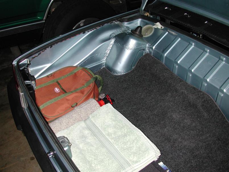

Here's my junk.
