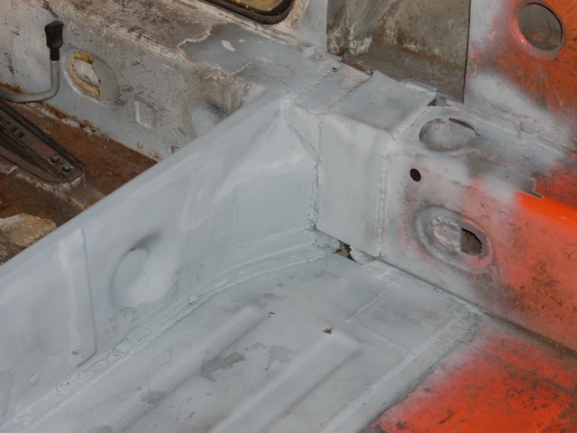

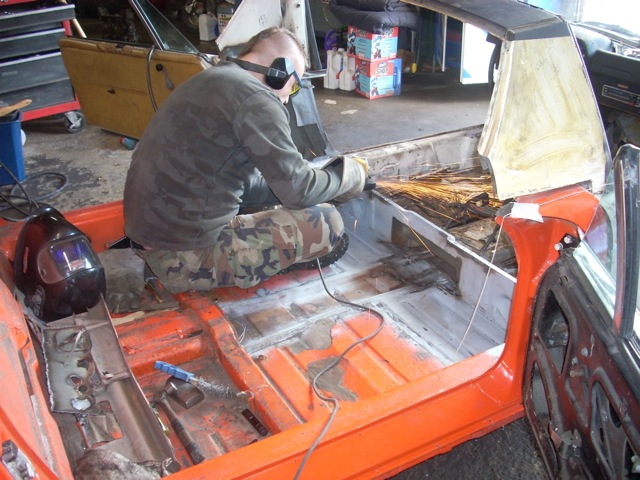

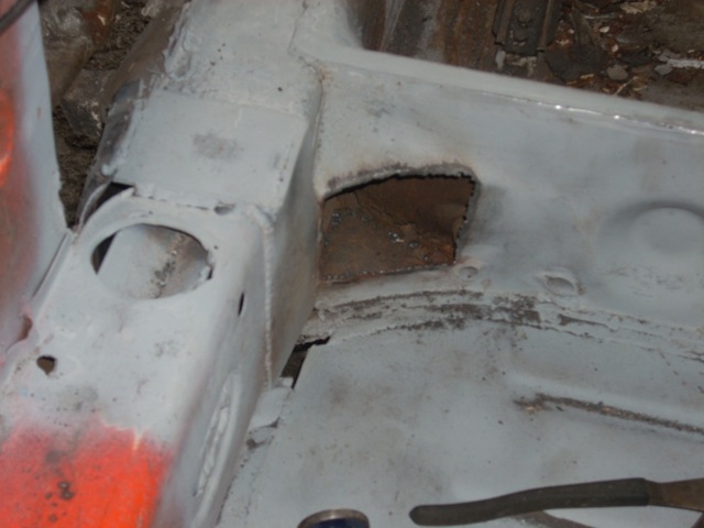

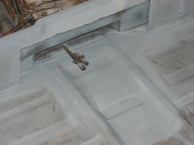

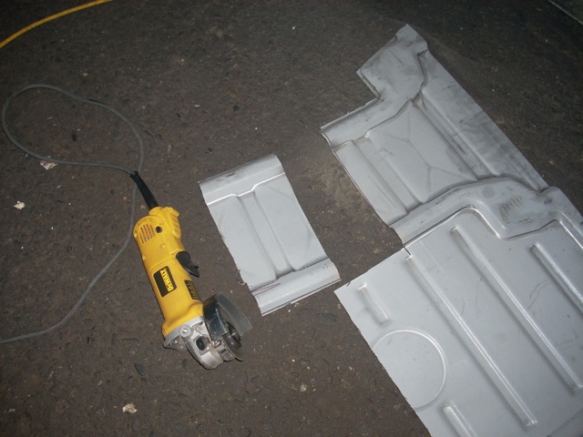

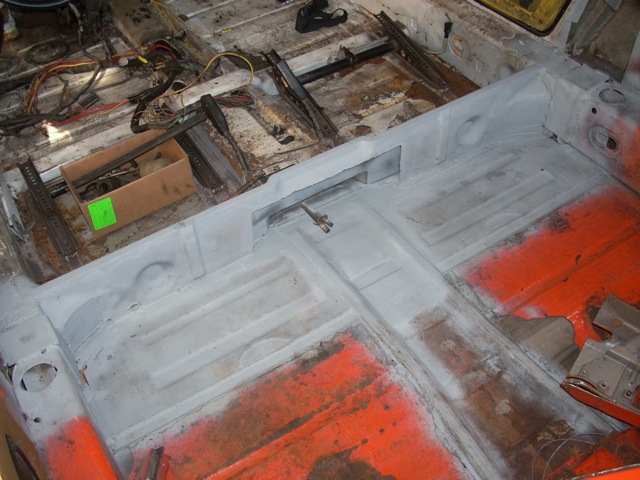

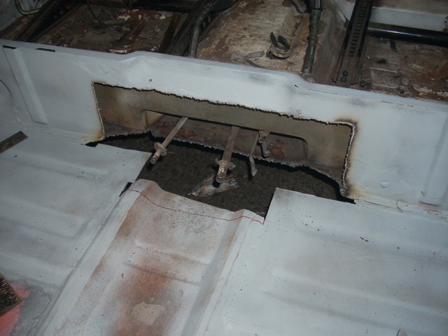

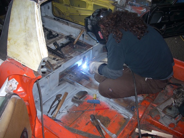

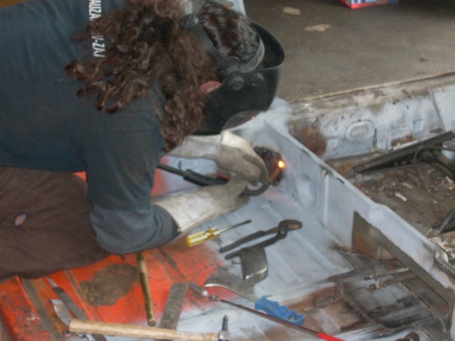

Today we finished the rear floorpan and did some cleanup on the crossmember.
There was a lot of fab-work involved and it took the whole day, but it was well worth it. The transition between the rear floorpan and the front floorpan turned out really nice and it'll enable us to do a clean install of the custom center tunnel piece needed.
The hole:
Restoration Design floor pan used as a donor for patches:
McMark welding:
Old heater tube outlets removed:
Patch welded in:
Me grinding down some of the weld on the crossmember:
Cleaned up and primered:
Center portion finished:
And the final shot, voila!

Are you going to have front and rear heat? Heat is always nice...

VW gas heater may be in order. The floor looks nice! Strange without the rear tunnel.

There's no connection between the front and rear heater tubes. We *may* be able to slide in some generic home depot plastic tube ...
But that still would only mean heat to the front. Which isn't that much of a deal, considering that there's no divider between the front and rear ...

But since the heater tube aren't connected, the whole long becomes a heat-distribution-box. With the oval outlets being the heater vents. (IMG:style_emoticons/default/cool.gif) An Eberspacher would be a GREAT addition if we can find a place to mount it. Defrost is always a problem on cold mornings.

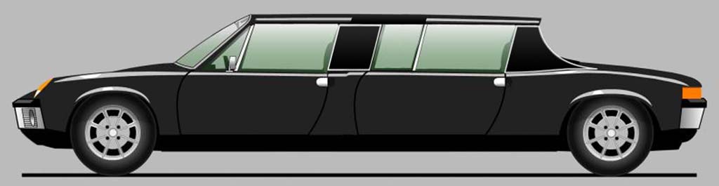

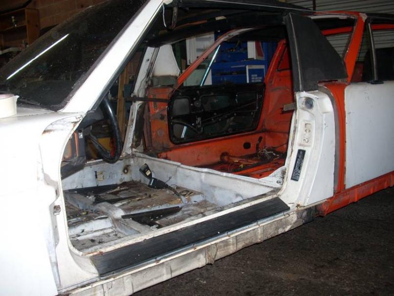

This mockup by Johannes is pretty close to what we have in mind. As you can see in the second image below, the center section between the two cars is a bit wider as in the mockup.
I really like the look of the small rectangular side window and the rectangular b-pillar. It'll flow nicely with the lines.
The side window will be the full width of the original triangle window.
One problem area will be the transition between the two cars. The rear of the front door is actually a good 1" lower than the front of the rear door. This part will be tricky.
We also figured out how to have a straight roofline and still be able to retain both targa tops. We even figured out how to fit two tops in the rear trunk without cutting the trunk!
(IMG:style_emoticons/default/popcorn[1].gif) Andy

Quick mockup of what we have in mind ...
