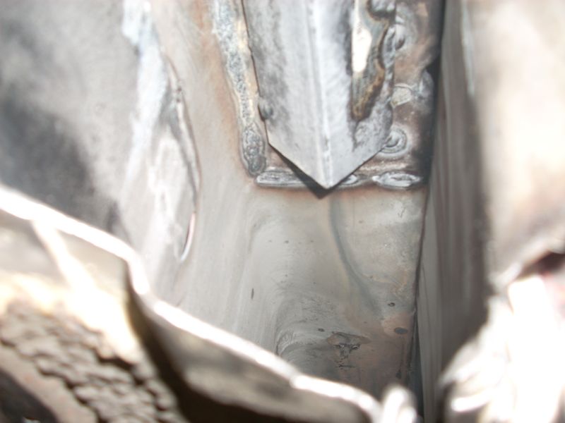

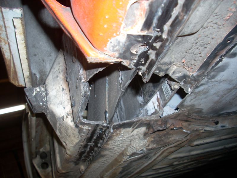

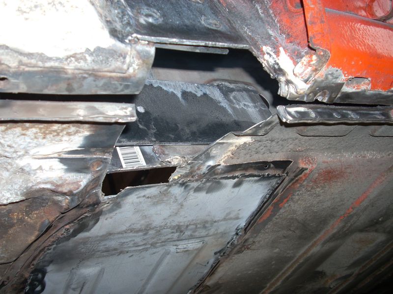

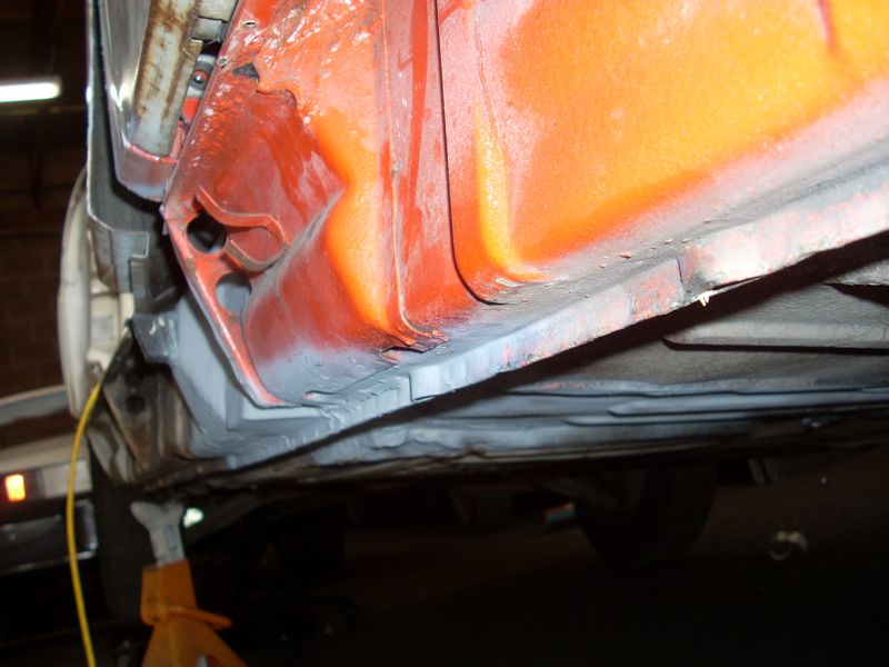

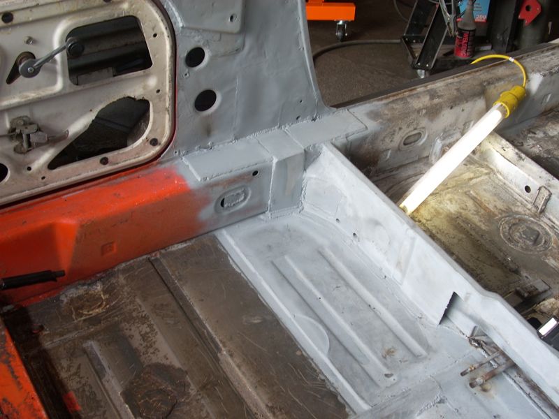

Another great day in Limo Land ™ (IMG:style_emoticons/default/piratenanner.gif)
We got the drivers side frame work finished. Yeah! (IMG:style_emoticons/default/welder.gif)
Here's a before shot of the glory hole:
View towards the rear:
View towards the front:
And straight up:
post Apr 10 2010, 09:07 PM
Post #386
Resident German
Posts: 42,364
Joined: 21-January 03
From: Oakland, Kalifornia
Member No.: 179

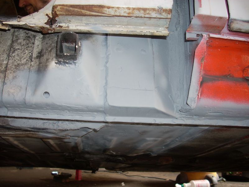

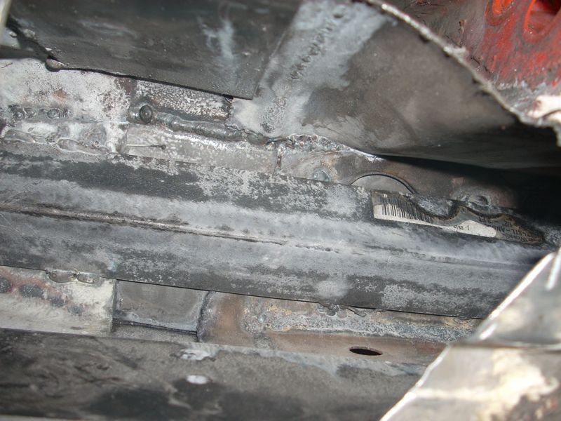

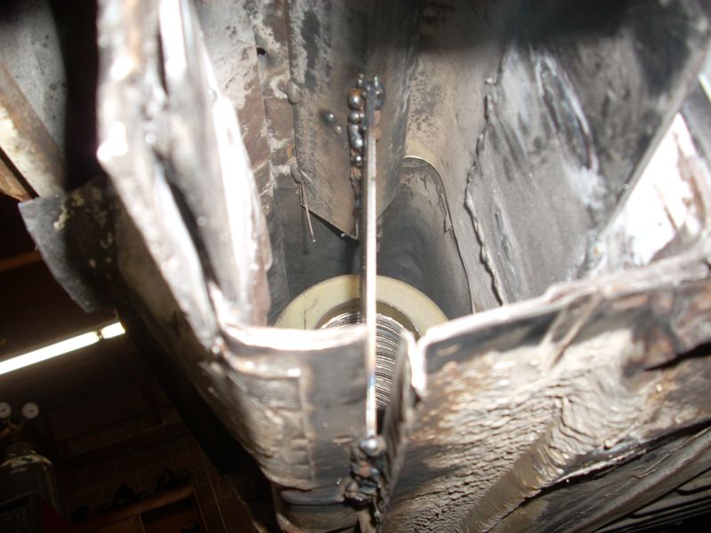

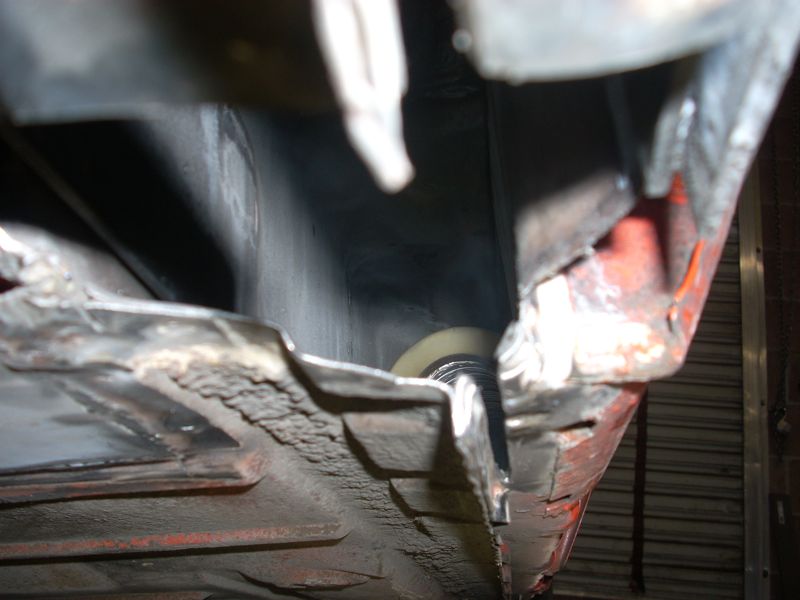

We cut a groove along the bottom of the long and added vertical reinforcement plates that were welded to the angle iron on top and butt-welded to the bottom.
We added 5 plates over a total length of about 16 inches. (IMG:style_emoticons/default/sawzall-smiley.gif) (IMG:style_emoticons/default/welder.gif)
McMark welding upside-down:
One plate in:
All 5 in:

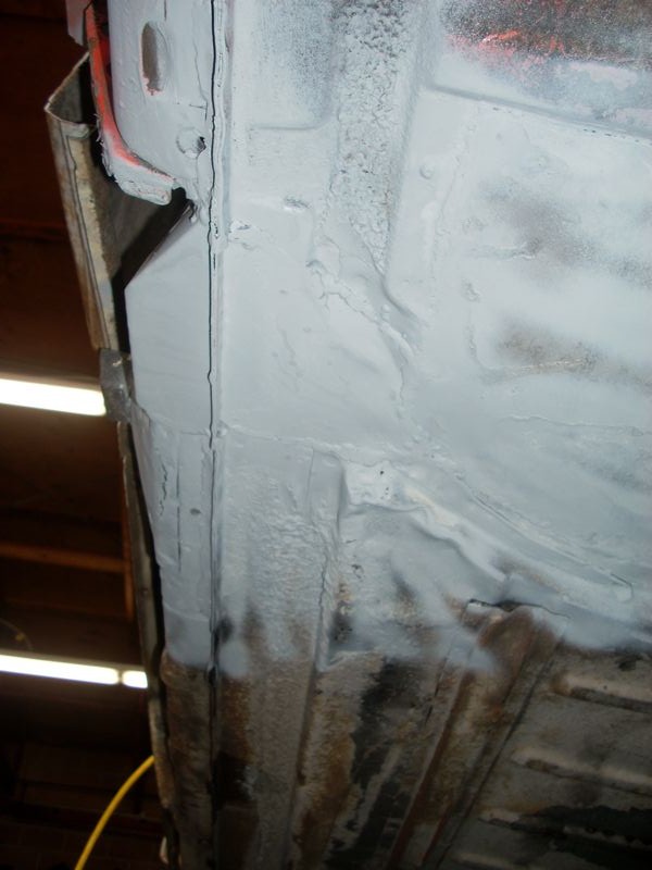

All cleaned up and in primer ...
And closed up from the inside as well:

Mmmm goober welds.
Gotta crank up the heat when welding 1/8" steel! (doesnt help that your welding upside down...)
Awesome progress, Thats the hard and critical part right there... Good final result!

Turned up all the way and there was no room for the 'torch'. (IMG:style_emoticons/default/rolleyes.gif)
We'll be working next Sat if you wanna show me how it's done. (IMG:style_emoticons/default/tongue.gif)

QUOTE(McMark @ Apr 10 2010, 09:49 PM) *
The only way to get good welds in there would have been by cutting more of the long out to get better access.
There was barely enough room for the torch and no way to get a good angle.
(IMG:style_emoticons/default/popcorn[1].gif) Andy
What welder? What wire?
Try turning down your wire speed?
I weld the thick 1/8" stuff all the time w/ my Lincoln 135 on .030 wire. D setting ~ 3.5 wire speed. However I know a lot of the body shops use .023 wire as its better on 18 and 20 guage.
But then again, I know how hard it is to weld in a tight space upside down... Literally impossibly.. Put the stick up there, hold the trigger, and hope for the best..
Now you're gettin' it. I coulda put a nice clean bead on it if it were laying in front of me. No problem. Upside down welding through a 8" hole, nope. Besides, the car was already stable, this extra metal is just peace-of-mind metal.

How about cutting a few holes on the side of the longs and welding from there?
post Apr 11 2010, 03:32 PM
Post #400
Resident German
Posts: 42,364
Member No.: 179
QUOTE(Krieger914 @ Apr 11 2010, 02:16 PM) *
The welds are solid. No need to make them look pretty ...
