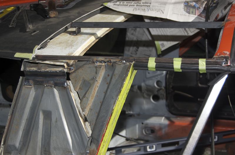

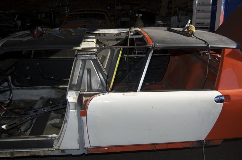

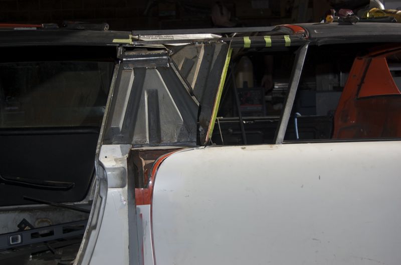

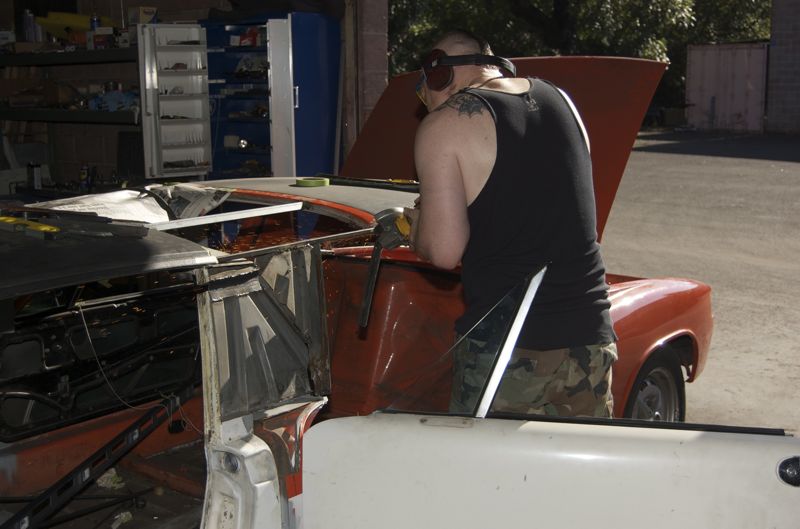

Here are a few pics. I got off to a late start due to me signing the lease to my new house this AM.
We did some more work on the roof-line and the sail-panel/side-window area today.
Unfortunately, the front angle and rear angle of a 914 side-window are not the same. We came up with a compromise where the center sail panel will be slightly wider on top and the front rectangular window on the rear door will also be slightly wider on top.
That will take care of the difference in angle.
Below are the pics of the guts of the new sail-panel ...
(IMG:style_emoticons/default/popcorn[1].gif) Andy

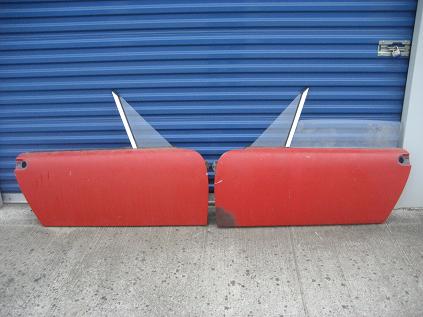

Will be delivering two doors this Saturday . . .
