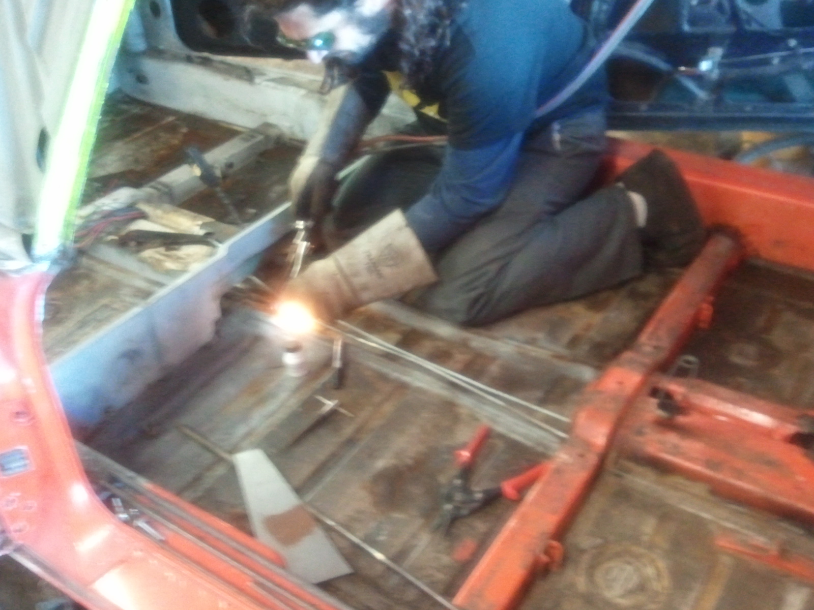

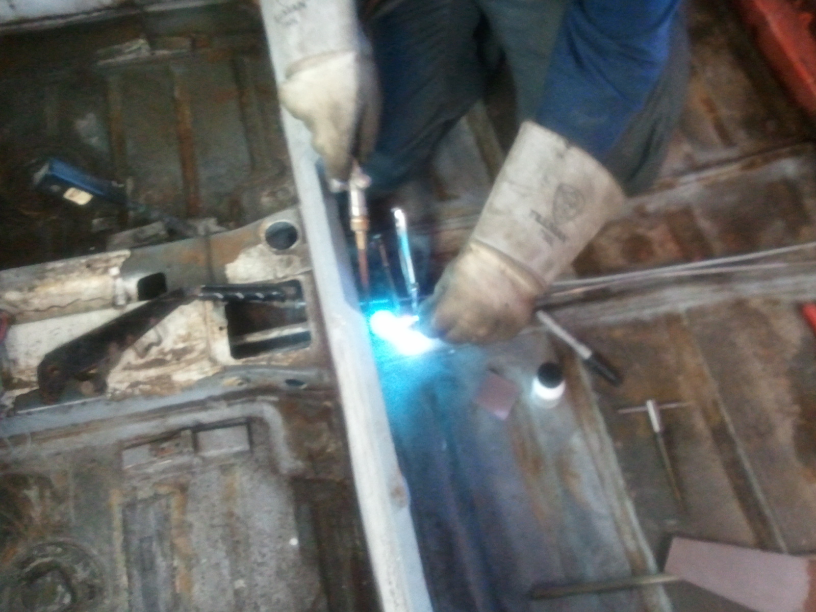

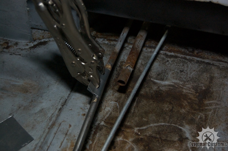

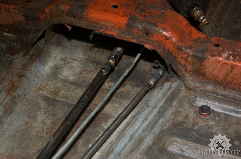

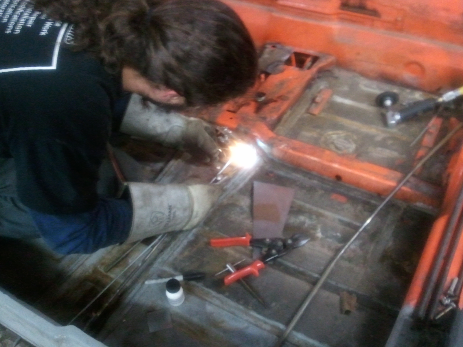

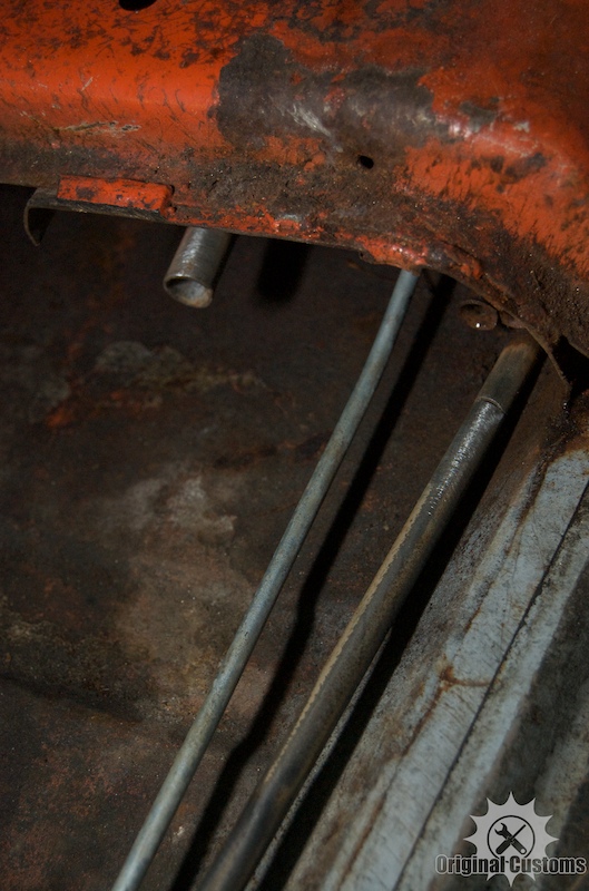

Got some more work done on the limo today. We halted progress on the body and started focusing on making the thing move under its own power. No sense in getting the body perfect, if it doesn't drive well.
So we did some brainstorming, ate some pizza, and then extended the clutch tube and throttle tube. We used the tube from our parts car, so it's a perfect size match. We then clamped a section of sheet metal around the junction and brazed the whole thing together. This'll be plenty strong.
Now we just need to order custom length cables from Terry Cable and we can check these two off our list.

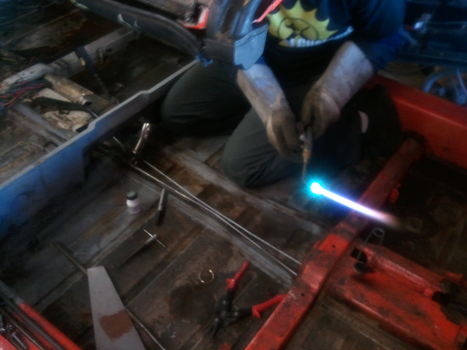

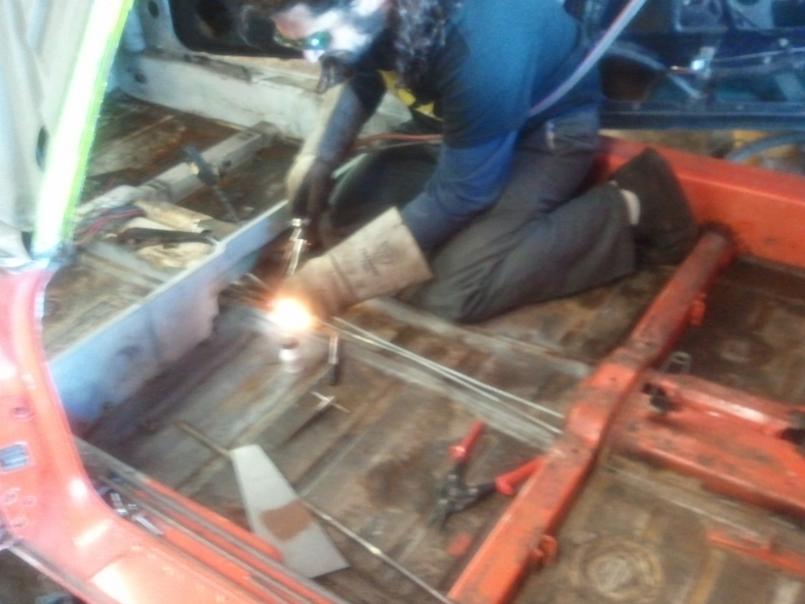

I got nothing except these pics of McMark playing with his torch ... (IMG:style_emoticons/default/happy11.gif)

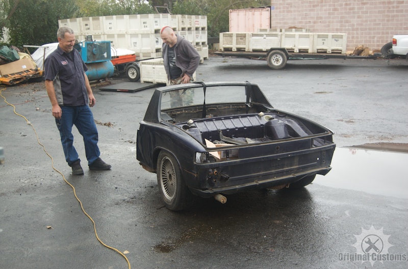

We cut the parts car in half and removed the engine and transmission. We'll be using the transmission in the limo.

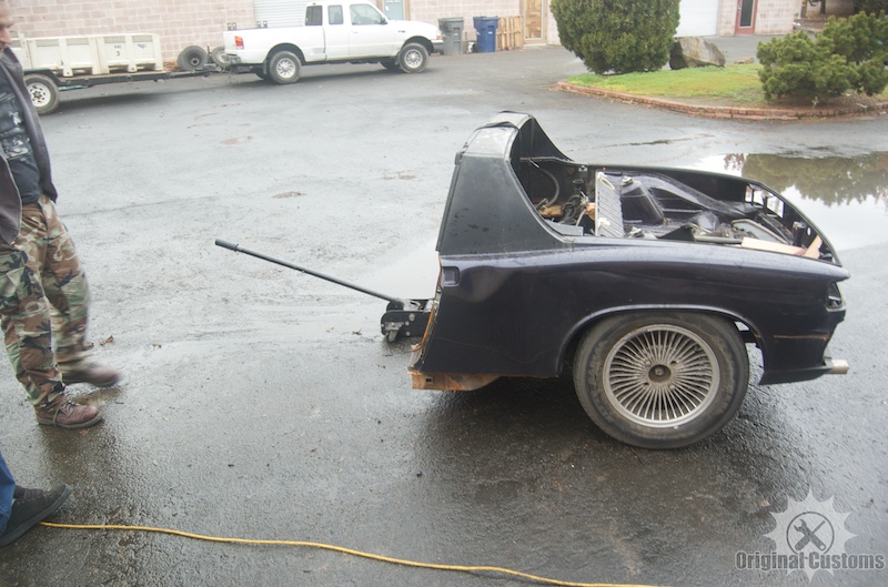

If anyone wants to build a 914 trailer, this is your chance! Otherwise this rear end will be cut into pieces ...

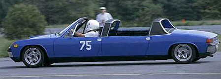

I think I didn't see this pic in any of the 28 pages of this thread.
I couldn't find too much info on this or any other pics, but it is indeed a 914 limo, looks like adriatic blue. For your inspiration (IMG:style_emoticons/default/smile.gif) :
(IMG:http://www.914world.com/bbs2/uploads_offsite/my.net-link.net-11782-1291664448.1.jpg)
Nope.
You didn't see this pic in this thread here because that image is a photoshop mockup i did about 6 years ago ...
