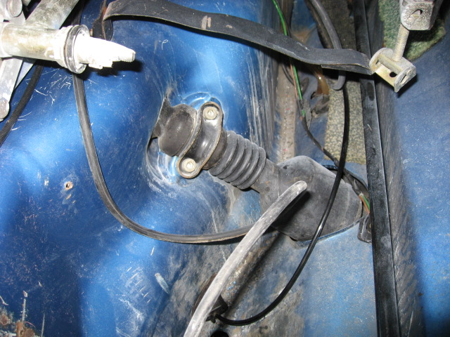

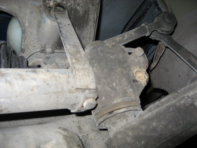

kconway
post Jan 10 2010, 08:39 PM
Posts: 1,347
Joined: 6-December 04
From: Monrovia, CA
Member No.: 3,231
I want to take the rack out with the the crossmember and all.
Does this come loose?
It's just floating...

Take out the two allen head bolts that hold the steering shaft to the body.
Its a tough angle to do it how you are attempting it but if you pull down and forward it should come loose. Right now the two allen head bolts are jambing you up.

I agree with Rich. Pop the tie rod ends, remove the 2 bolts that hold the steering rack to the crossmember and drop the front end. Then remove the rack.
Installation is the opposite. Replace the rack, then replace the front suspension.

Sucess! By removing the two allen head bolts that hold the steering shaft to the body allowed the whole suspension to come down without popping the tie rod ends. Not positive that is what did it or whacking on the tie rod to try to free it did. (IMG:style_emoticons/default/piratenanner.gif)
Thanks for the help!
