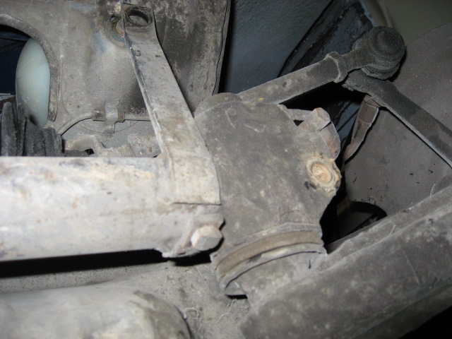

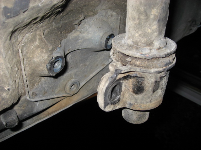

I want to take the rack out with the the crossmember and all.
Does this come loose?
Click to view attachmentIt's just floating...
Click to view attachmentClick to view attachment
r_towle
Jan 10 2010, 08:42 PM
Take out the two allen head bolts that hold the steering shaft to the body.
Its a tough angle to do it how you are attempting it but if you pull down and forward it should come loose. Right now the two allen head bolts are jambing you up.

Spoke
Jan 10 2010, 08:43 PM
I agree with Rich. Pop the tie rod ends, remove the 2 bolts that hold the steering rack to the crossmember and drop the front end. Then remove the rack.

kconway
Jan 10 2010, 09:53 PM
Sucess! By removing the two allen head bolts that hold the steering shaft to the body allowed the whole suspension to come down without popping the tie rod ends. Not positive that is what did it or whacking on the tie rod to try to free it did.
