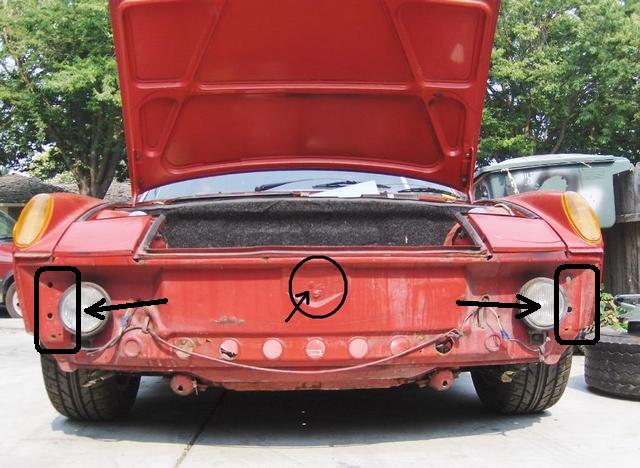

I have the answer for this. Ok, Remove the outer bumper bolts from the inside of the wheel wells, pop out the little rubber/plastic plug. Look through the hole. Insert a scew driver and POP! Then disconnect the cable and inbolt the handle from under the dash. (IMG:style_emoticons/default/welcome.png)
Oh, BTW: I stole this photo from Paul off his suby conversion photo link. Thanks Paul!
