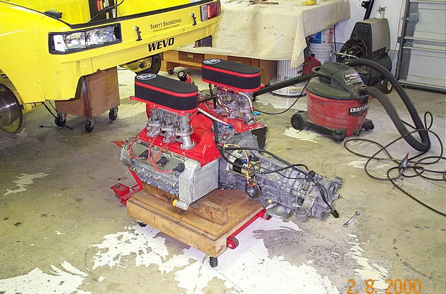

They look like this, and you can raise them to work on your engine. EASY! NOTHING simpler.
