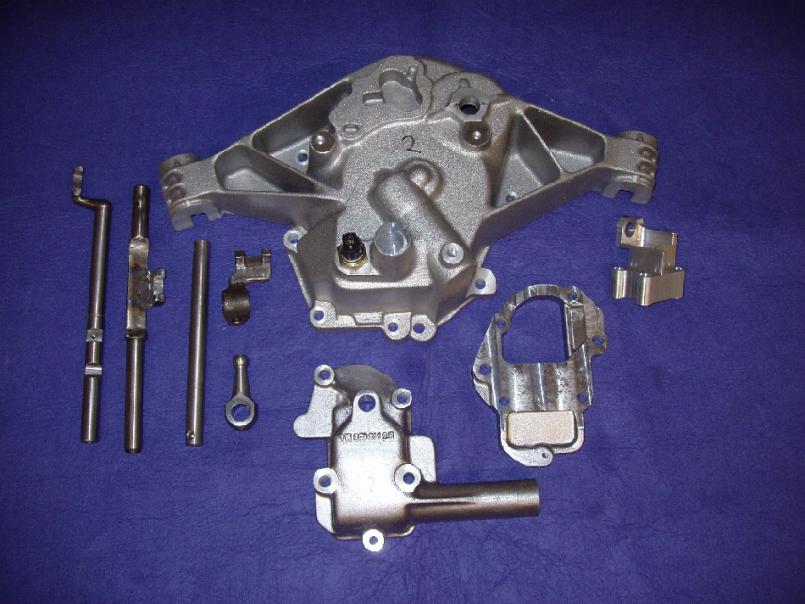

Hi,

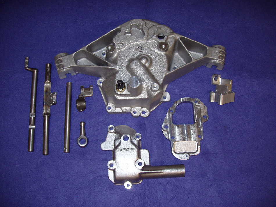

could do the housings first. Will start the external order tomorrow. Housings finnished now. Look at pictures.
@Turboman: if you used my shifter there´s no need to make such a shift gate at all. My shifter has three independant layers and there´s reall no need to do such thing.
Martin

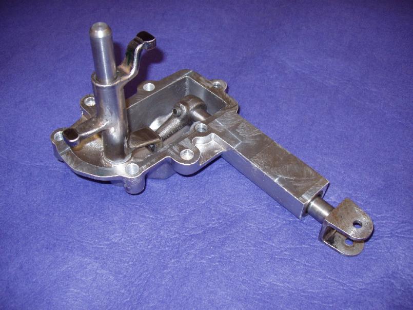

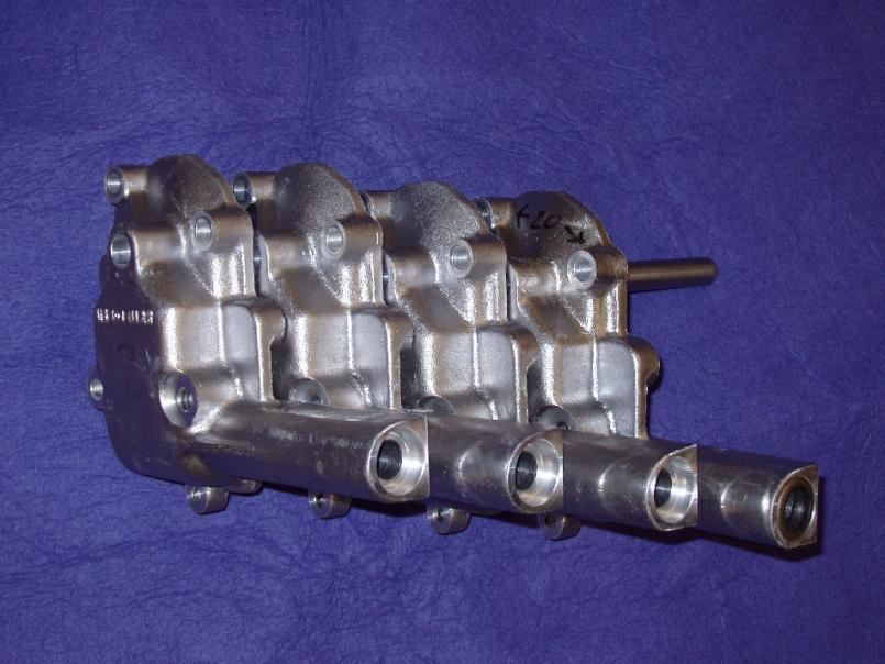

another picture:

Hi altogether,

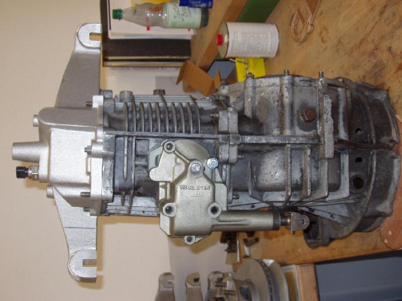

am nearly finnished now with all parts. Received further parts from the turning workshop (ballhead-lever, shiftrod). Only thing left still is the intermediate plate of the shift housing. We started making clamping fixture yesterday and I can probably start milling on Monday.
Mounted an old magnesium case 915 gearbox with my parts. Used the original 916 shift housing as my intermediate plates are still not finnished. Only made one adjustment of the shiftrods inside and the gearbox shifted really brilliant.
Will make some more pictures of the mounted unit and show you (didn´t have my digicam with me when I was in the workshop yesterday).

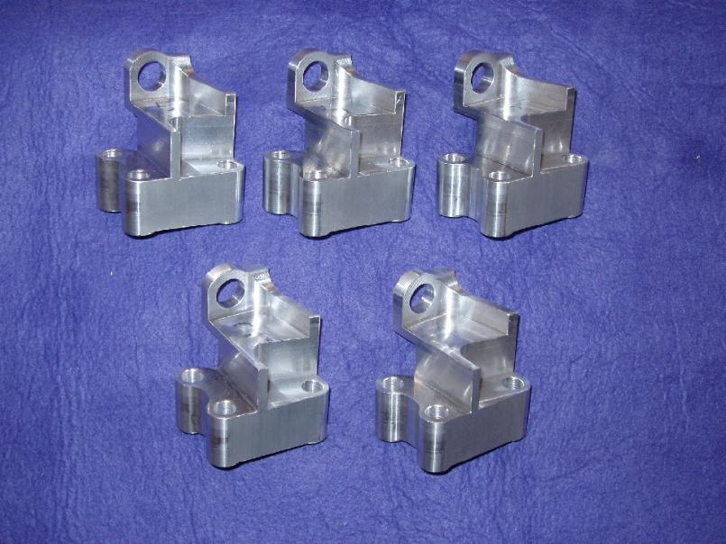

We made a further and even better batch of these bearing supports that have to be mounted into the gearbox. They are milled out of a block of billet aluminium. Pictures to follow also.
By mid of next week all parts will be done. Only issue then is the mechanical speedo drive. Will be important for those that will use the old magnesium case 915 gearbox. That will be the very final part.
Will keep you informed and post further pictures.

here are the new bearing supports made from billet aluminium. Price seems to be wright. Currency is 1:1,37 about currently.
Martin

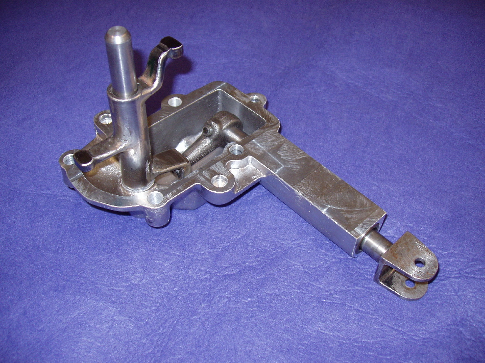

Hi Ron and all of you:
it´s done. Today milled the intermediate plates. See pictures. I know of the prices of the others. I think they´re much too high. Might be that I will have to increase the price for the version with mechanical speedo drive a little, but it was my aim to offer this kit at a reasonable price.
Martin

QUOTE(bugat5speed @ Mar 15 2010, 11:08 AM) *
Martin
Martin,
What's the little black switch in the housing for- a back up light?
Looks great!

@0396: it´s the switch for the reverse gear light (back up light)
