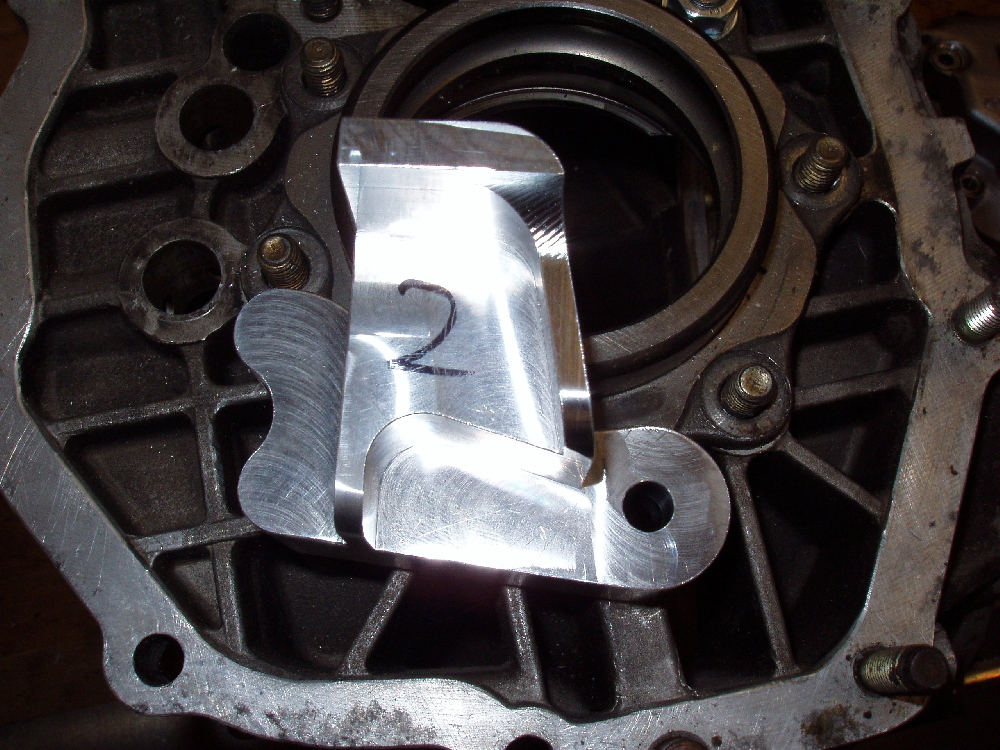

Hi Chris and all of you,
here are first pictures of the bearing supports for the aluminium 915. Not completely finnished, but the final milling will be done this weekend. You can see that the base of this support is wider and that it by this sits where the shiftrod originally was supported. I have a part made on the lathe that will be fixxed in this position of the shiftrod with clue (don´t know the right word now). In this part a pin will be installed. On this pin the new bearing support will be placed. One thread M8 will have to be cut in the one position in the gearbox that is existing in the alu-915.
Martin
