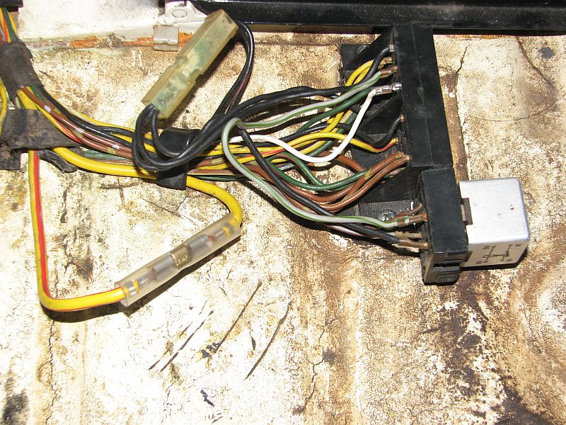

Under passenger seat, look at the relay assembly. Two big yellow wires ... disconnect and splice them together ... no more interlock and car will start.

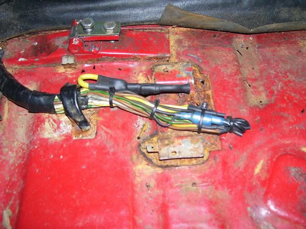

As left photo after I removed the entire component:
The whole process was somewhate intuitive after a bit of review of the wiring diagram. The main thing is getting a good splice of the yellow ignition wire.

As been said, connect the yellow wires together. There is a black wire with a red stripe that is hot with the key. Tape the end of it off so it won't ground out......

The easiest way is to use a double male connector, its easily reversible. I am told this is the way dealers did it. (IMG:style_emoticons/default/biggrin.gif)
