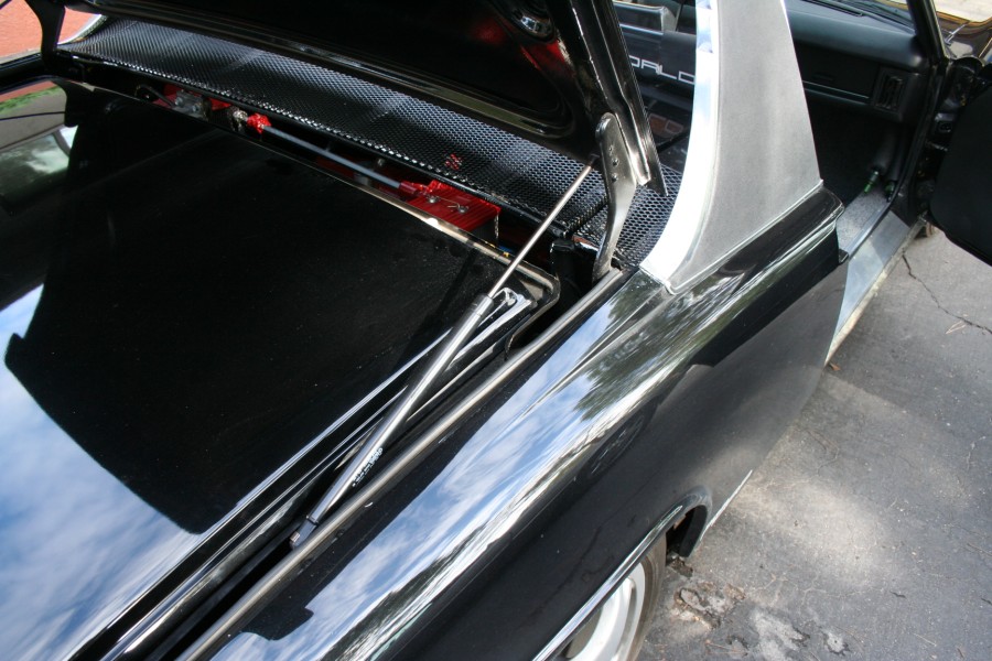

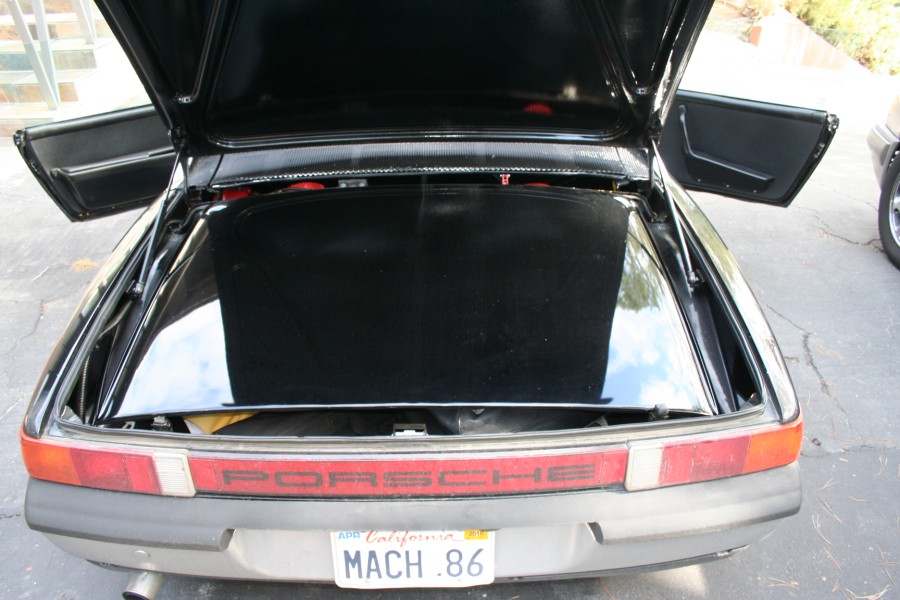

I have the Camp 914 trunk lid shocks on both trunks of both cars and they work great. Mine are mounted a little differently and the roof fits in the trunk perfectly.

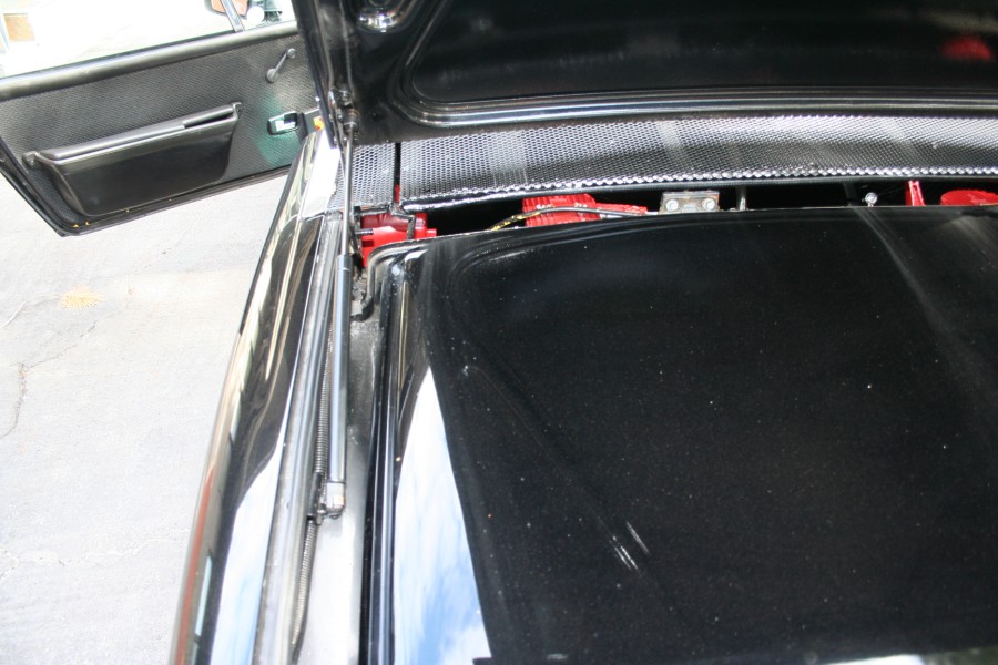

The instructions show it connected to the trunk hinge and then a cut on the body just a bit. 3 screws to the underside of the channel for the trunk seal.Attached Image

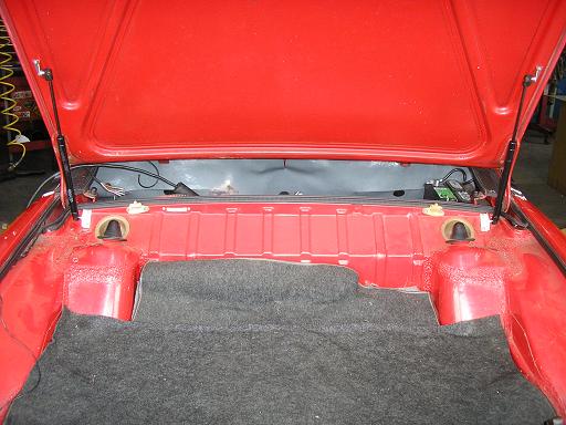

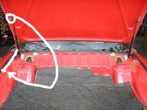

Yep, the red car pictured has them installed 'uniquely'. Following the instructions from Camp914 results in a setup that works without interfering with the targa top.

Yep, mine are installed like this, and the targa fits perfectly (even with that big box in there lol)
http://gallery.me.com/rodericdavies#100050...p;bgcolor=black

Correct installation = easy roof stow. (IMG:style_emoticons/default/biggrin.gif)
