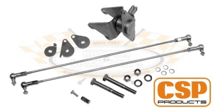

I am very interested in one of the CSP types. Does anybody have any pictures installed on a 914? I am curious about the throttle cable.
How does the one in the picture from above mount? Does it mount like the csp type pictured? Hard to tell from the picture.
I am very grateful for everyones responses.

QUOTE(tornik550 @ Feb 7 2010, 06:41 PM) *
The CSP mounts at back of engine case. The first one would mount in middle of engine case. The CSP needs throttle levers on the same side of carbs. At the rear.
I am using base from first one and bellcrank/rods from CSP. I will try snd find a pic of mine. There was a good pic of the CSP mounted at rear in a thread here somewhere too.
