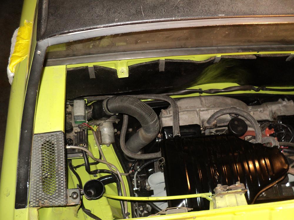

I had to stop someplace. I just rubbed off some of the discoloration left from life in the engine bay of a 914. It cleans up nice. I'm not doing a CW job on this. It's a very nice solid car we want to drive this year. Maybe even to the RRC 2011... (IMG:style_emoticons/default/shades.gif) We shall see...

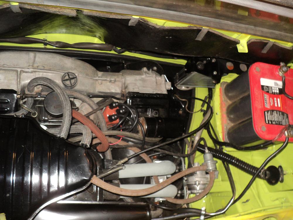

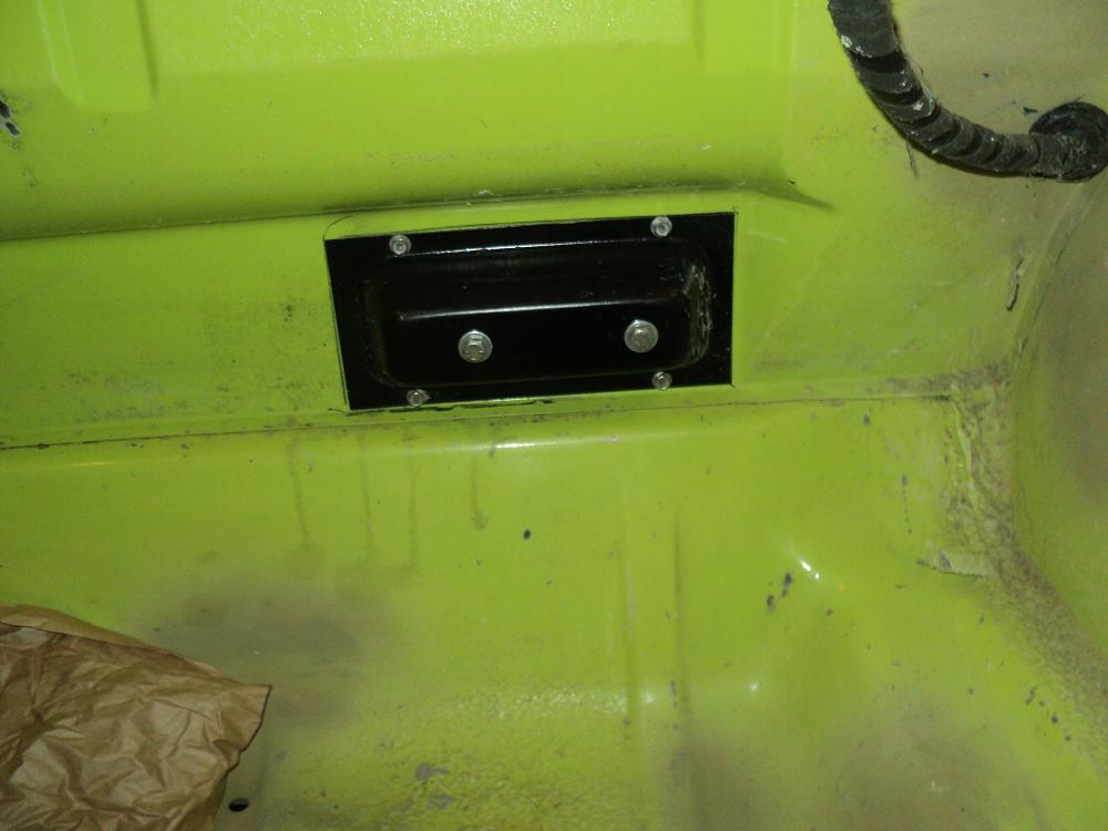

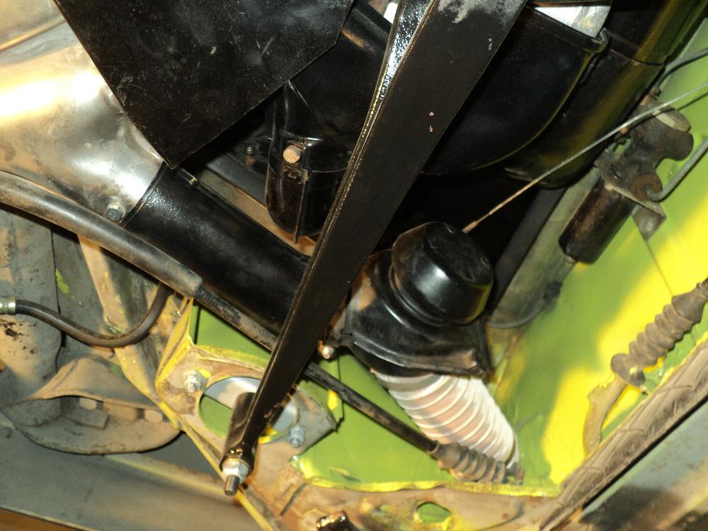

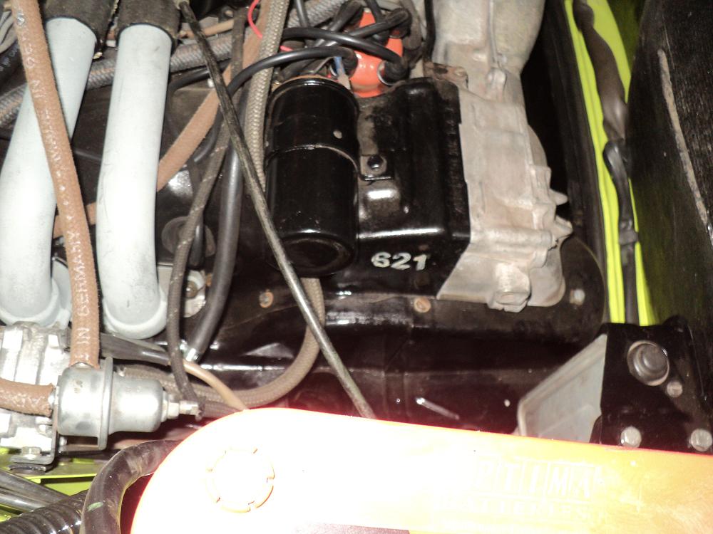

Not too much to update here yet since Aric and I drove the car around without and lights or body panels to be sure that mechanically the was sound. But here's a detail I missed. I decided to locate the fuel pump up front. I like the factory pocket for the fuel pump from the late cars so I added one.
Also used the battery charger method to clean the gas tank before it was installed.
I have the heating ducts finished with the exception of the barrel nuts for the cables. Those should arrive tomorrow and the car will be off the jack stands and ready for the paint work to begin.

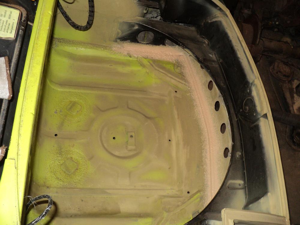

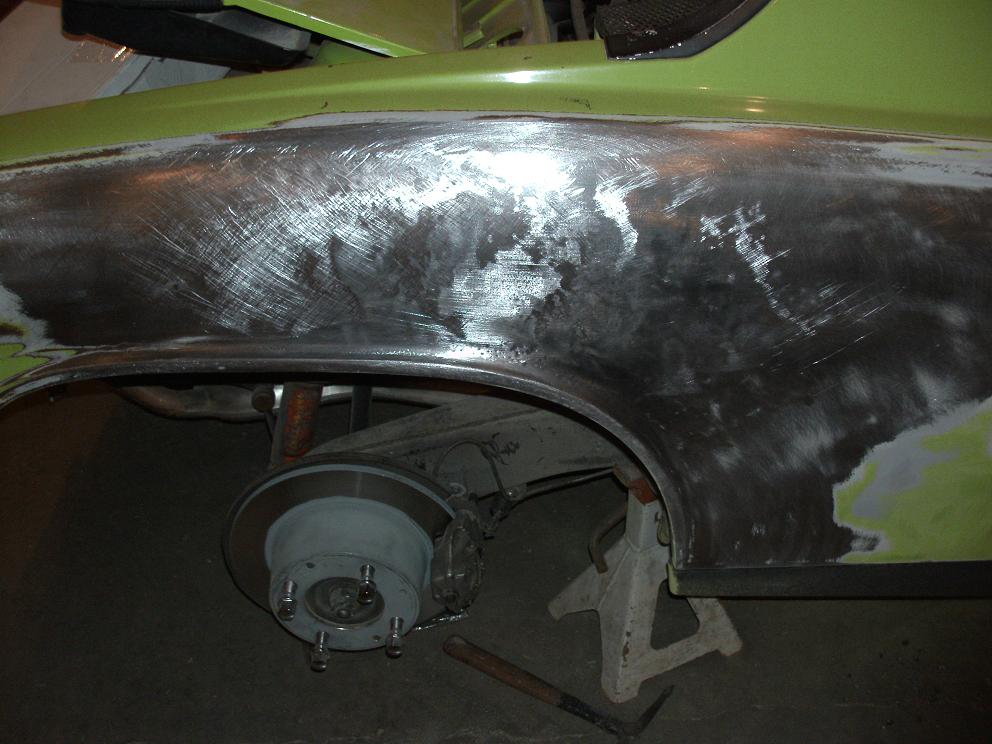

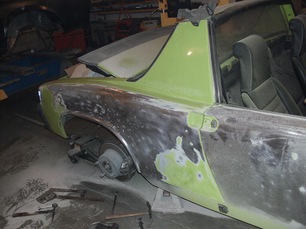

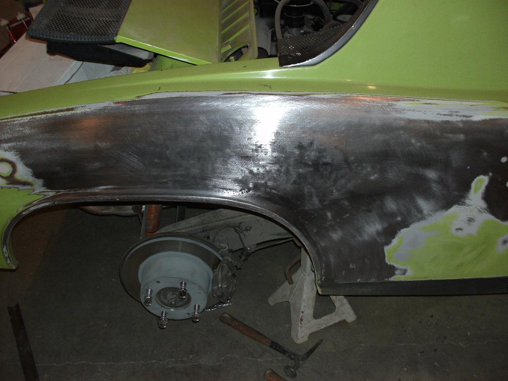

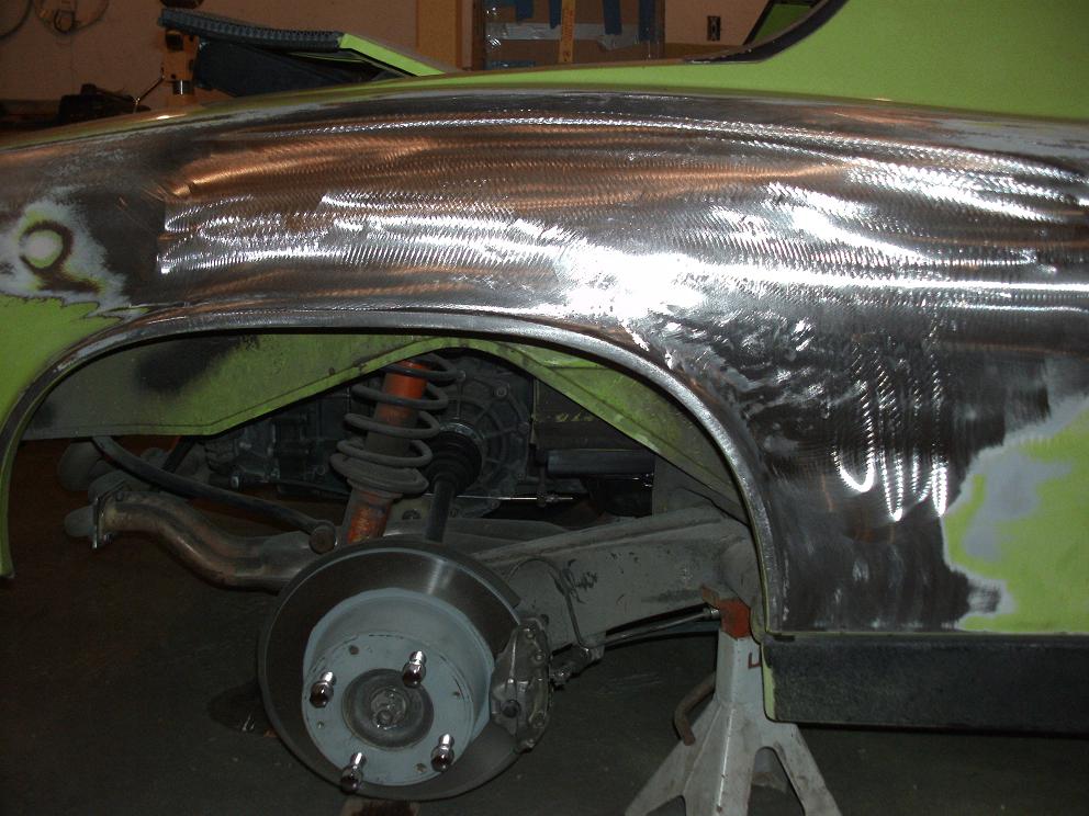

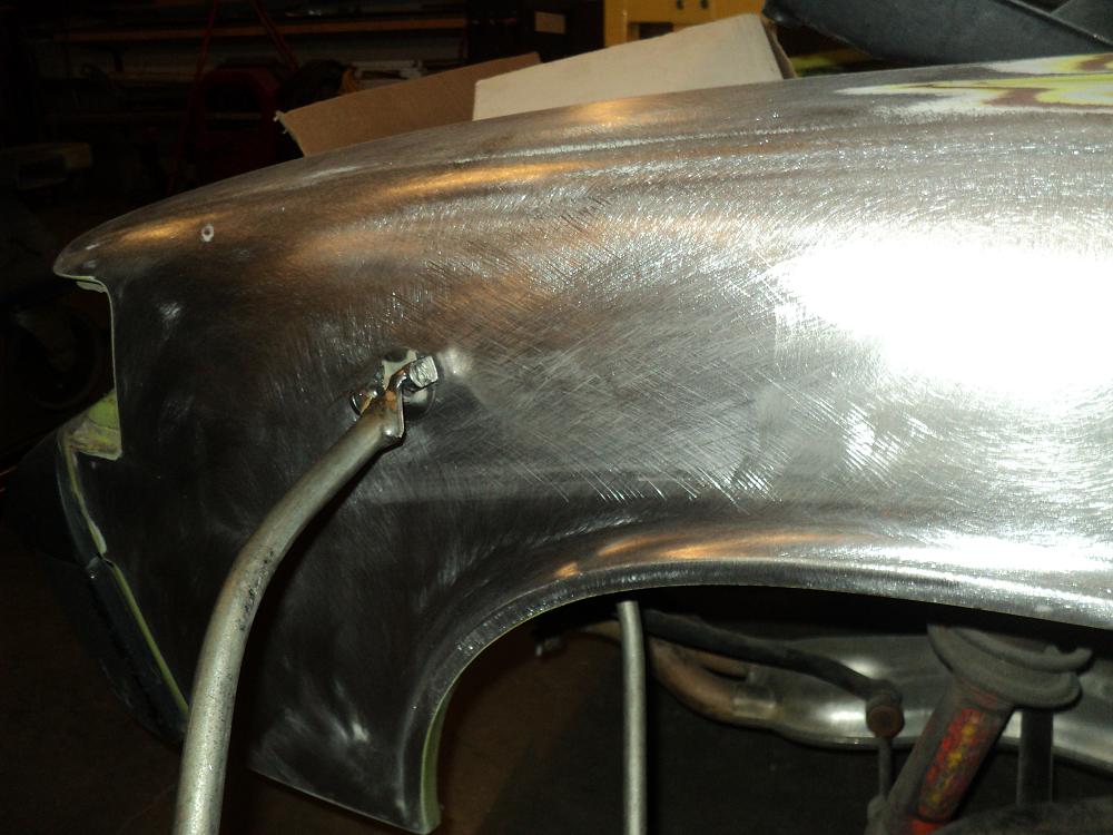

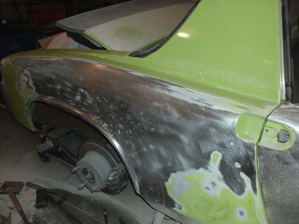

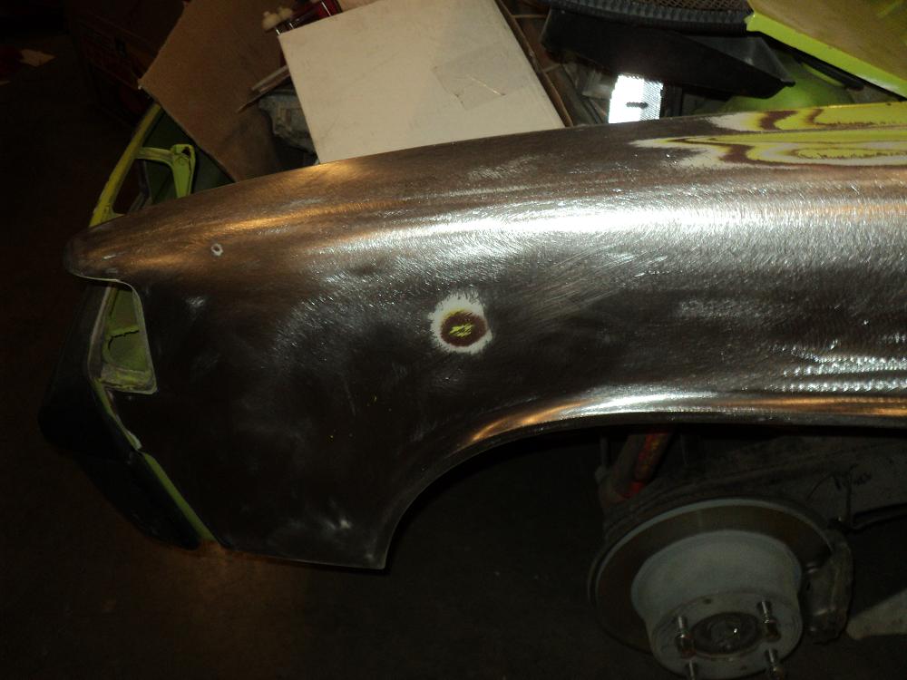

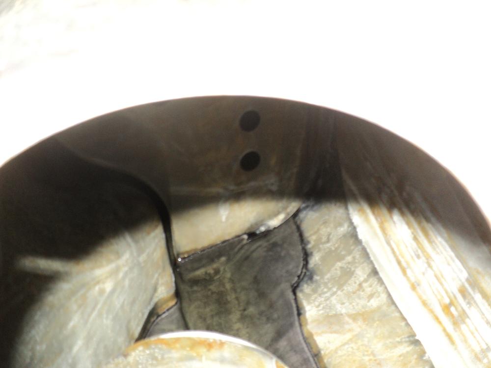

So cars are like a box of Cracker Jacks. There's a surprise in every box. Some good, some not so good. As I started sanding on the car I discovered it had two repaints. I don't paint over a repaint. Todays paint systems are not compatable with laquer based primers and glazing putties. This car had the old laquer base Nitrostan or what the old school bodymen know as Red Cap. So off comes all the paint right down to the steel.

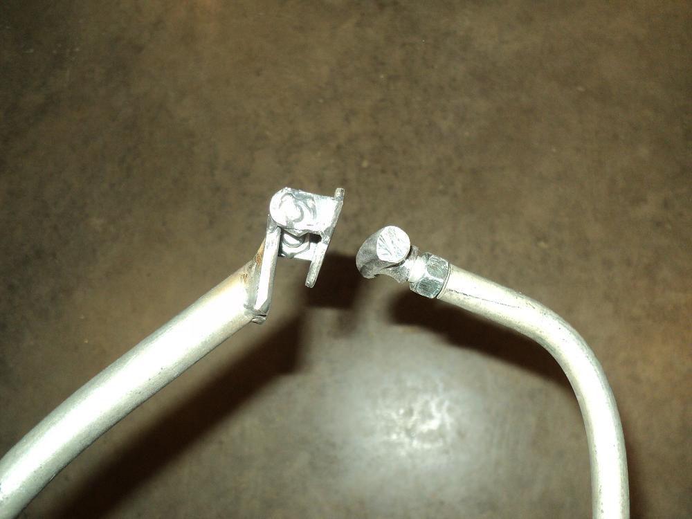

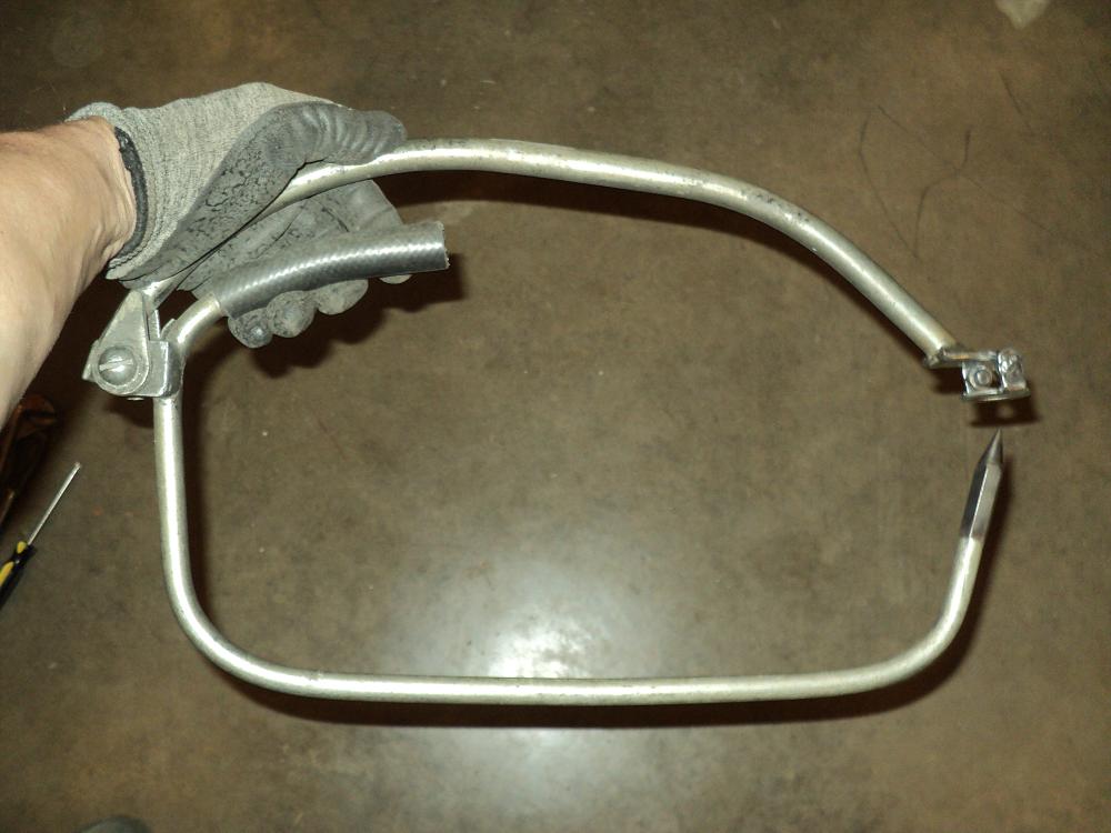

The second not so nice surprise was the dent in the quarter panel that had been stuffed full of filler as deep as 3/4". To make matters worse they attacked the inside radius with a pick hammer!
I spent most of the day bumping and filing. Here's the results.
Here is a dent that is easier to see. I used a bullseye pick and file to repair most of the damage on this panel.

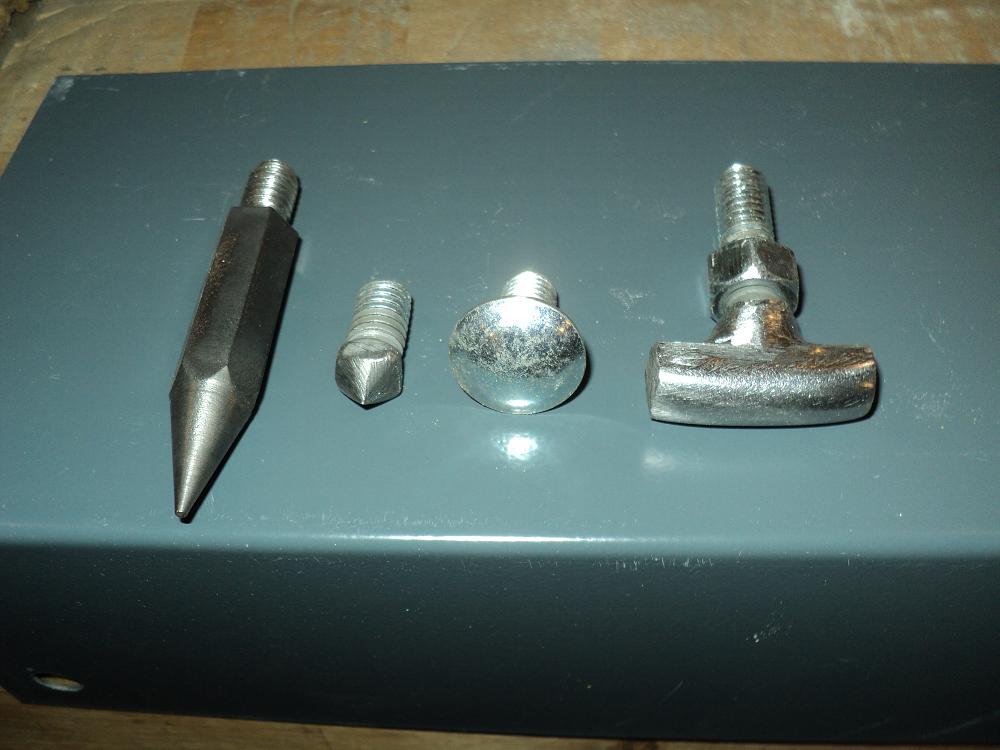

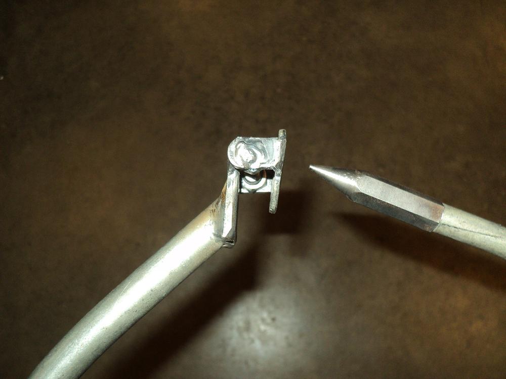

Some of the accessories For my Bullseye pick.
I added this swivel foot to my pick. When you tip the tool the fixed foot tends to dig in and actually cause indents as your bumping the panel.
