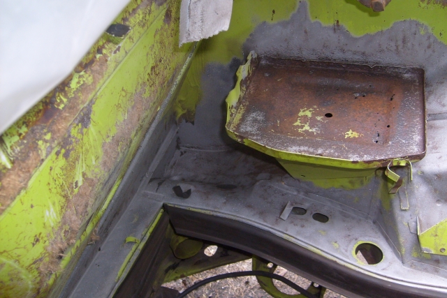

I started sand blsting the surface rust in the engine bay yesterday but it was so hot and humid my moisture filter was soaked through in about 20 minutes. But here is the reason I wanted this car.
The only holes are in the battery tray and the base of the rear bulkhead where the sound deadening pad was glued to it.

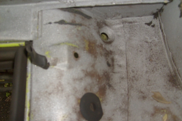

We have all seen this bulkhead rust before but not usually so little. There is a hole in each lower side of the bulk head in the usuall place that is the size of the end of an ink pen.
