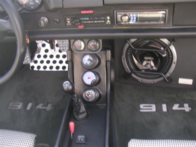

I run oil pressure (VDO), oil temp (VDO), cylinder head temp (Aircraft Spruce), stock voltmeter and clock.
I Tee'd the pressure sender(s) so I could keep the warning light and have had no problems. It's nice to have gauges...

I use a dual VDO sender for the oil pressure. One wire (stock) to the idiot light and one wire to the pressure gauge. Also have an oil temp with real numbers. I've never had any flickering dahs lights due to the sender. Sorry no P/N. A CHT will be next, I've already run the wires (when I built the car).
I'd highly recommend the the oil pressure gague. I've seen my pressure drop on clover-leaf freeway on ramps.

Oil temp, Oil Pressure, Voltmeter, Clock ... the last two are for fun. I may add a cylinder head temp, but it's a six so ........................

yep, I took out the clock and Volt meter, I run oil temp (new gauge with numbers), CHT(not working ATM), and oil pressure.

Oil pressure, oil temp (with numbers), CHT, & volt (direct to the battery).
