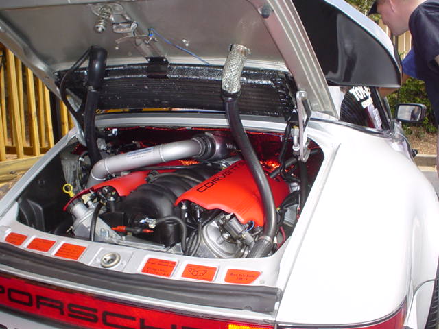

Malmz   The concept of the rear radiator doesn't seem ...   Mar 31 2004, 10:13 AM
Malmz   FYI. http://toy-jet.com/website5.jpg   Mar 31 2004, 10:14 AM
Mueller   I totally agree with you Steve, that rear spoiler ...   Mar 31 2004, 10:34 AM
