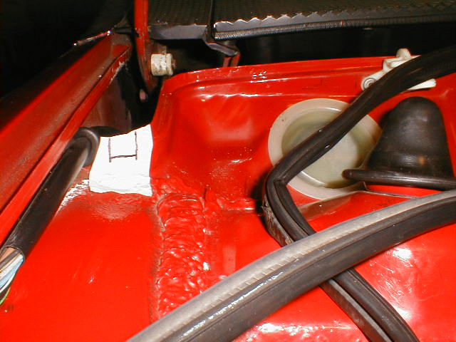

Does anyone have a Craig Laughlin's (Camp 914), rear trunk lid shocks installed.
I need a close up of the area of the rear trunk bulkhead that needs to be cut.
I have his instructions, but I can't see the photos.
There IS this shot on his website, but I am looking for something a little closer (or straight on) showing the exact area that needs to be cut.

Curvie Roadlover
post Mar 28 2004, 07:23 PM
Two trunks are better than one!
Posts: 2,025
Joined: 29-December 02
From: Southeast Michigan
Member No.: 42

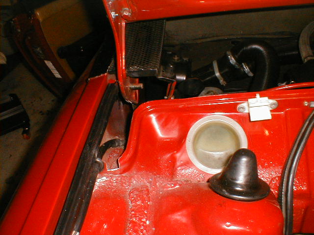

here
Curvie Roadlover
Posts: 2,025
Member No.: 42

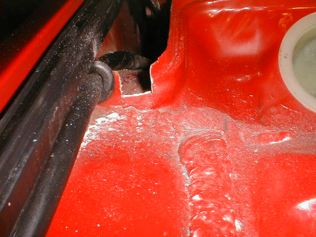

dheehta
Curvie Roadlover
Posts: 2,025
Member No.: 42

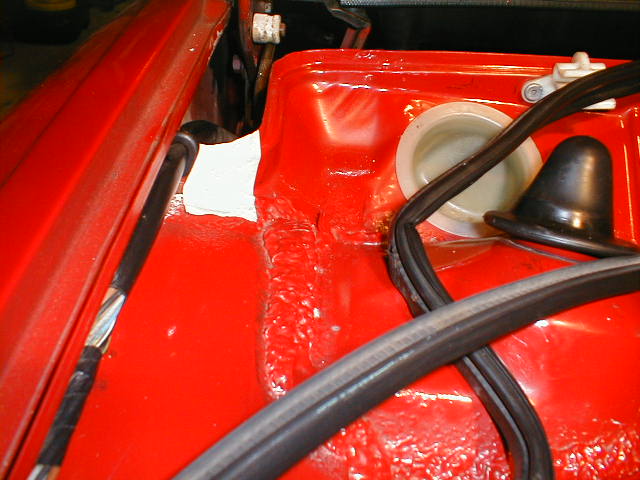

fyukdrj
Curvie Roadlover
post Mar 28 2004, 07:24 PM
Posts: 2,025
Member No.: 42

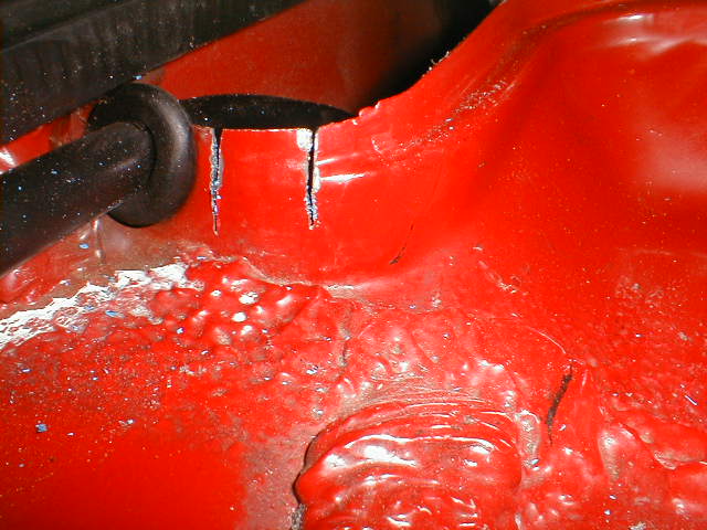

jyds
Curvie Roadlover
Posts: 2,025
Member No.: 42

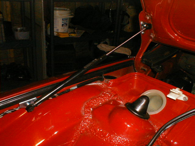

jl;./hg
Curvie Roadlover
post Mar 28 2004, 07:25 PM
Posts: 2,025
Member No.: 42
Hope that helps

Also, I had to cut the bolt on the trunk hinge closest to the rear to keep it from scraping on the chrome shaft of the shock when it closes.

This was my project last weekend. Pretty straight forward. A big improvement over the stock springs, which, by the way, came off alot easier than I expected. I made "the tool" from a closed ended wrench as was discussed in an earlier thread.

Why mount these so low as to cut the sheet metal? I purchased Ken Shippers (eBay) which mount higher up the opened lid. I suppose Craigs design allows you more clear area to insert the top...
