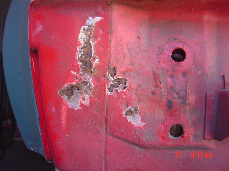

(IMG:style_emoticons/default/icon8.gif) (IMG:style_emoticons/default/barf.gif) (IMG:style_emoticons/default/sawzall-smiley.gif) (IMG:style_emoticons/default/welder.gif)
Attached Image Attached Image Attached Image Attached Image Attached Image Attached Image Attached Image Attached Image
scotty b
post Apr 1 2010, 06:18 PM
Post #153
rust free you say ?
Posts: 16,375
Joined: 7-January 05
From: richmond, Va.

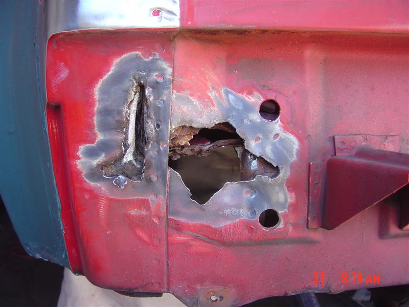

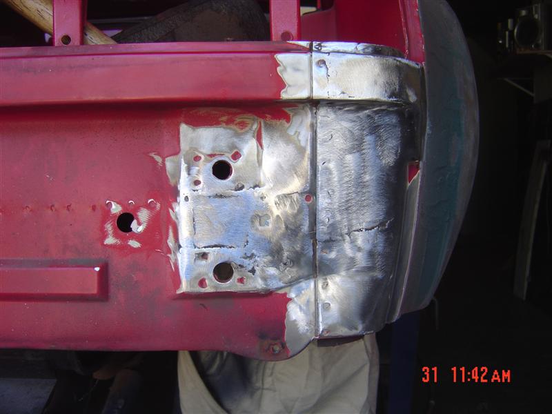

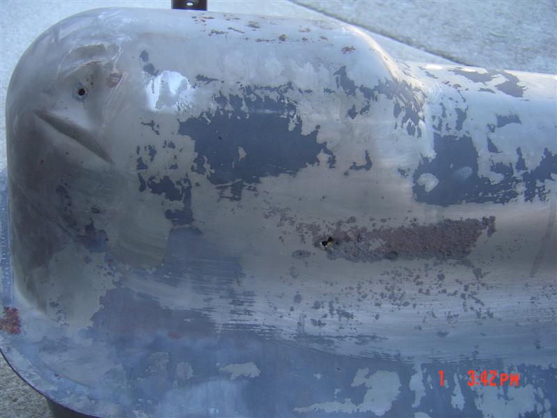

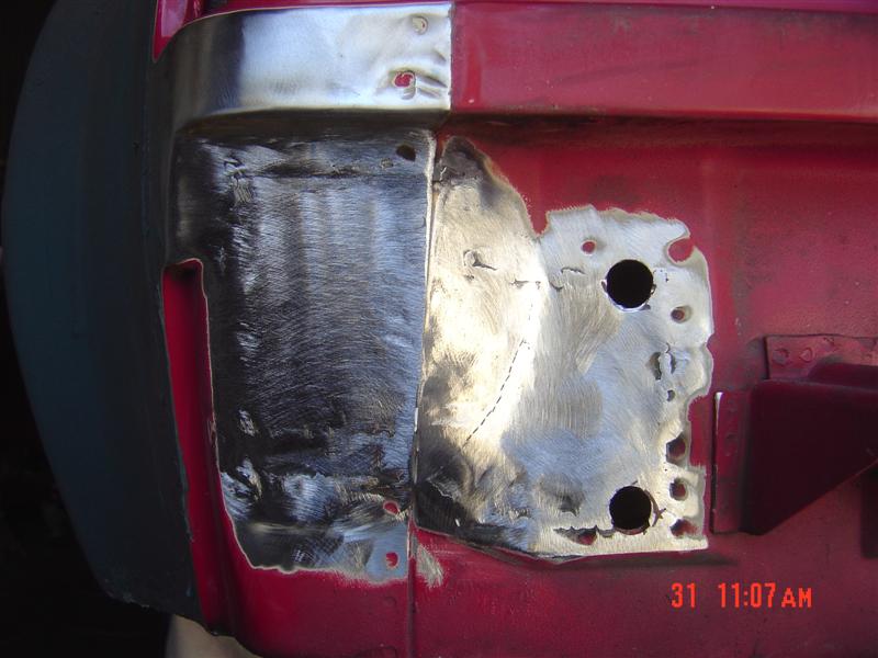

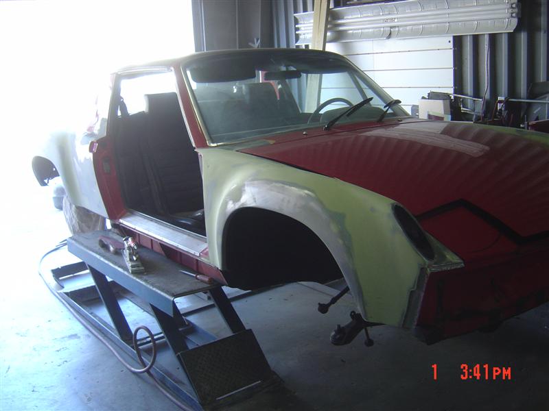

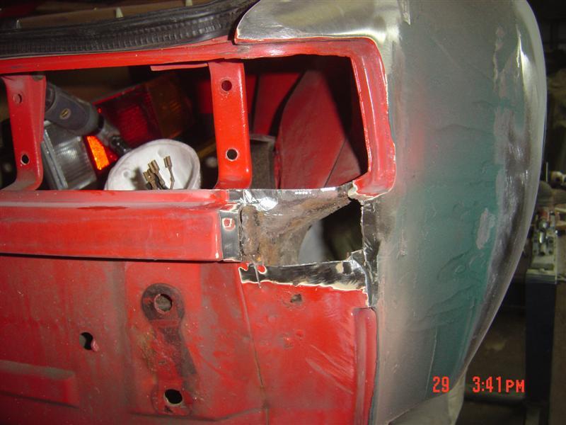

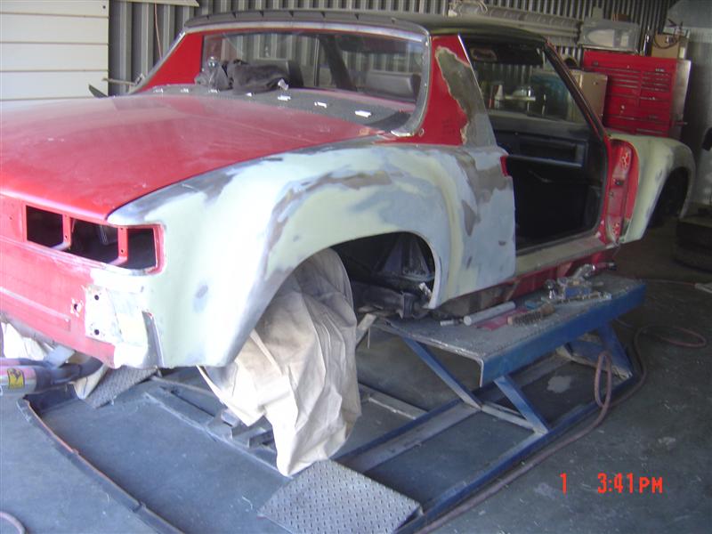

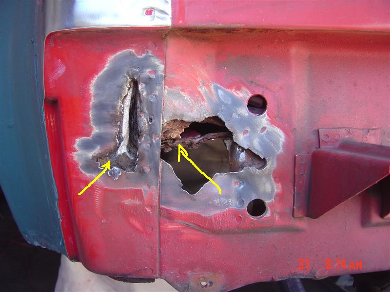

Member No.: 3,419

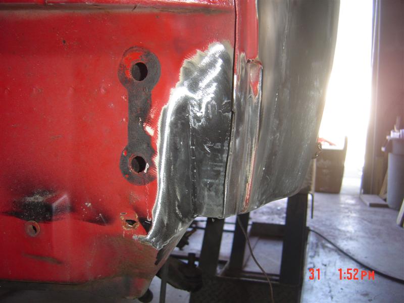

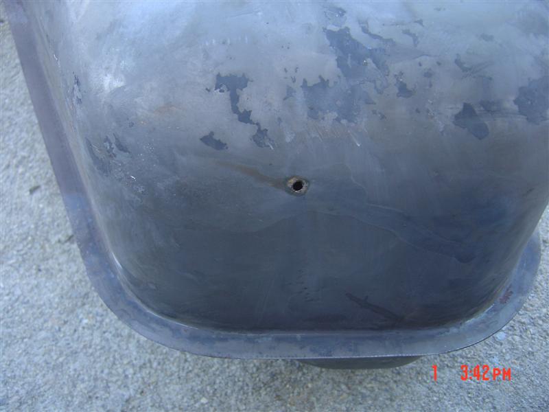

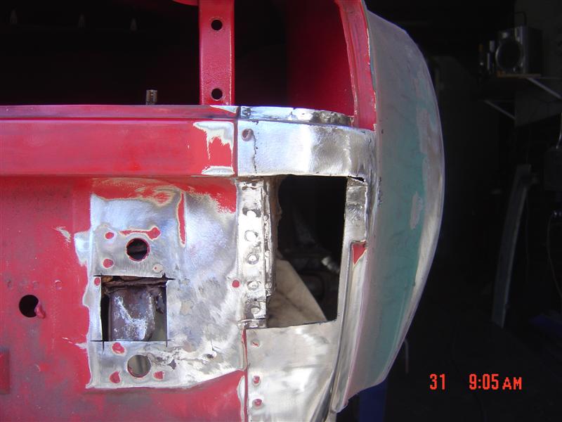

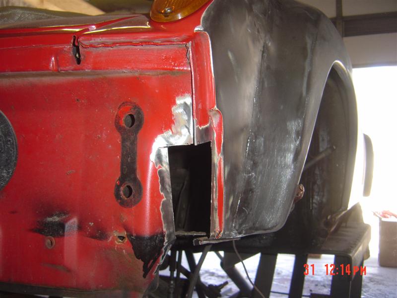

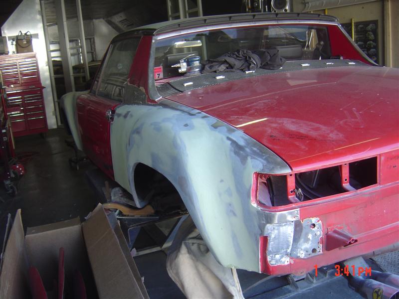

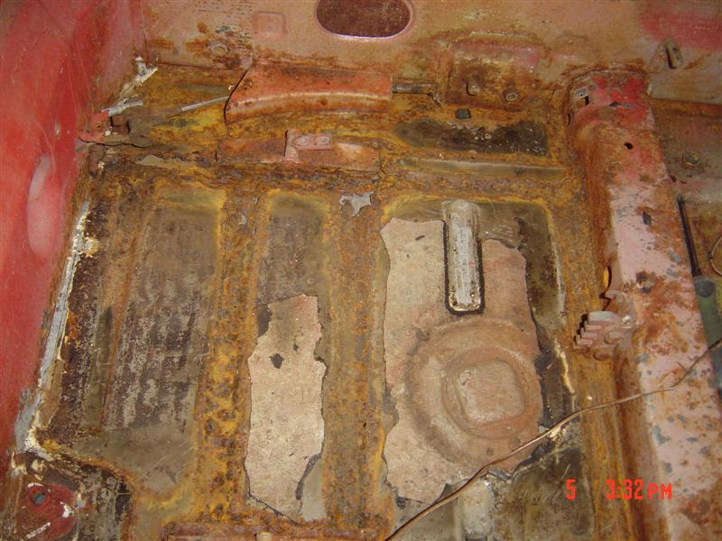

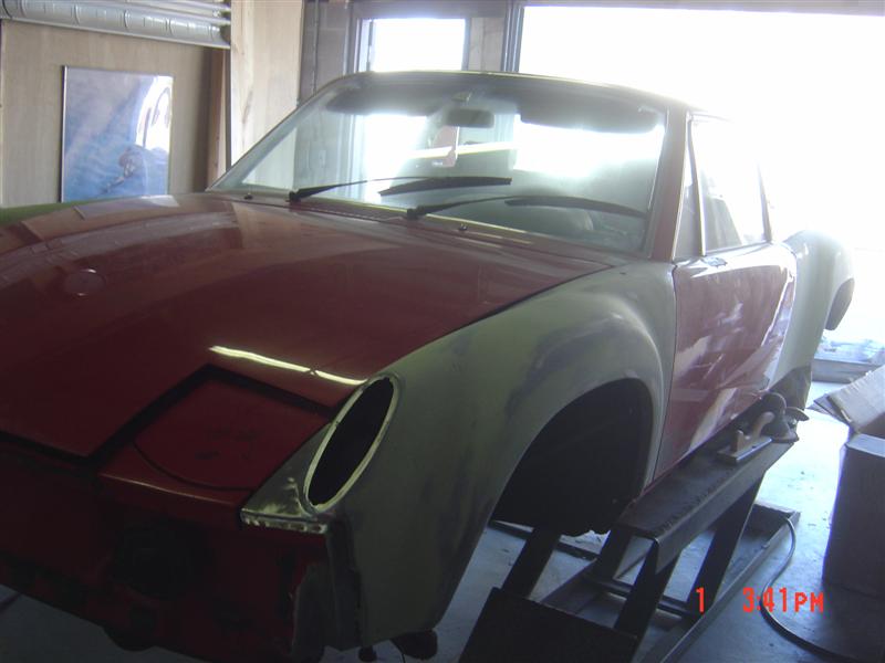

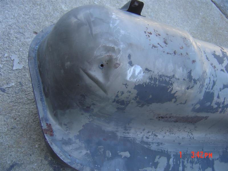

Flares are all roughed in. Tank is no good. (IMG:style_emoticons/default/sad.gif) I have a couple more small rust spots to fix, and once the areas in the rear were opend up, it became obvious the trunk had been ingfiltrated, so I will be cutting out the seam sealer along the trailing edge to see how bad the trunk floor is. I don't expect much more than the corners where I had to repair the ourtside of, but we shall see. Oh and some more Shea bling showed up today (IMG:style_emoticons/default/drooley.gif)

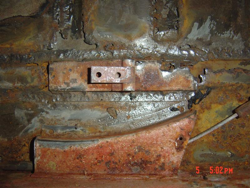

Scotty, how do you address rust behind the panels when you find it? I know that you wouldn't just button it back up after spraying it with rust converter...
scotty b
post Apr 1 2010, 07:38 PM
Post #156
rust free you say ?
Posts: 16,375
From: richmond, Va.
Member No.: 3,419
Ken, I actually forgot totake of pic of it, ( I tend to get caught up in what I am doing and forget pics often (IMG:style_emoticons/default/dry.gif) ) but you can tell from the repair photo, I ended up cutting most of that whole area out and replaceing it. I cut out to where I have good solid metal, make my patches and weld them in. Once everything is finished, I will go back over them ( fornt and backside ) and give the spots a coat of etch primer and sealer, then either paint or undercoat as the spot dictates.

QUOTE(scotty b @ Apr 1 2010, 05:38 PM) *
Thanks - I knew that you wouldn't just leave it, but I guess my question should have been how do you eliminate it? Do you blast it before you prime, cut it all out, use rust converter or what? As many have said, rust never sleeps - how do you make sure that the crap hidden behind panels is removed at best, or neutralized at least?

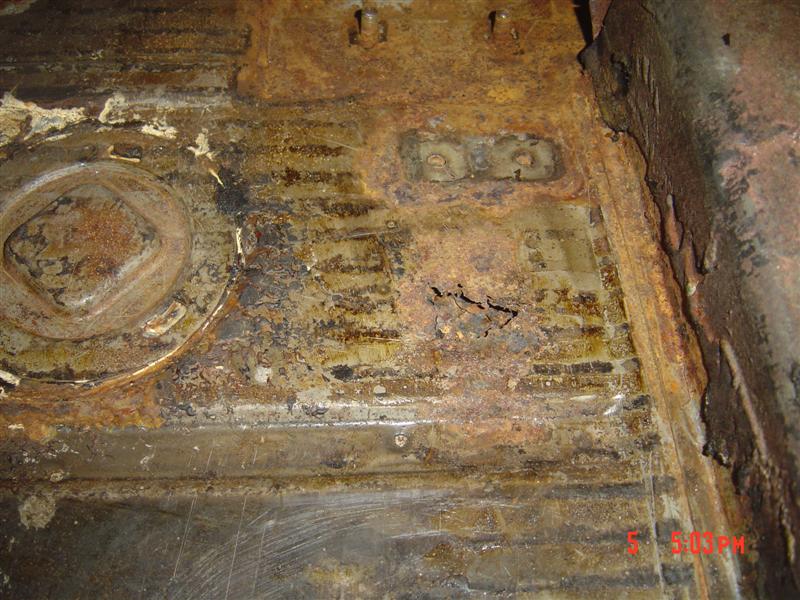

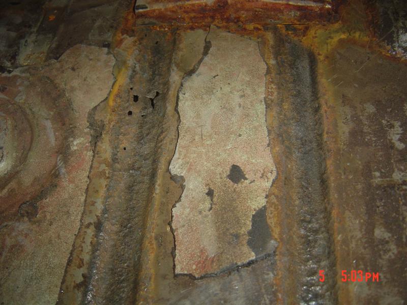

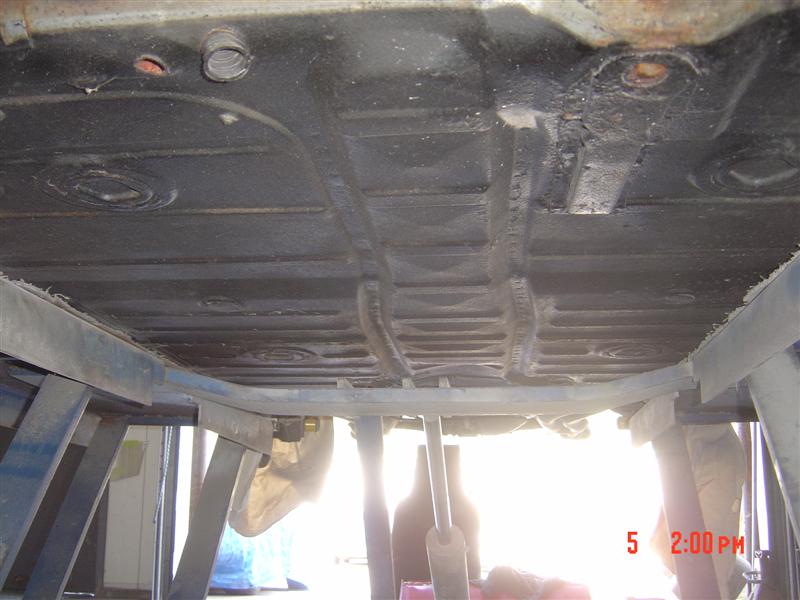

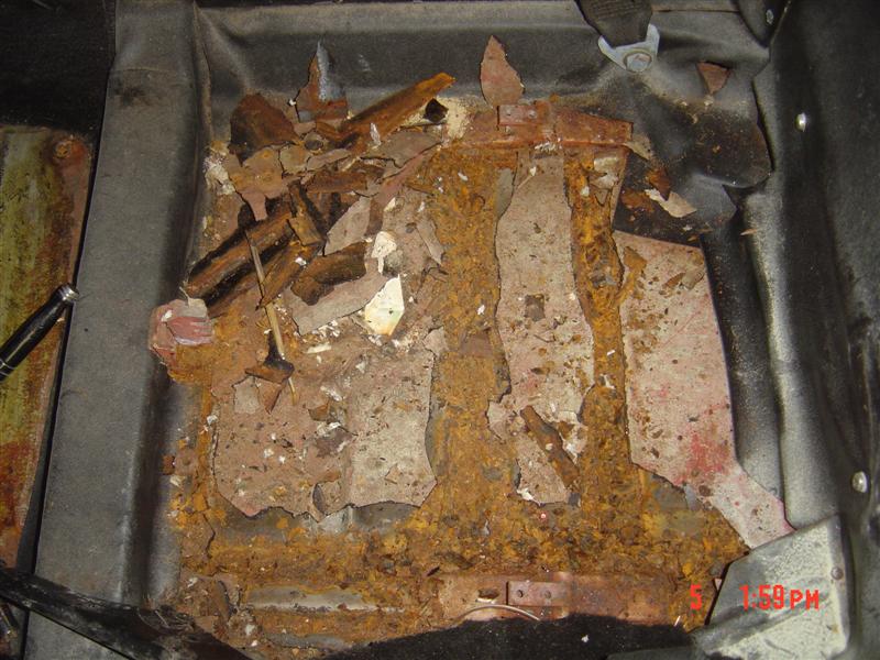

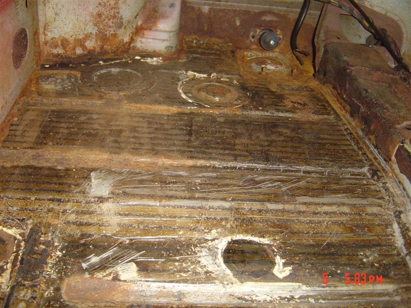

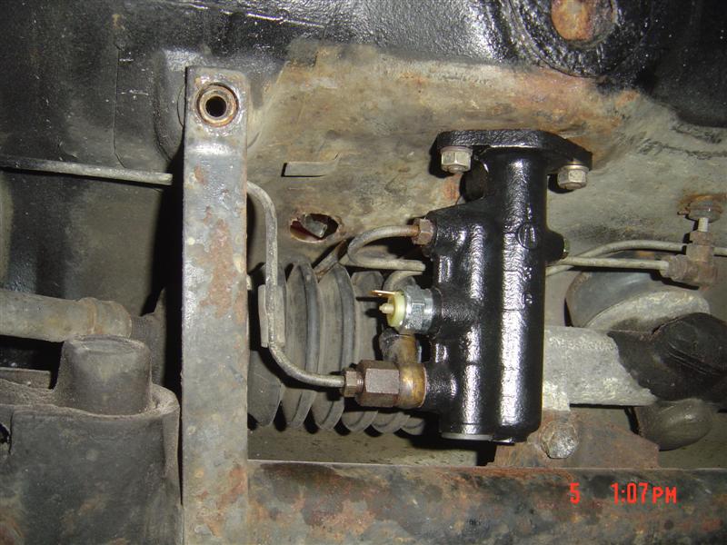

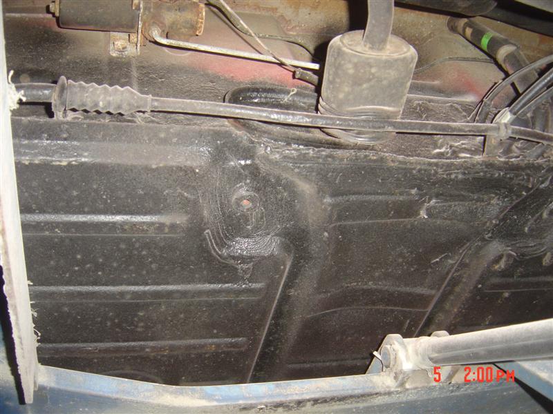

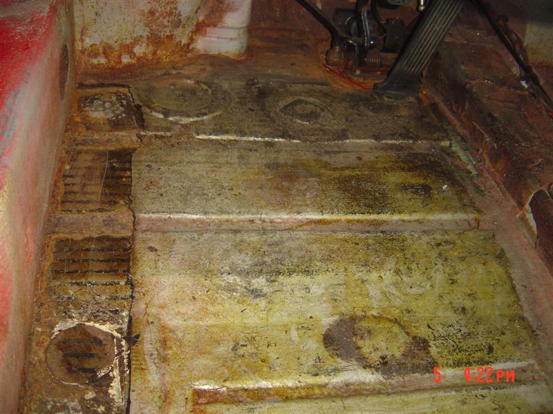

MC installed, replaced the hard line on the pass front as it was rounded off and so rusted on, I couldn't break it free heated cherry red and vise grips on it !! I had a spare that wass in good shape so on it went. I also had a MUCH bettere gas tank, so it went to the sealer on monday. Found more rust. Do your self a favor and ALWAYS get the damned tar board up. I don;t care how clean you THINK the floor is, there will be issues under that tar.
In my experience the floors rust from the inside out. I took a picture of the underside of Marks car right when I found the crap under the drivers seat. This shows how clean and nice his floor LOOKED. Peeling up the tar board tells a different story.
Take note of the striped on the floor after the tar is removed. That right there is proof the stuff doesn't bond from the factory, it ONLY bonds where the stripes are, and it never bonds down in the strenghtening channels. My guess is the tar is preformed and doesn't even touch the bottoms of the channels. Mark will be getting the drivers rear floor replaced, and I will hopefully just make a patch panel for the spot just infront of the pedal cluster.
