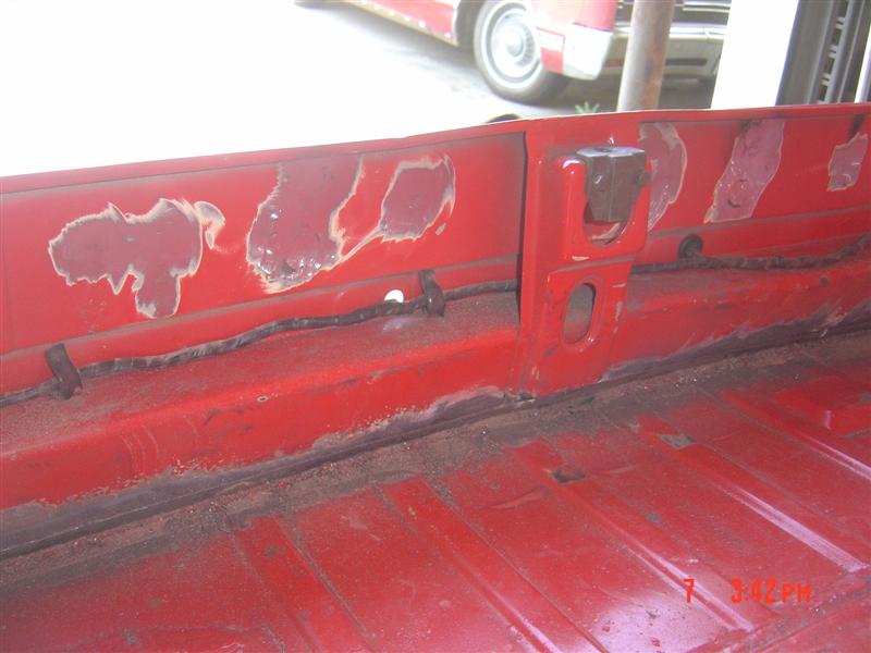

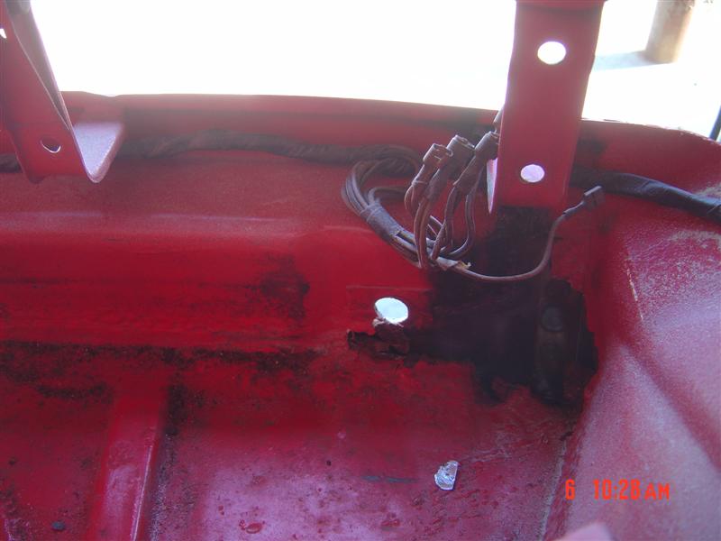

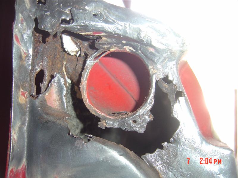

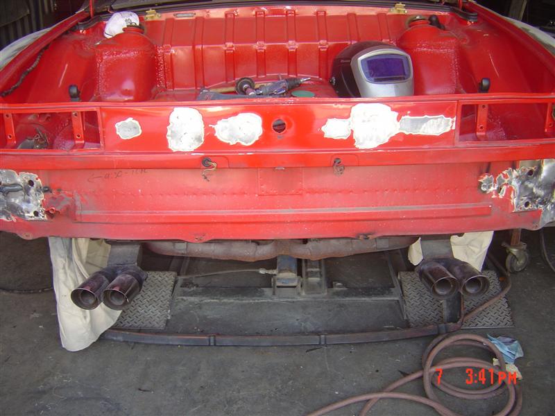

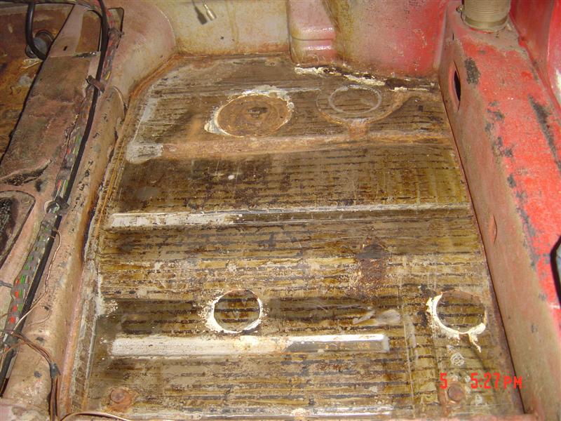

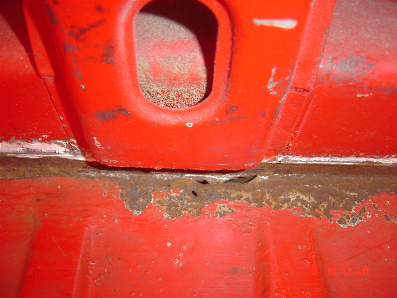

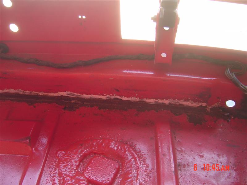

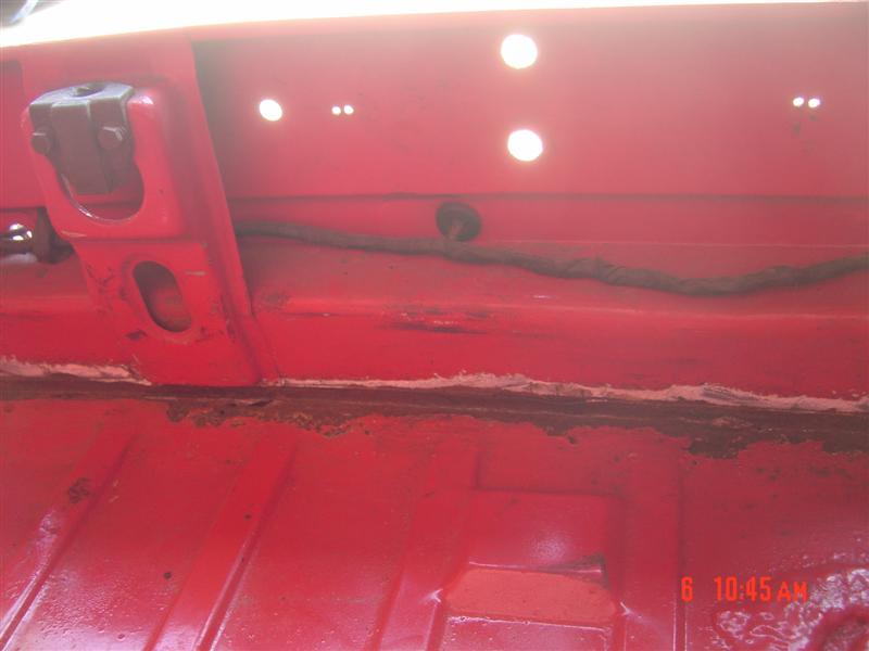

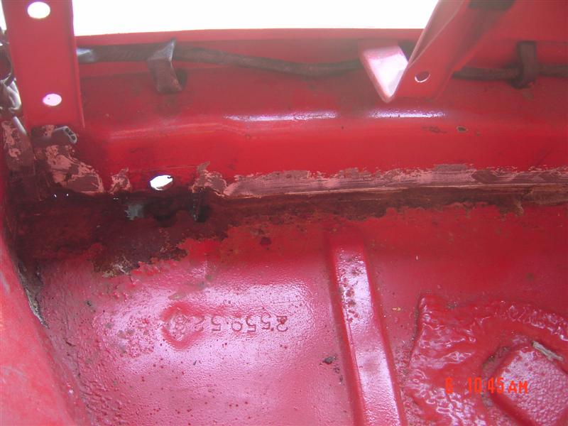

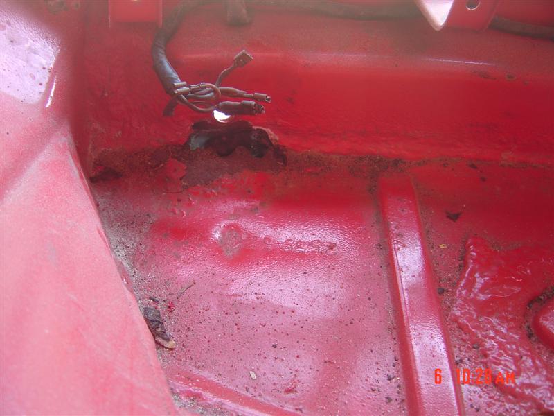

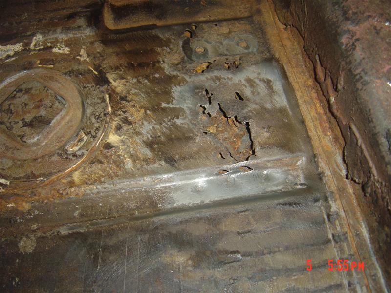

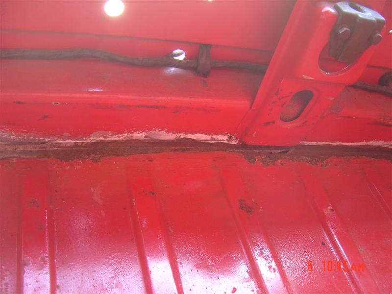

(IMG:style_emoticons/default/barf.gif) The trunk that initially appeard solid also showed itself when I repaired the outer metal where the bumper bolts go, so I went inside and removed all of the seam sealer along the back edge to see how bad that was. Not needing a full pan just a few patches, BUT had I not cleaned the seam sealer out, it would have continued to rust and would need a pan at some point. You can see in the pics how bad it has already rusted and without removing the sealer, noone would have known what evil lurked within.
Some spots IMO it is imperative to get the " protective " coatings completely removed, because no matter how nice it looks on the outside there is alot of ugliness underneath.

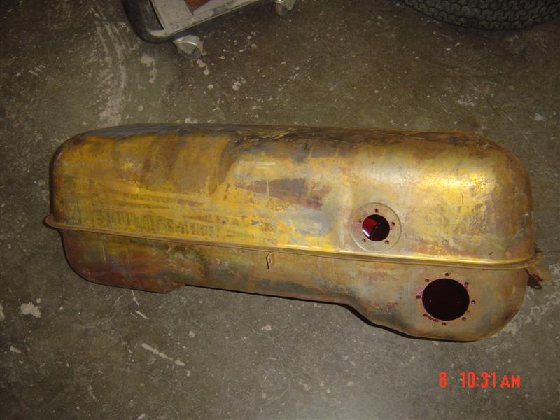

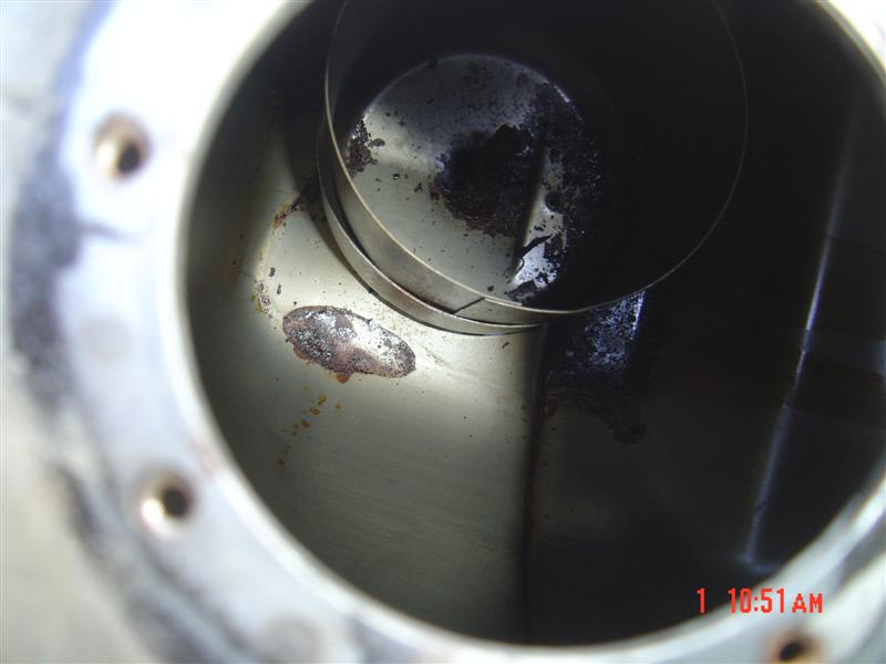

And the innards of the replacement tank (IMG:style_emoticons/default/smile.gif)

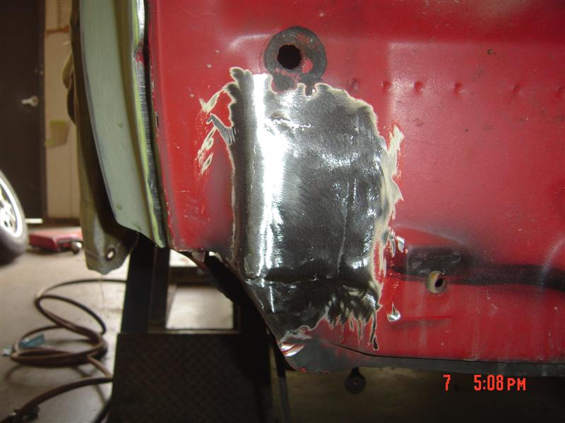

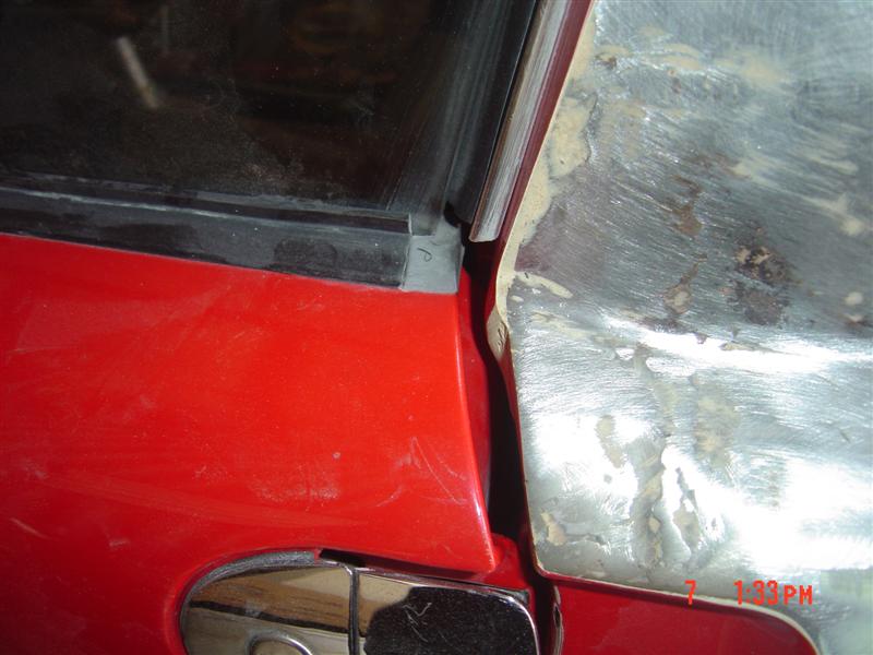

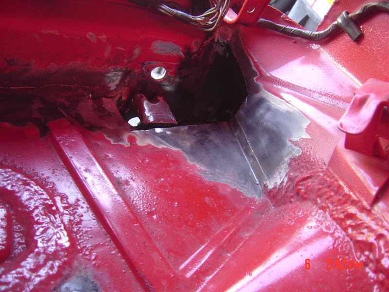

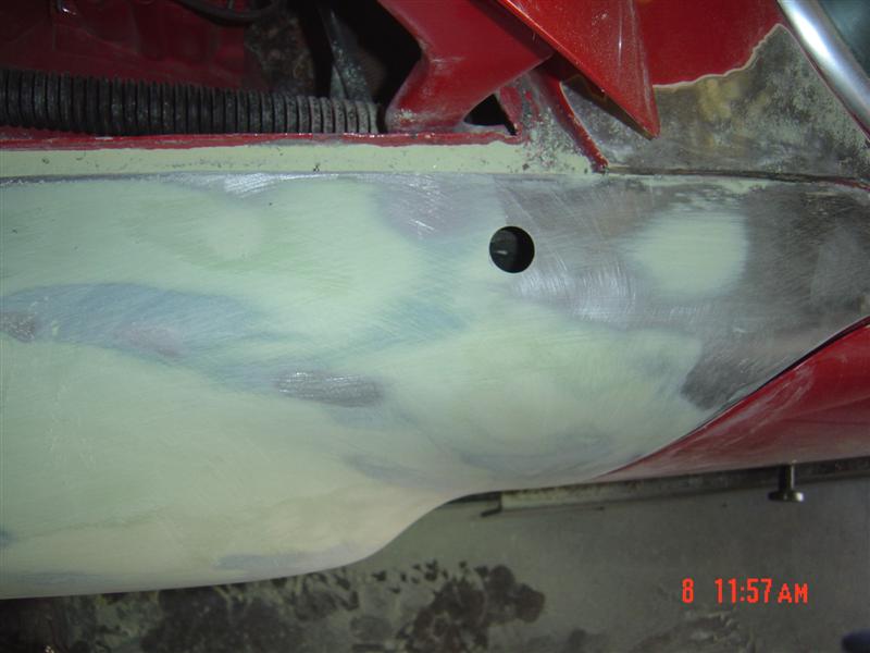

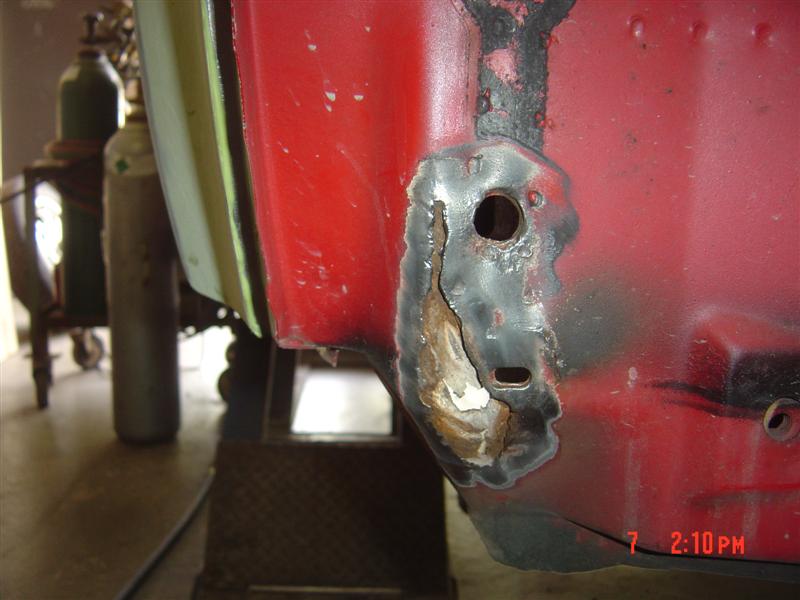

(IMG:style_emoticons/default/sad2.gif) Fotunately I kept the sai panels and door jamb from Mikes wreck. This will be the 3rd car that has parts from Mikes old car on it. I just hope this doesn't end up like Lil Bastards parts did (IMG:style_emoticons/default/unsure.gif)
Attached Image Attached Image Attached Image Attached Image Attached Image Attached Image Attached Image Attached Image

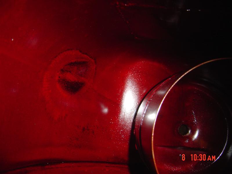

(IMG:style_emoticons/default/welder.gif) Picked up the freshly cleaned and sealed tank this morning. It will be getting sanded down and painted a nice shade of satin black (IMG:style_emoticons/default/smile.gif)

Fotunately I kept the sail panels and door jamb from Mikes wreck.
Thanks Mike. (IMG:style_emoticons/default/beerchug.gif)
Does this mean we're related?
