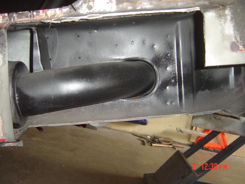

I'm stoked at your tenacity. I know we don't get to see all the steps, so a question. In replacing the floor pan I noticed a bunch of rust in the cavities. You also mentioned using phosfo, is that rust mort? Also do you blast any of that rust of or just use the killer and weld through, before coating with paint? Just curious about the steps you take to put the rust on it's death bed? I know a bunch of guys don't like the Por products is this your opinion? Funny, I always thought the best thing to do was cut the cancer, blast the remaining rust, coat welded areas with weld through, make the welds and then final coat with Por-15 (somewhat a challenge to get it into all the cavities) then coat with body cavity wax. Your advise will be much appreciated, as I have to put a car on the spit in about 4 weeks.

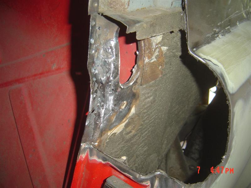

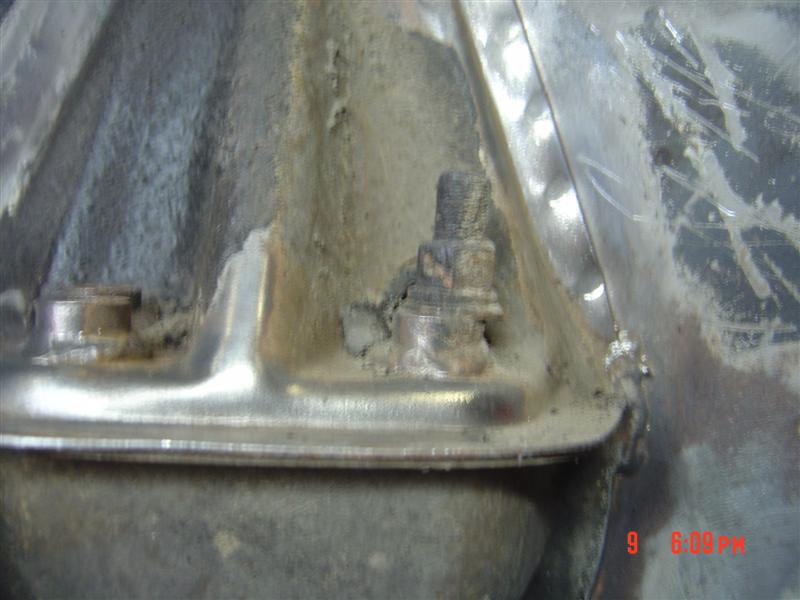

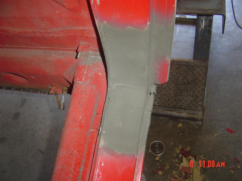

What is left behind is nothing more than surface rust. I will wire brush it, give all of the cavities a coat of Ospho, then a coat of sealer, weld everything shut, and etch prime and seral the outsides. Keep watching the pics (IMG:style_emoticons/default/smile.gif)
scotty b
post Jun 3 2010, 06:22 PM
Post #205
rust free you say ?
Posts: 16,375
Joined: 7-January 05
From: richmond, Va.
Member No.: 3,419
Evil contributions. there are now 4 of you guys that owe Mike a dinner for totalling his car (IMG:style_emoticons/default/av-943.gif)

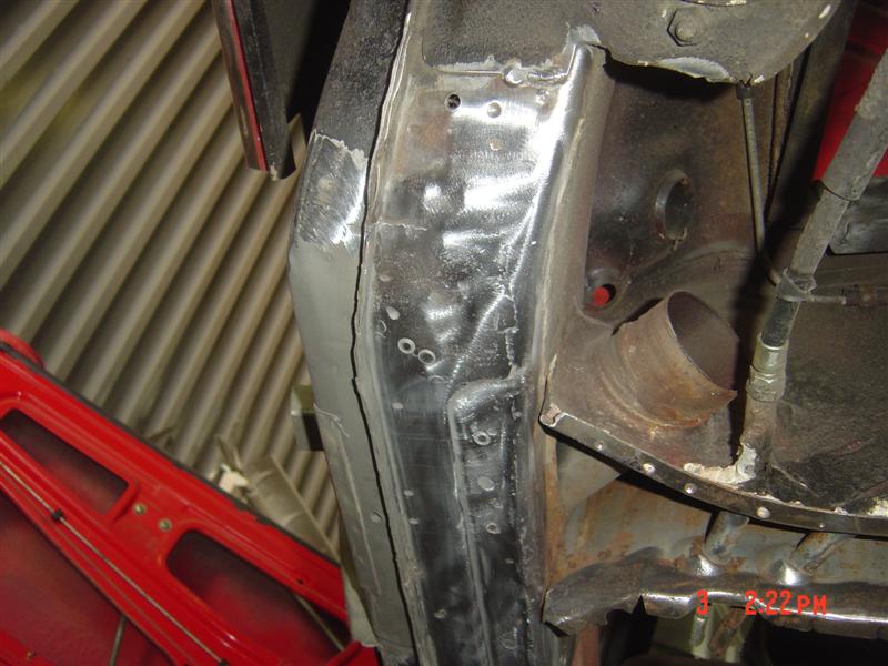

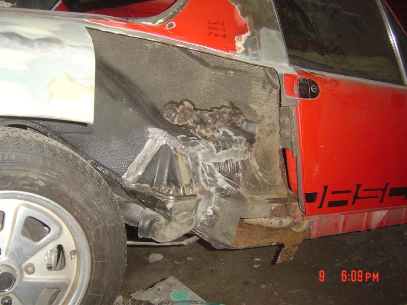

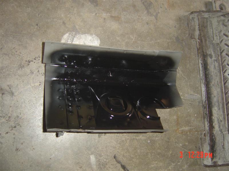

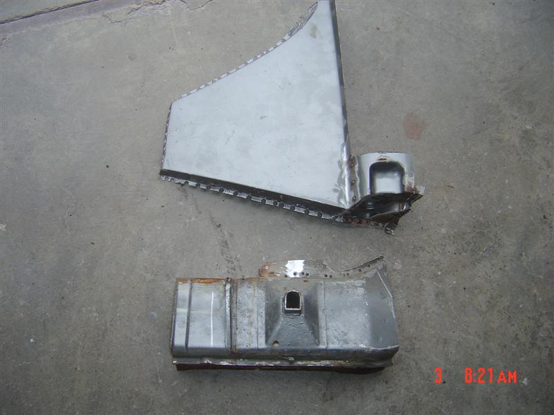

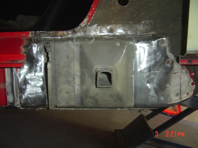

Patches got blasted and coated with etch primer, then a coat of sealer, Cavity got the same after a liberal dose of Ospho, then sealed. Patch weldeded on and grindeded down, then another coat of etch primer on the outside to hold it until I am ready to paint it.

Very timely pictures. Now I know what the back of the jack location is SUPPOSED to look like!

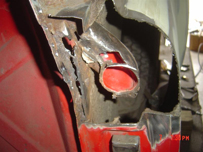

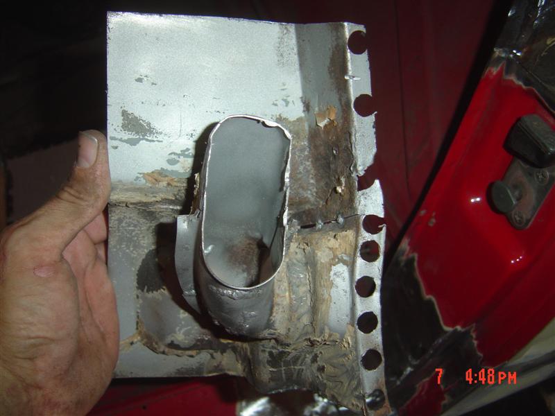

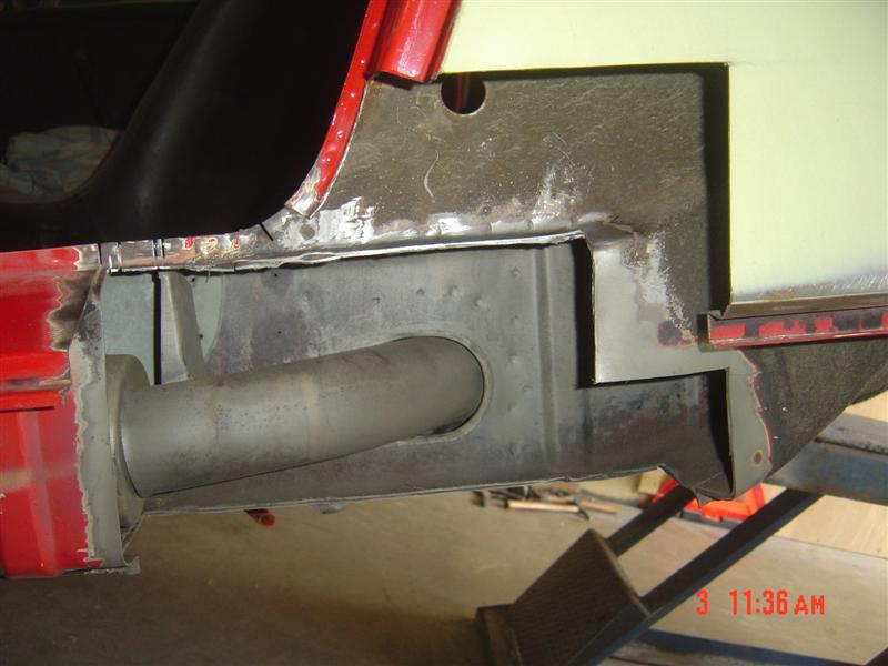

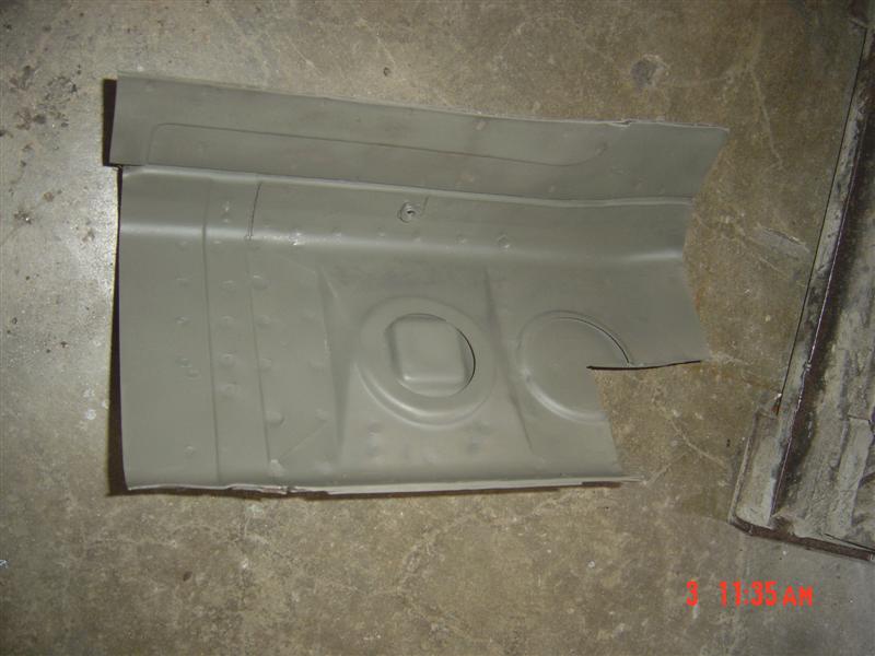

Well guess what ....it gets even worse (IMG:style_emoticons/default/dry.gif) This is the second time I have repaired this spot on a car and I have to say it is one of the biggest PITA areas to fix due to that damned tube Porsche pout in there. What the F is the purpose in that damn thing anyway ?? (IMG:style_emoticons/default/confused24.gif)

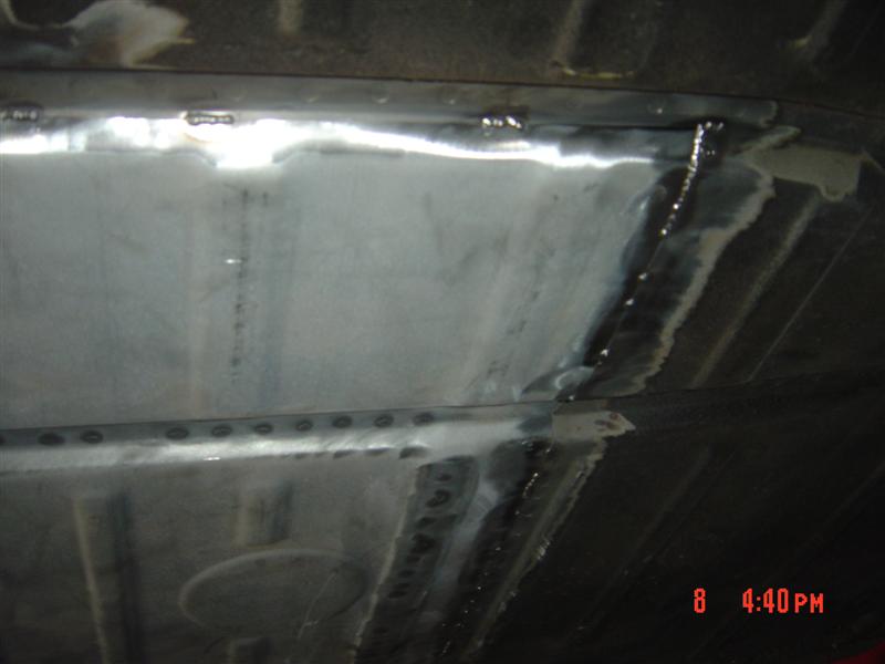

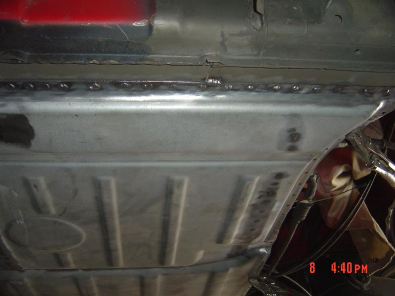

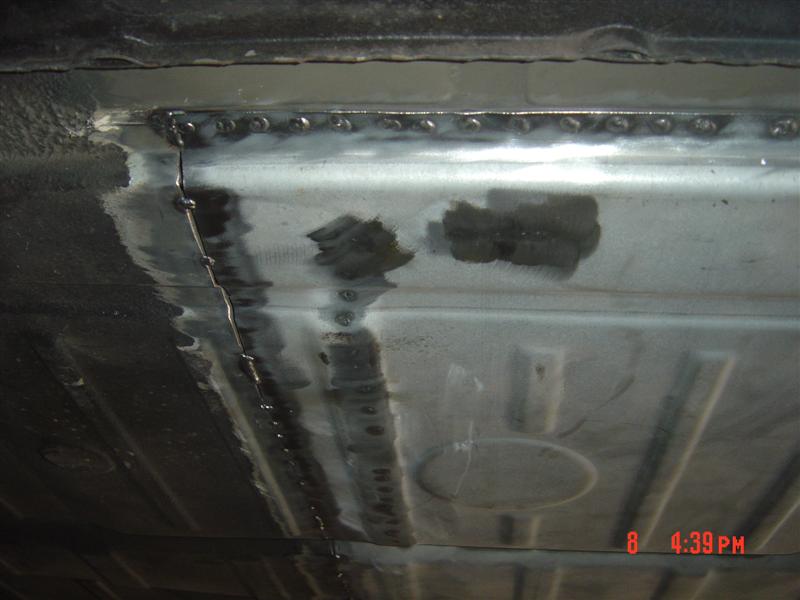

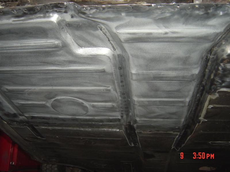

Got the floor pan tacked in after my gas attack this afternoon ( see sandbox thread ) I will finish it up tomorrow and will then head for hell (IMG:style_emoticons/default/unsure.gif)

That tube is there as kind of a pressure release valve so you can close the doors with the windows up and the roof on.
and to rust.

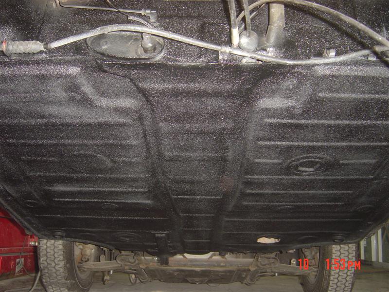

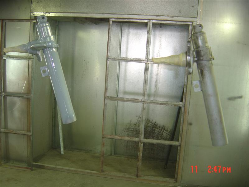

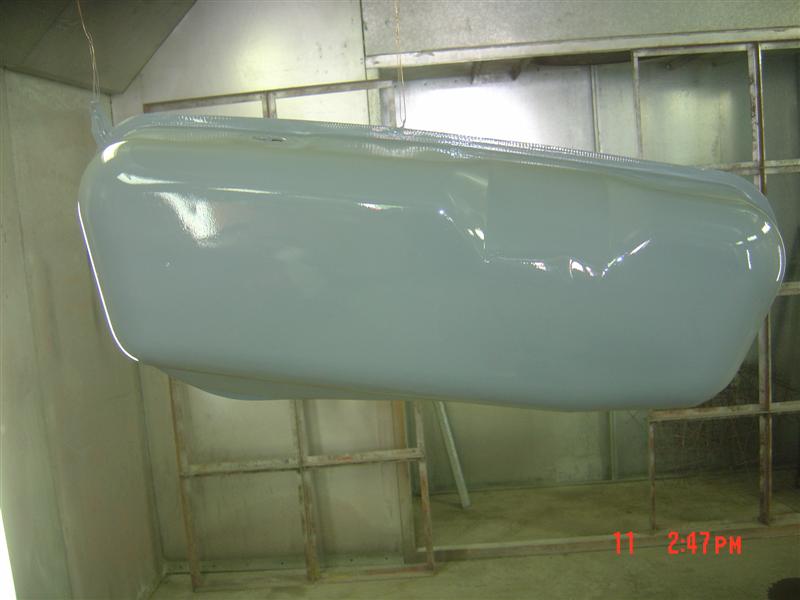

Floor is done (IMG:style_emoticons/default/smile.gif) All welded, grounded, etcheded, sealeded and undercoatededed. Got to a point where I needed to stop until the new stuff arrives, and I also need to make some re-usable and adjustable bracing so I took friday and sanded the gas tank and front struts clean, primed and painted them low gloss black.

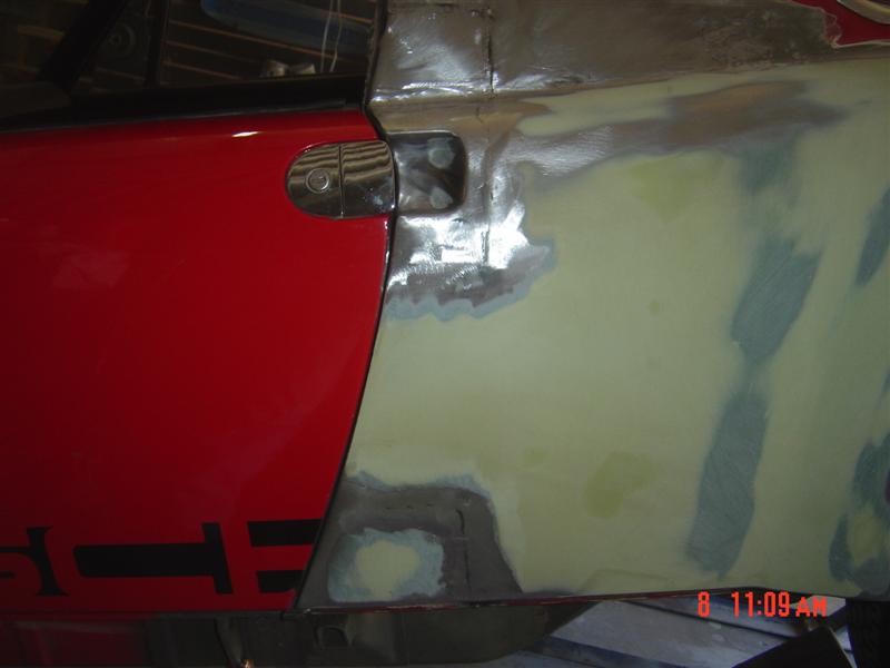

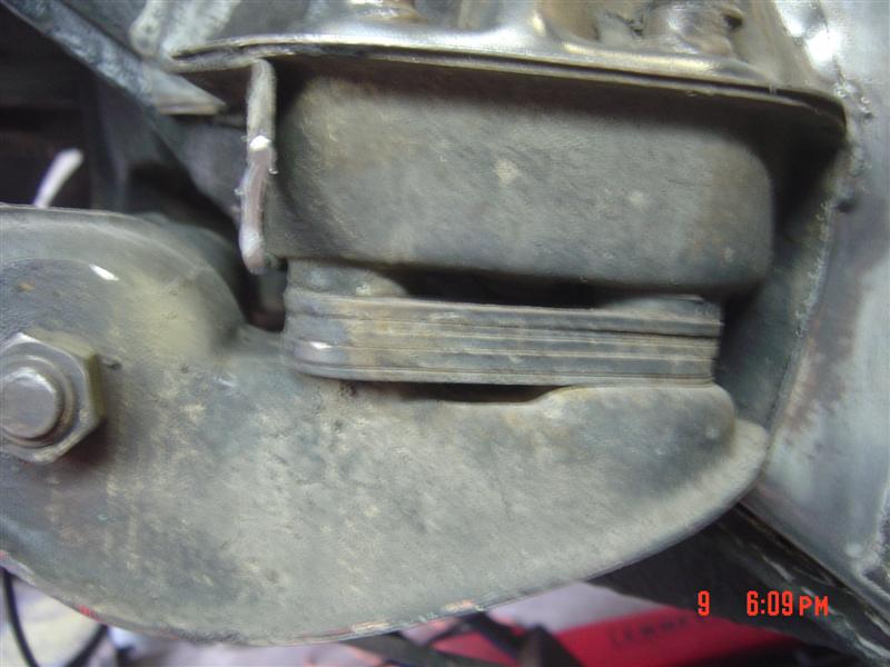

This hurt me to do (IMG:style_emoticons/default/sad.gif) But I had to too see just how bad things are. I'm going to cut the bottom out of the suspension console next time to make certain it is good on the inside.
