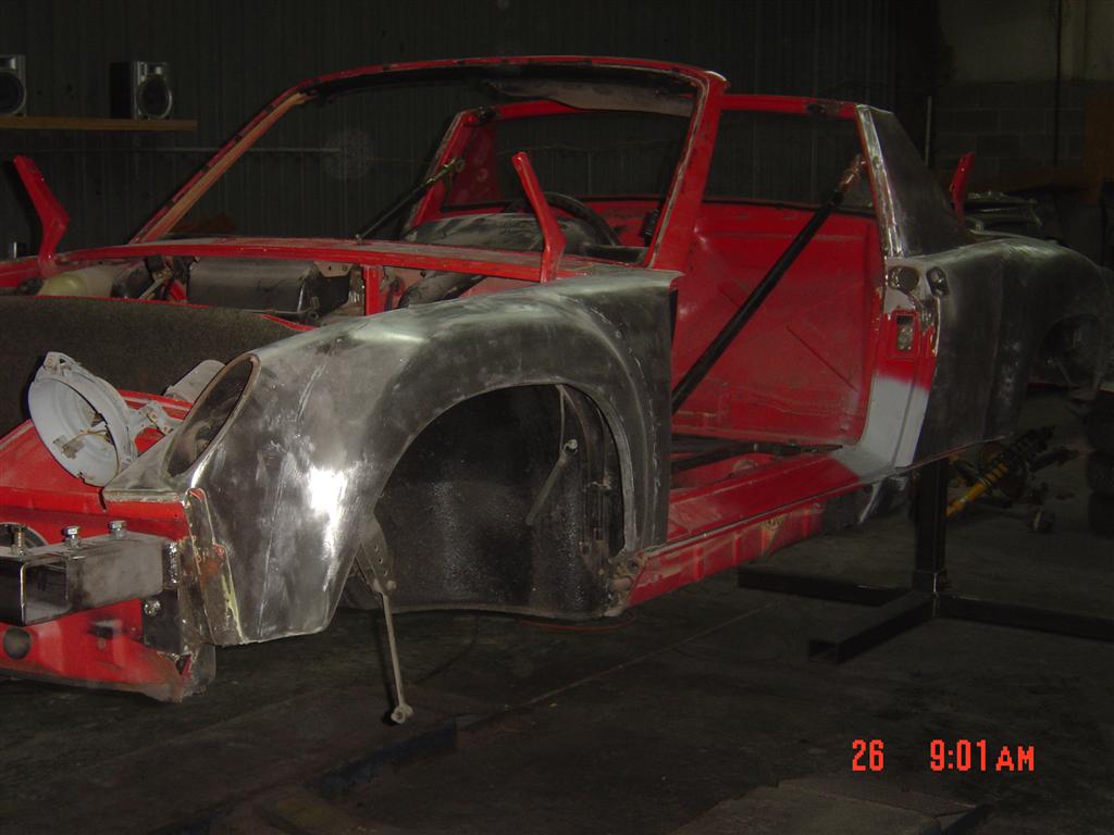

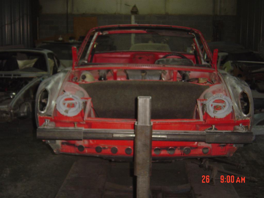

Not tied together. I don't see any need if the other bracing on the car is done properly. I also am not finished with the rotisserie. I still need to add some hydraulic jacks on either end to raise and lower it, add some casters to move it around, and if I feel it need it I will add a tie in. Once the wheels are on I think I will need the tie in. Also going to remake the mounts. These were temporary to get the last job done and to get back on Marks car.

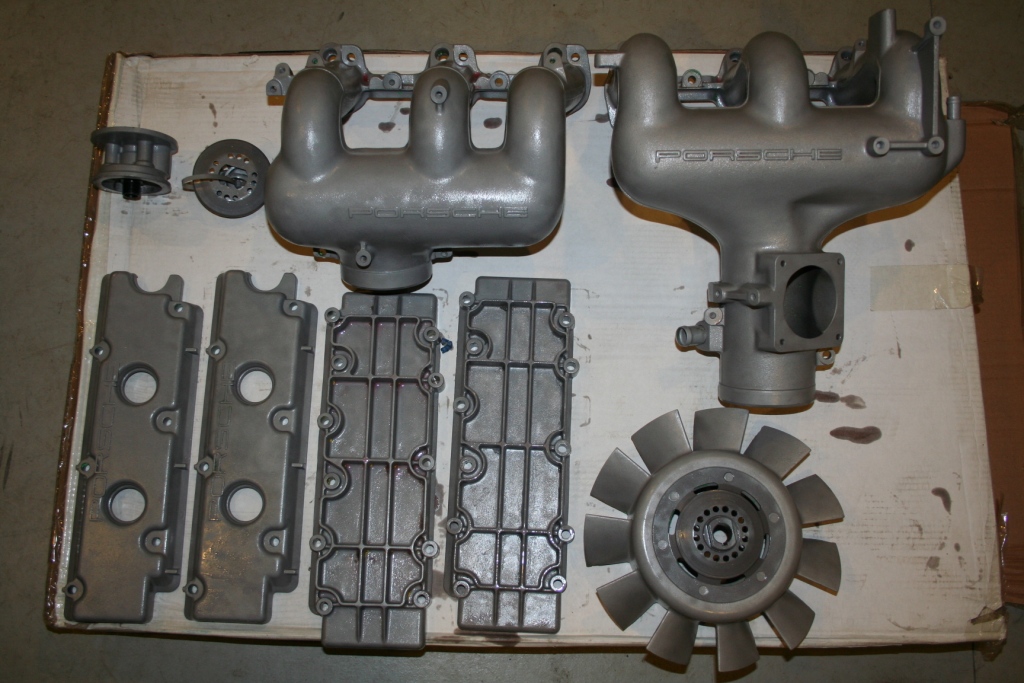

Did a shop day at Scott's. Made some progress on the engine parts.

are these all sand blasted - or is this the finish?

QUOTE(jimkelly @ Mar 31 2011, 08:00 AM) *
Heavy duty paint remover, wire wheel, glass bead blasted and then sprayed with Gibbs to (hopefully) prevent oxidation.
Scott was right - removing powder coat is a bitch!
