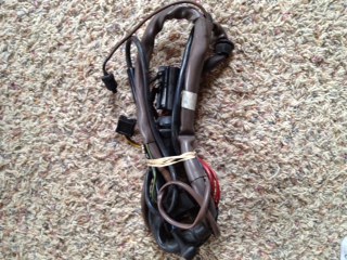

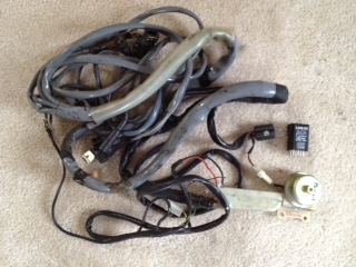

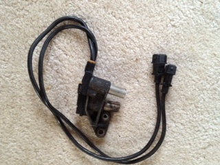

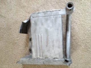

Conversion parts

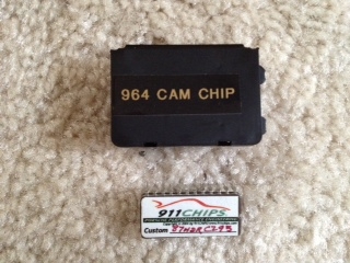

More -

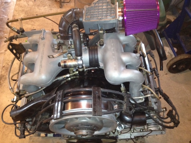

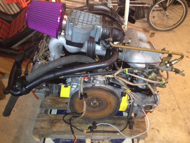

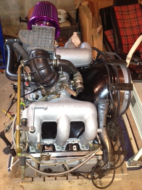

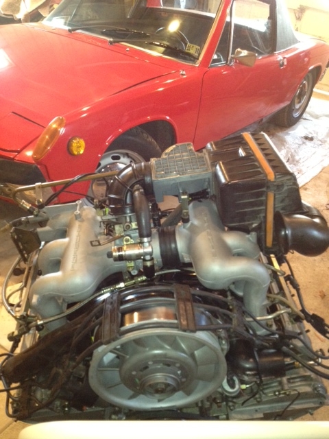

Finally started fuel injection reassembly. Took me a couple tries to get everything where it should be. (I'm no car mechanic). The purple air cleaner came with the engine but will not be staying. I have a stock air cleaner somewhere.

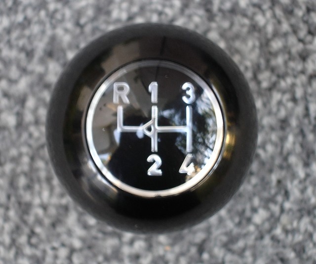

Found this for my Dr Evil modified trans.
How about one of these? (IMG:style_emoticons/default/driving.gif)
I talked to Mikey about making a batch but I'm going to try the wood one for now. Where did you get yours?

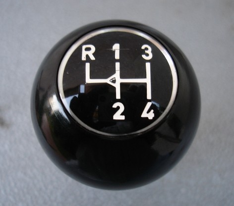

I trolled in the 912 boards a few years ago and was able to get a couple of really nice examples. This one has a small line in it through the "1" but the one installed in my car (fuzzy picture) is perfect.

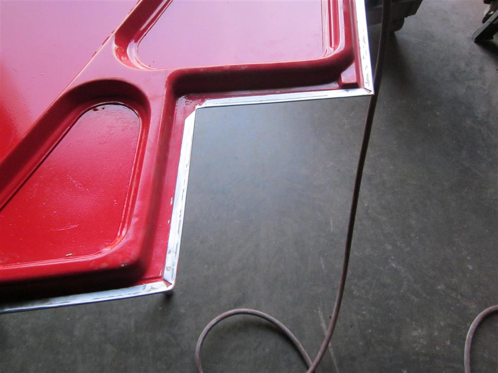

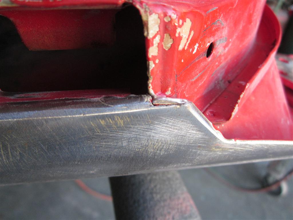

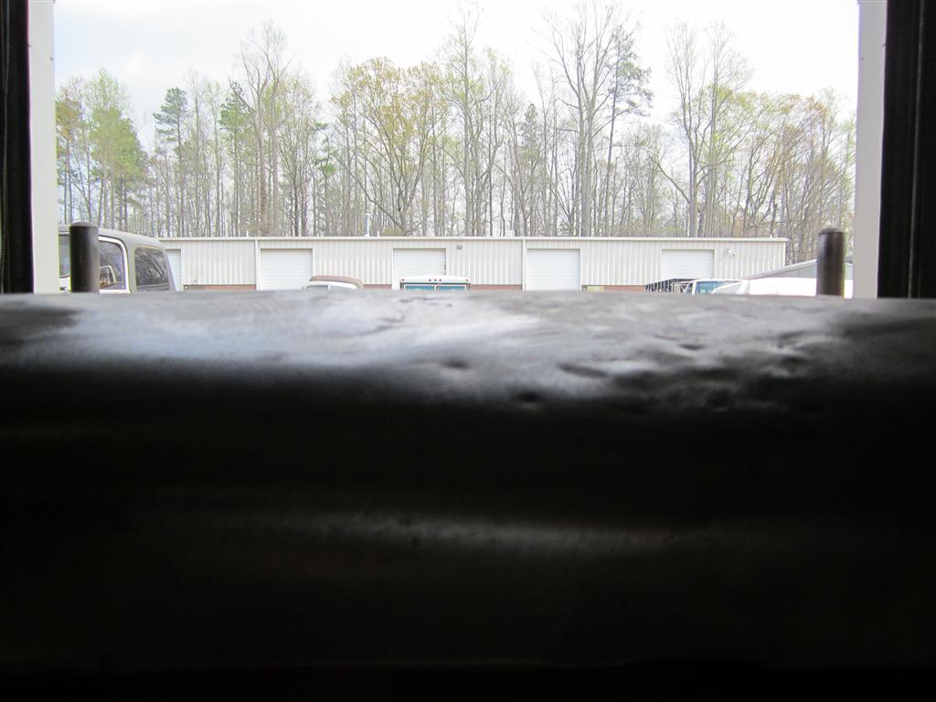

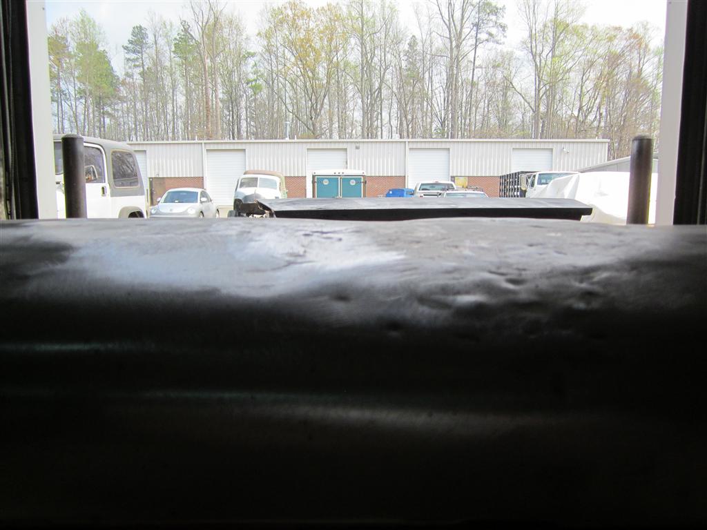

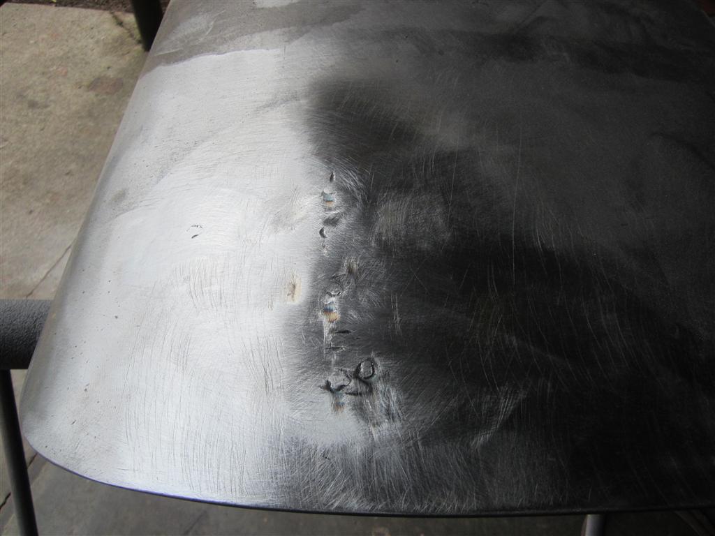

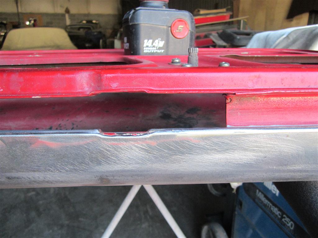

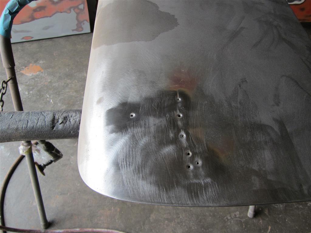

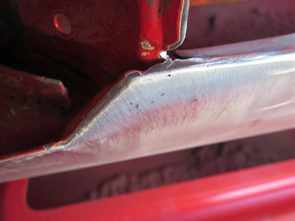

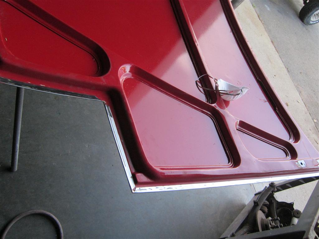

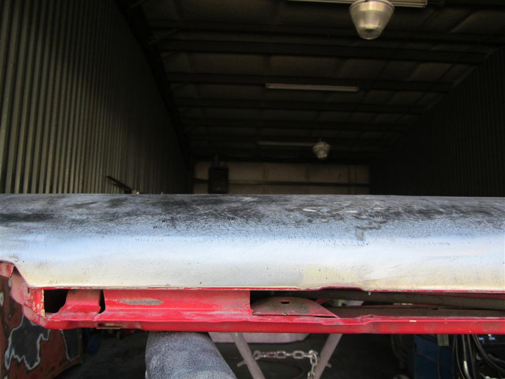

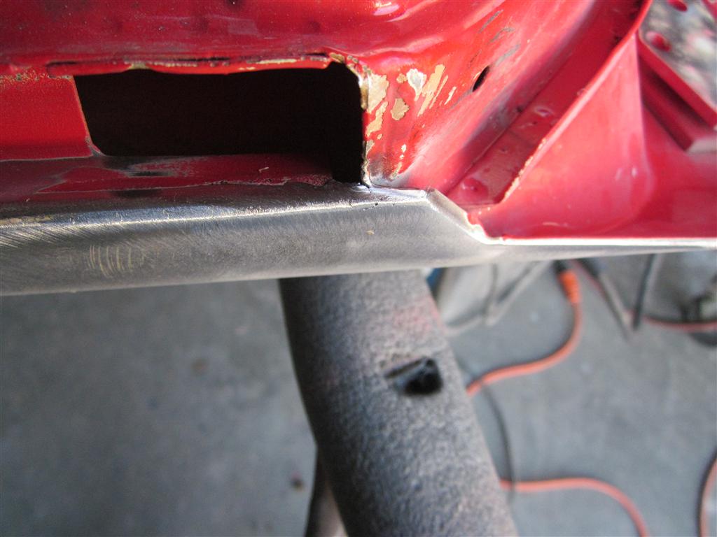

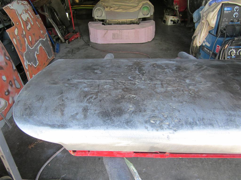

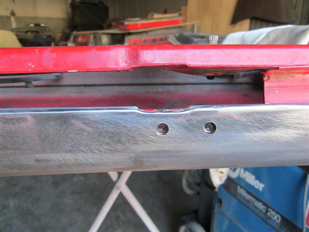

LOTS of metal bumping, and shrinking today. I got the pass door about as close as it's going to get. If I had a bullseye pick I could get it closer, but as it is, it will only need a skim coat of bondo as opposed to the 1/8"+ it had before. Had a few small ripples in the rear trunk lid that didn't show in pics, but I worked them out with the shrinking disc.
Attached Image Attached Image Attached Image Attached Image Attached Image Attached Image Attached Image Attached Image Attached Image Attached Image Attached Image Attached Image Attached Image Attached Image Attached Image

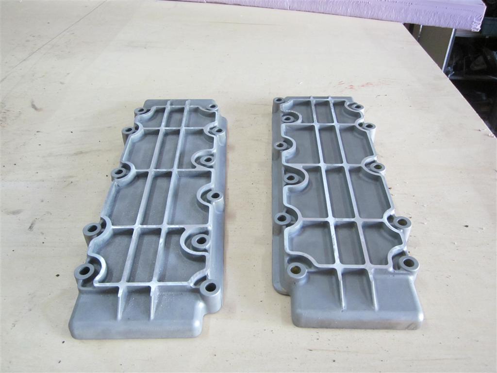

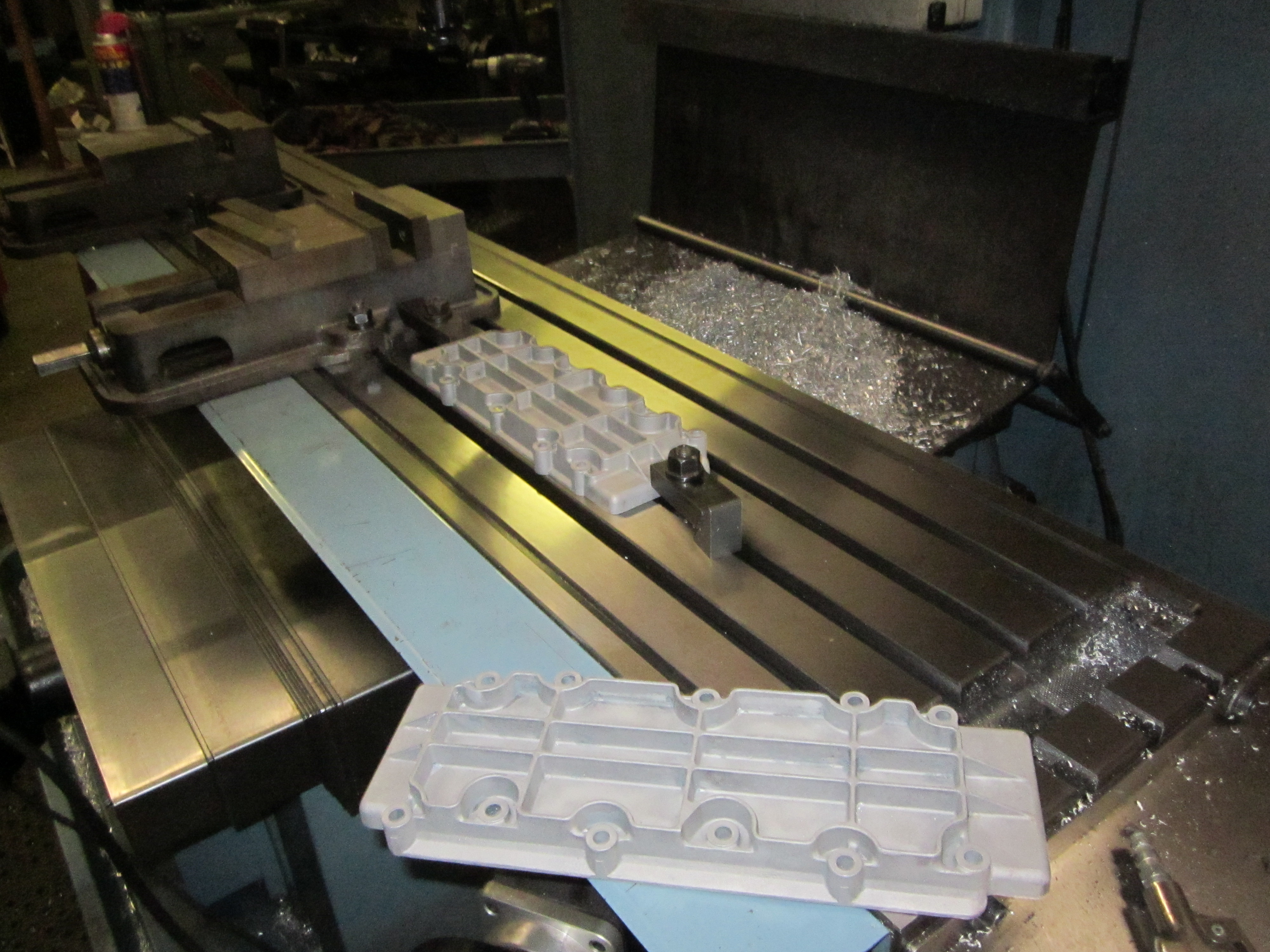

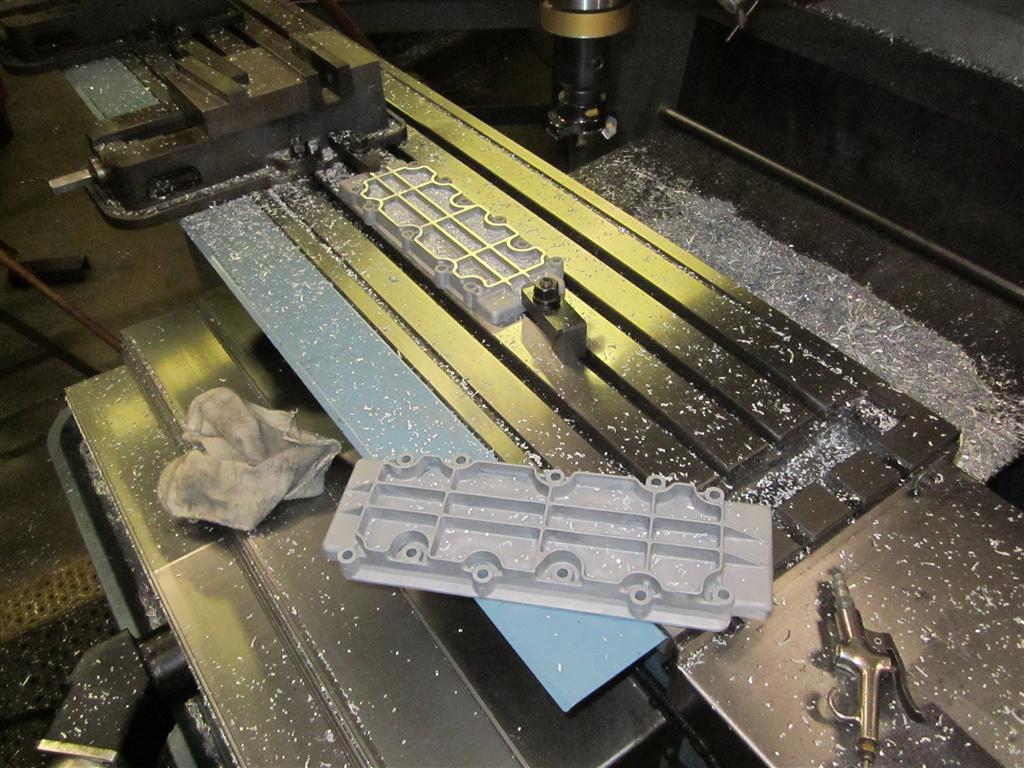

I got Marks valve covers cut down last week and dropped them off at the anodizers. Anodizer called today. I'm not real happy with the blotchy-ness but they claim that is a result of outgassing from oil impregnation. Since it is under the car, I'll leave it up to Mark as to whether or not he wants me to have them redone (IMG:style_emoticons/default/confused24.gif)
