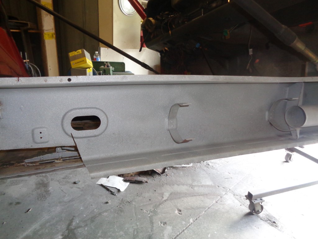

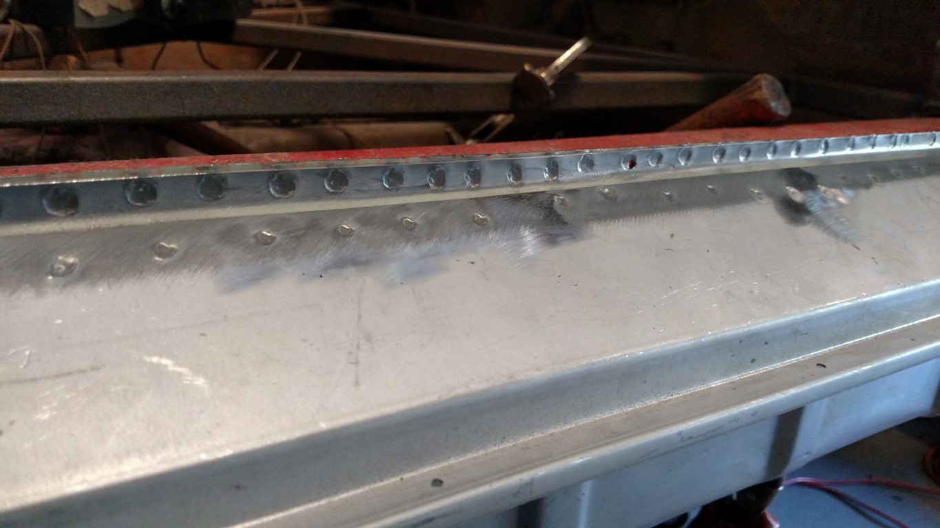

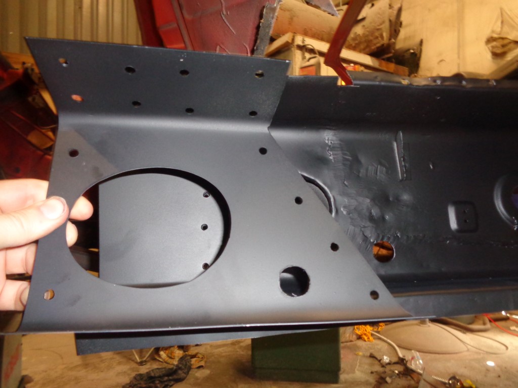

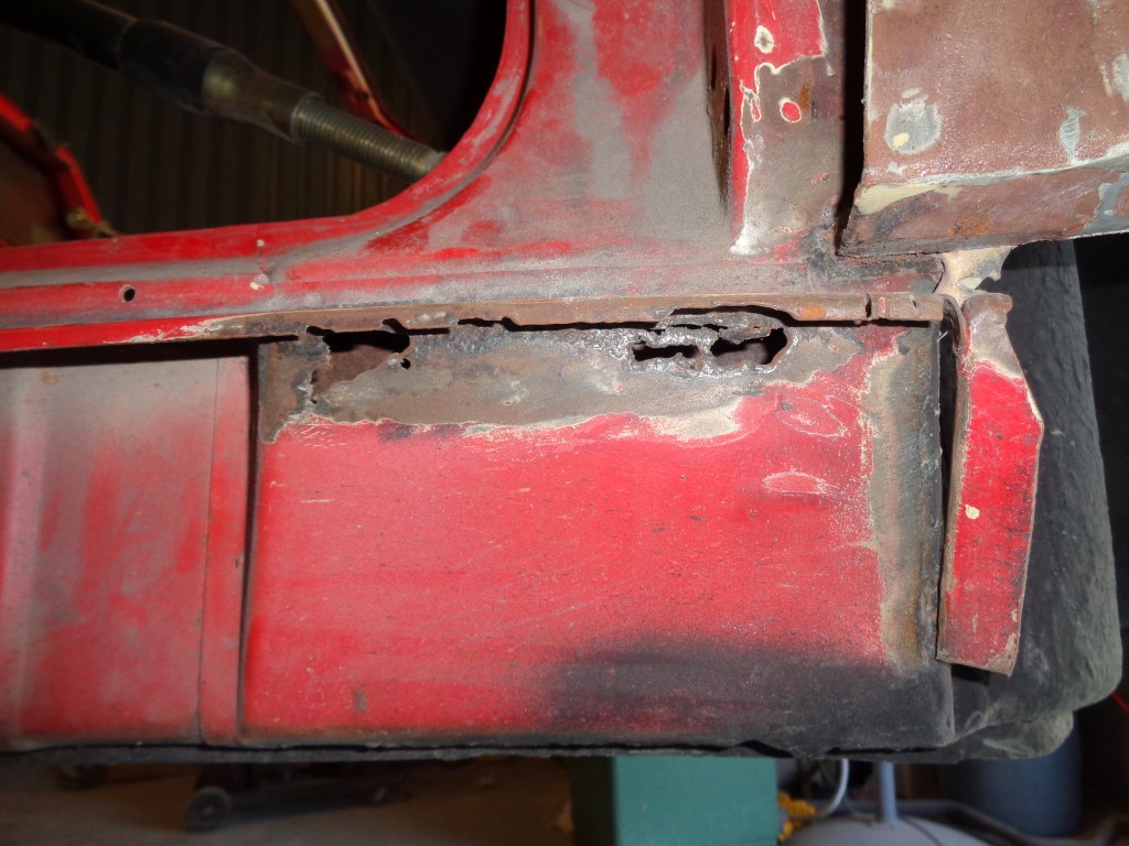

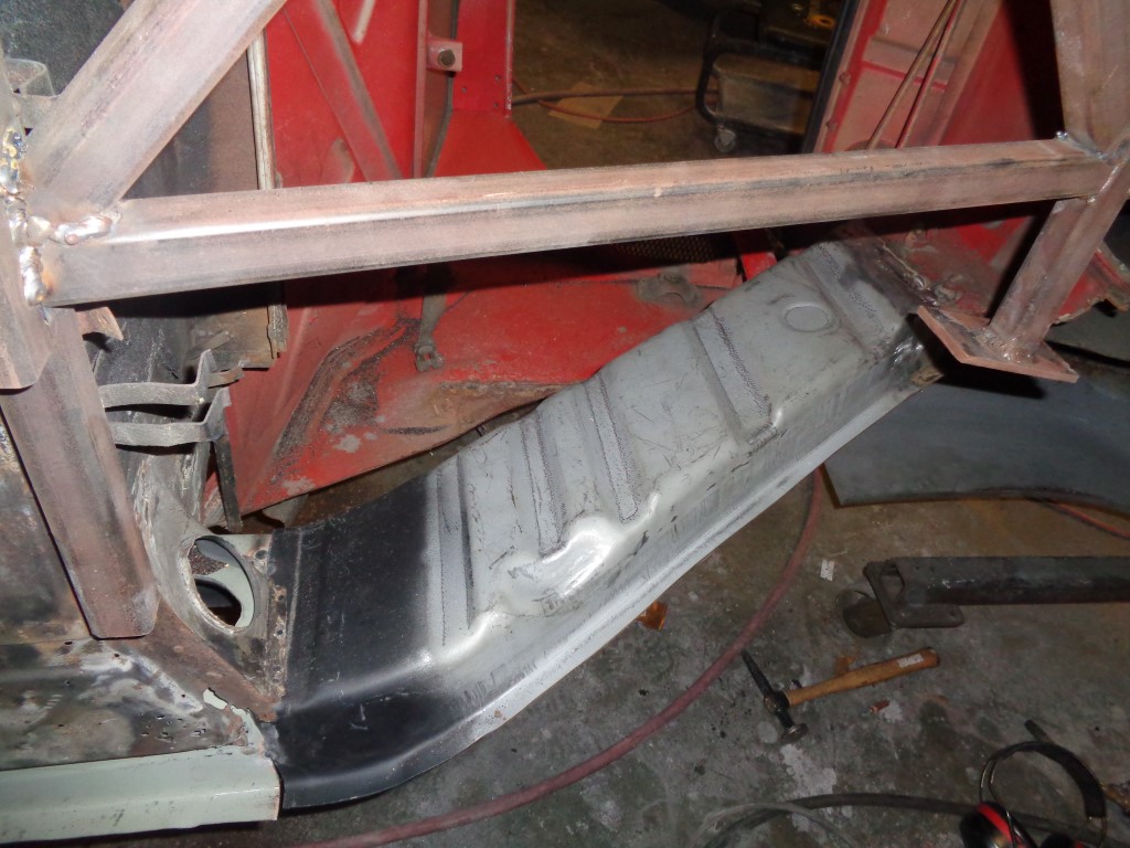

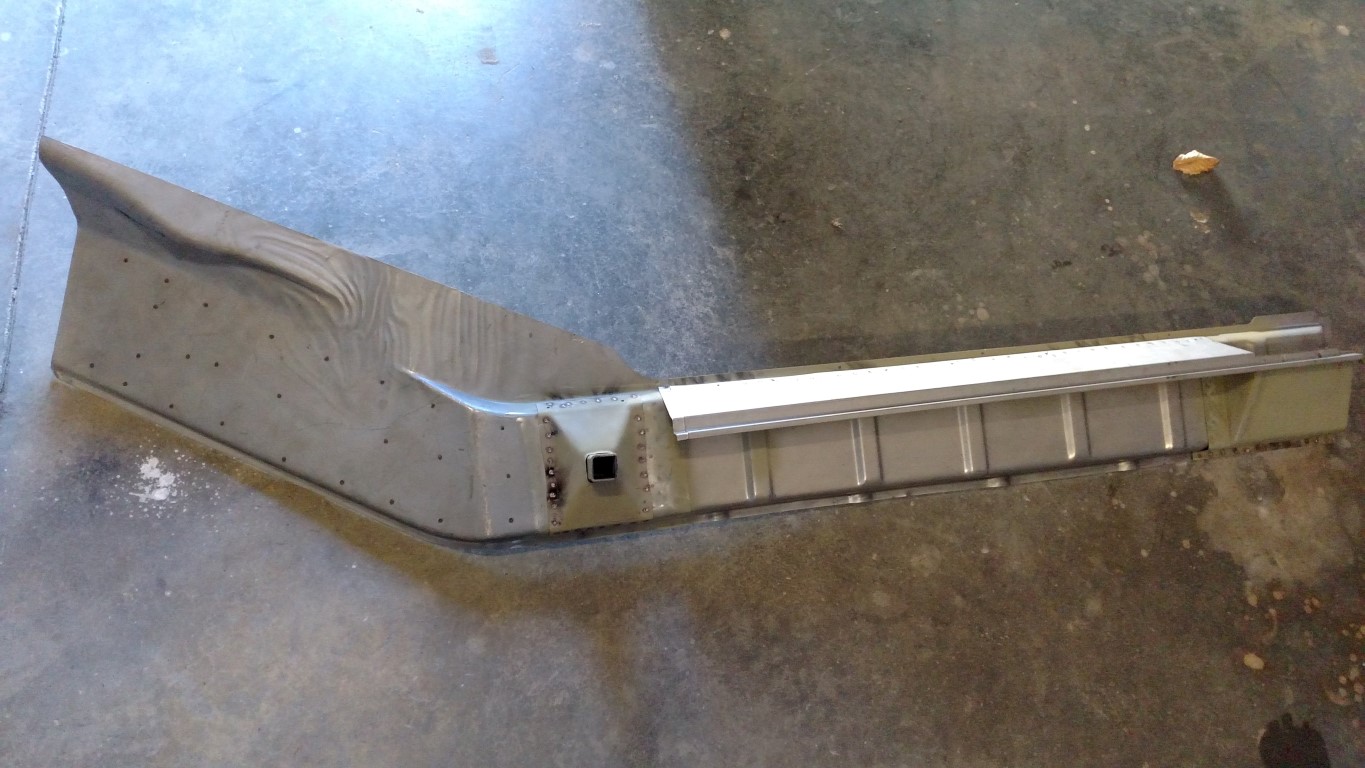

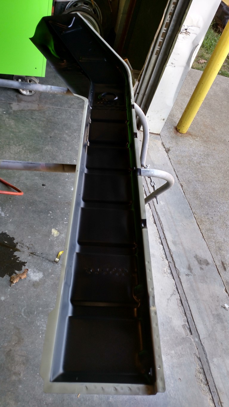

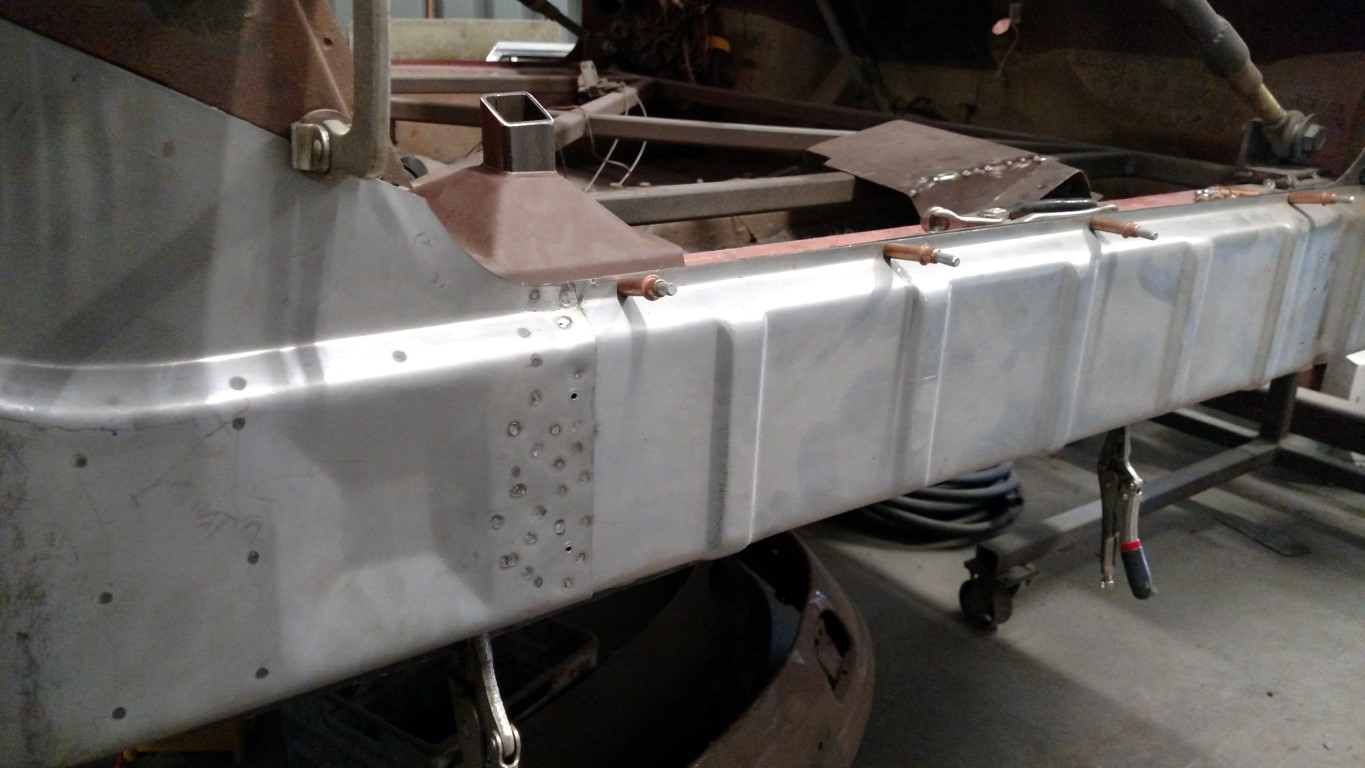

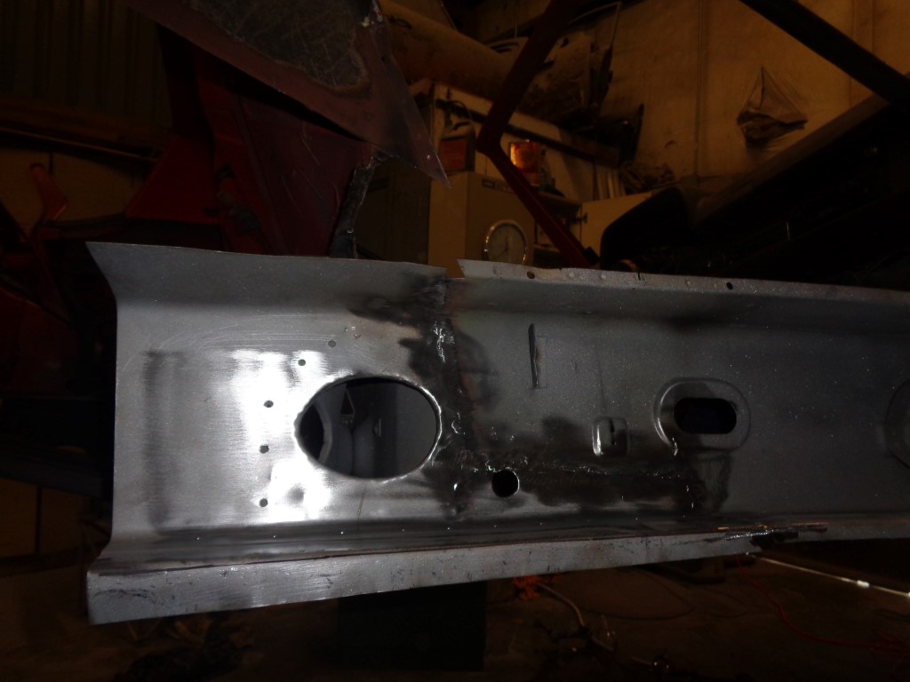

Chasing the rust again (IMG:style_emoticons/default/dry.gif) New batch of panels ordered from RD should be in next week. I have a new toy to play with (IMG:style_emoticons/default/shades.gif) (IMG:style_emoticons/default/welder.gif)

Wow - Very nice. (IMG:style_emoticons/default/grouphug.gif)

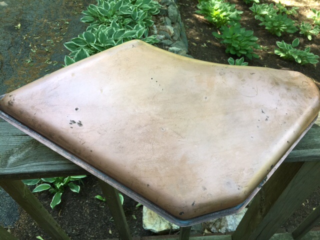

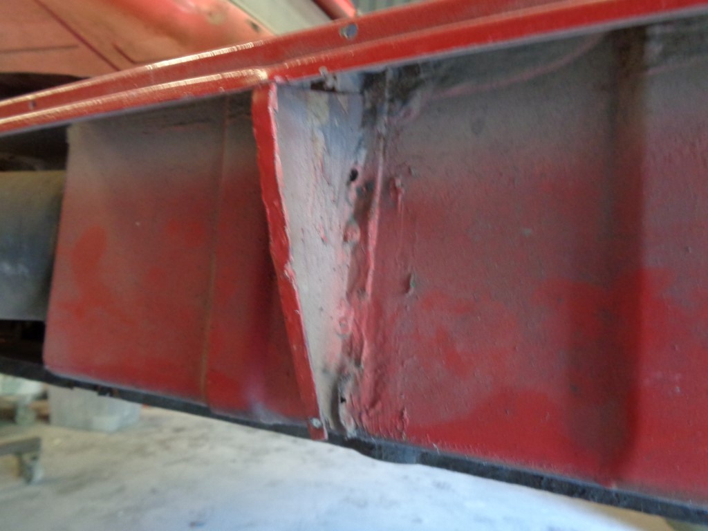

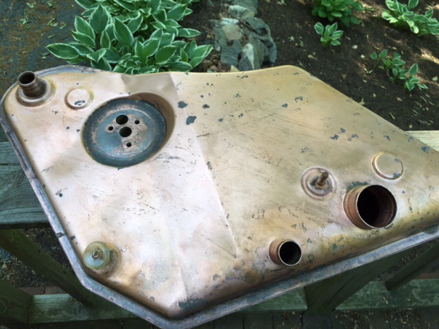

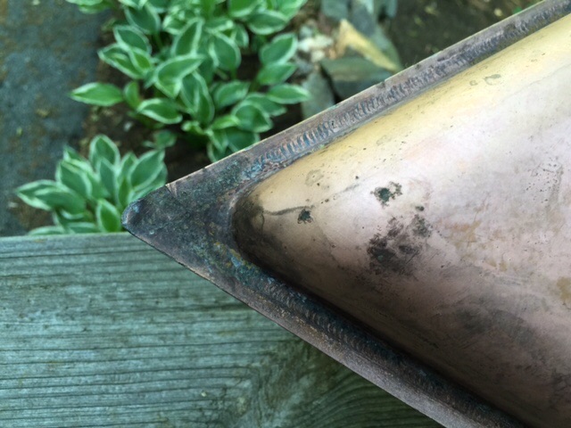

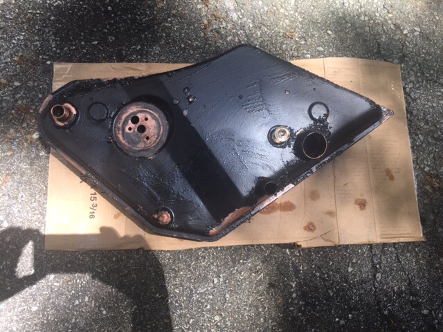

I have an original 914-6 oil tank but the paint was a bit beat up. So after stripping the paint, there are spots of corrosion through the copper plating. So now do I;
Treat the corrosion and powdercoat
Treat the corrosion and epoxy paint
Remove copper and start from scratch - probably $$$
Attached Image Attached Image Attached Image Attached Image Attached Image Attached Image
scotty b
post May 24 2015, 09:29 PM
Post #386
rust free you say ?
Posts: 16,375
Joined: 7-January 05
From: richmond, Va.
Member No.: 3,419
sandblast and epoxy paint. It will be rust free and have much better protection than original. Best bet is to send it to Pacific oil cooler. They'll sonic clean, pressure test, repair i f necessary and paint,roughly 300.00 depending on repairs

What was the purpose of the original copper plating? I am in the same boat with mine and trying to figure out what to do with it.

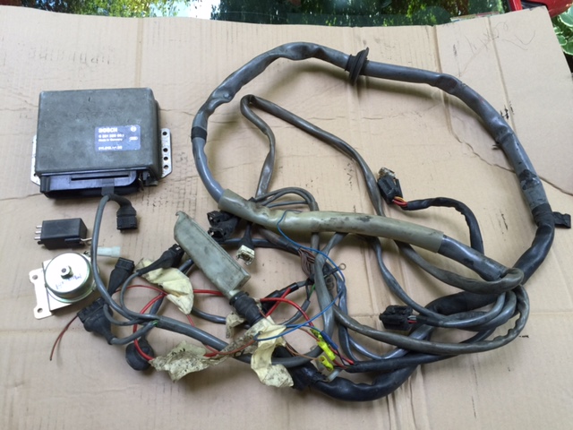

Needed a brain. Got one along with a 3rd ? harness. Harness will be for sale.

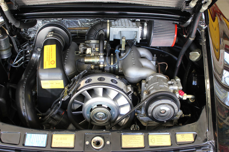

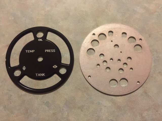

Yummy

(IMG:style_emoticons/default/agree.gif) Nice triple gauge

I'm hoping you will build it for me. (IMG:style_emoticons/default/pray.gif)

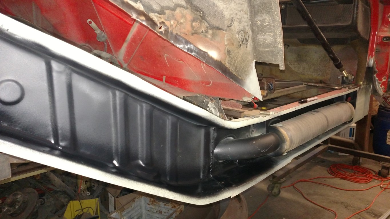

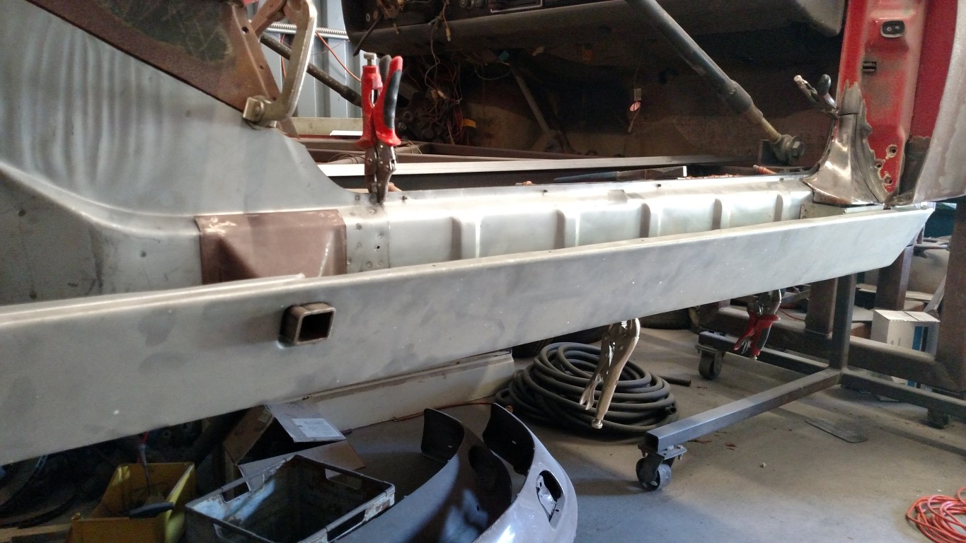

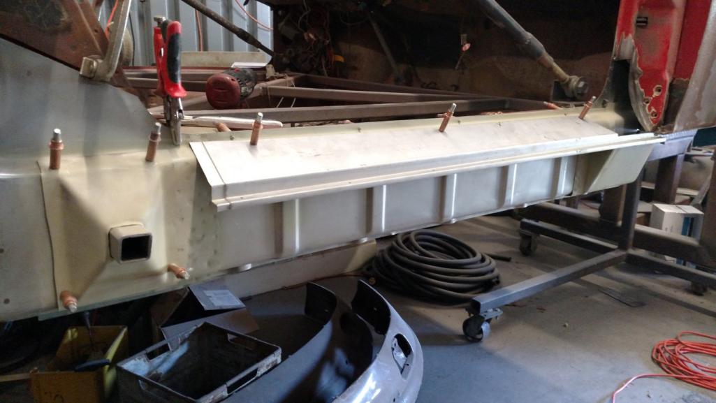

an hour here....an hour there....and things start to happen again (IMG:style_emoticons/default/unsure.gif)

Yea! (IMG:style_emoticons/default/welder.gif)

The metal work is looking awesome. (IMG:style_emoticons/default/pray.gif)

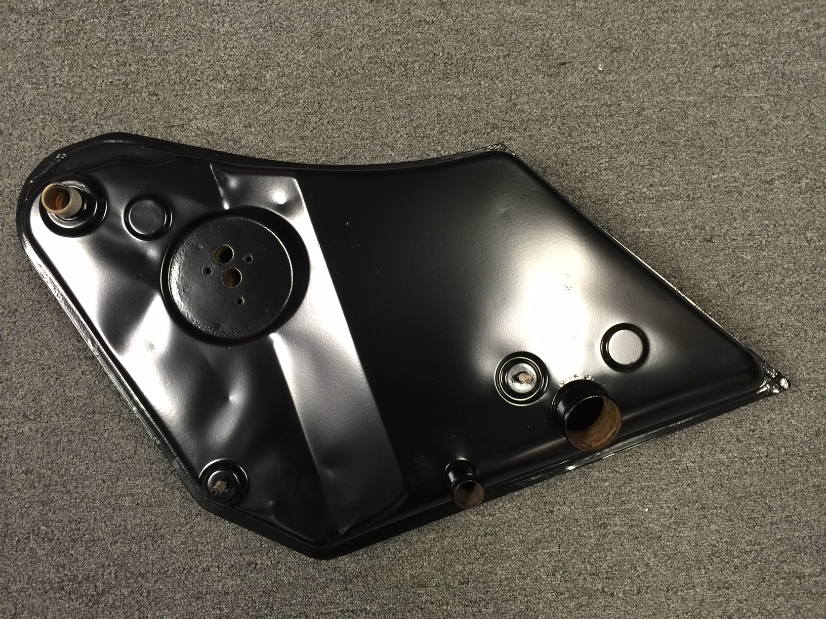

Had a batch of parts powder coated. Threw this in.
